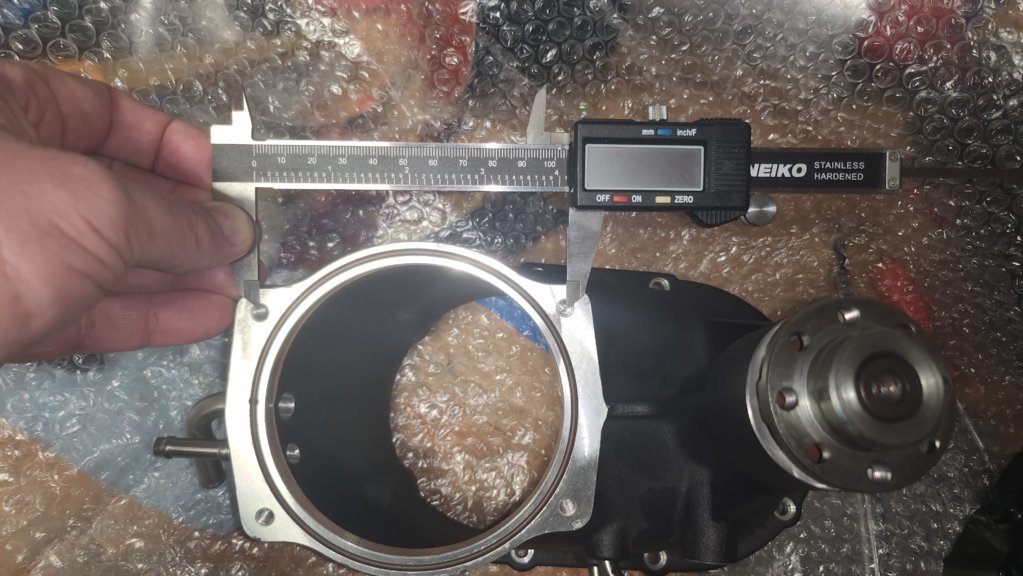

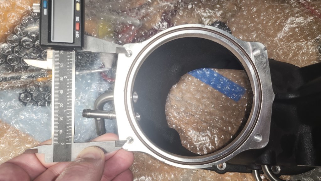

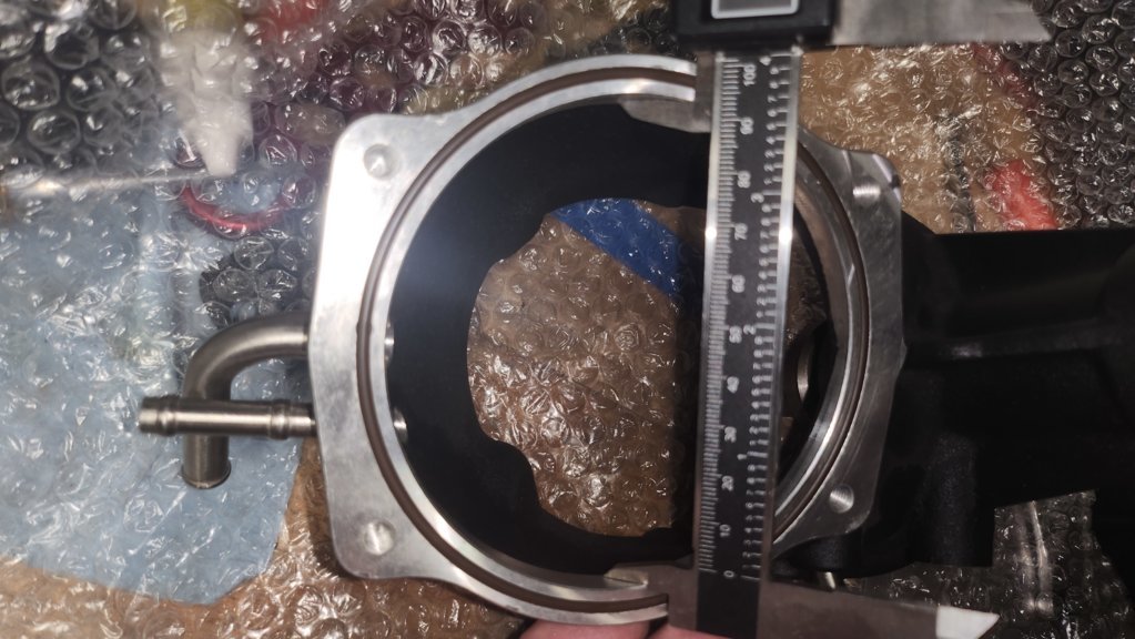

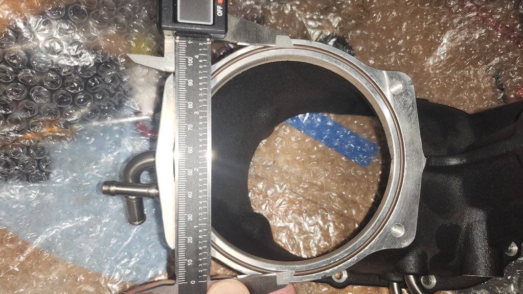

    The existing snout opening is 102mm, 107mm to the o-ring, so maybe a 105mm TB opening with a 108mm outer so that a 4.25" silicone coupler will fit it? Is that a thick enough wall?
    I need a new battery, but here are the bolt hole and opening measurements:

    Scratch that, it's 107mm to the o-ring. But I think a 105mm opening should still work?

    Yea I think size it so a coupler fits nicely. Maybe make it curve down from a larger diameter to the 102mm snout opening so it sits flush at the blower.

    I'm not opposed to porting the snout, I was planning to do that for the 103mm NW TB.

    I ported my 1900 snout out to 94.4mm. The o ring option would work in conjuction with a gasket or a little fipg.

    In that case I think we just push the bore as large as possible then and you can port match the snout to it.
    Sounds right. The snout can get opened up a bit more than the TB bore since obviously the thread OD is quite a bit smaller than the bolt head diameter. I think these are like 94.1mm

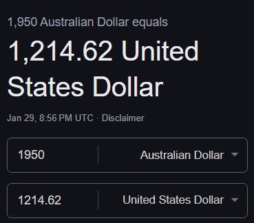

    Cruisers is USD and Aussies are AUD. Do a google convert $.

    You’re onto something there. I was thinking this initially after seeing the prices but had not checked on the price again when converted via PayPal. The exchange rate is about 1AUD = .597 USD. The kicker here may be the shipping cost back and forth which I also did not check.

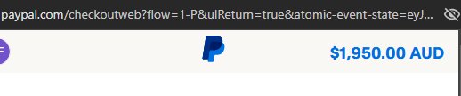

    Just checked, when you pay through PayPal it converts it to USD and the total with the core charge is 1407.20 but nowhere did I see shipping to and from Australia quoted.
    The core charge is also 850 AUD for international orders.
