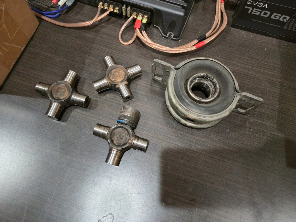

    Alright finally have my damn truck back. Good news is the Motive gear and pinion gear, LSD were found to be in good condition and not the cause of my loud ass whine/rumble. The Carrier bearing and U joints on the other hand were shot. Now i can finally get some damn miles on the gears and lsd:facepalm:

    Looks like those U joints didn’t have the grease zerks? And did your carrier bearing have excessive play?

    i dont think stock u joints have the zerks, mine dont and its an 18

    My 07 has them and still going. I did replace the center when I had the drive shaft shortened for awd.

    They were phased out in 17-18 trucks.

    No zerks, some of the bearings were burnt and Carrier bearing had play.

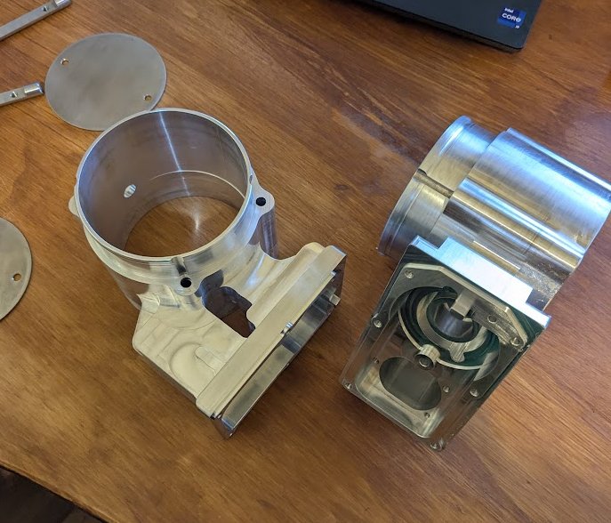

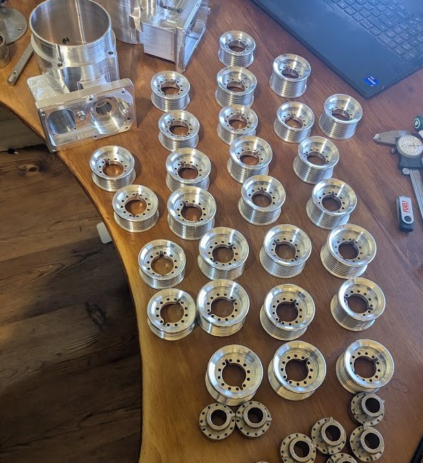

    Machine shop parts showed up today!
    I don't know if I'll have time to build one of these out before I leave next week for King of the Hammers, but I might not be able to resist!

    Those TB’s sure do look badass

    I had a guy email me this morning who has a Whipple and was asking about them. I think we'll end up doing an order of like 3x Whipple specific throttle bodies that are really big bore and eliminate the spacers.

    Doesn't the Whipple use the same bolt pattern as the GM TB, or is it different? If it's the same, I'm interested for my snout swap...getting closer to making that happen.

    As I recall it's different, that's why Rey has to run a spacer even though he's running a LS3 style TB. The whipple pattern doesn't seem to match anything for the best I can tell.
    Could always do a one off for you too.

    One-off sounds good, the D2A adapter has been working well for me, but would prefer stock electronics. How big were you going with these?

    These ones are a bit over 94mm. The Whipple as I recall could get pushed to like 101mm.

    Can you make it 103mm on mine?

    Same no issues with the adapter here but I do notice that unit does get crazy hot. I'd much rather have stock electronics and @snivilous pops and I would buy 2 to have one as backup in the rigs for our remote runs. Whipple is 102mm inlet

    I can do anything you want :D
    If you can tell me the bolt pattern and bolt size I can see what the largest diameter without playing games is. That's what set the bore for these ones, I took the Tundra bolt pattern, drew a circle for the bolt heads, added like .030" of wall material, and that's where the bore came out to be.
