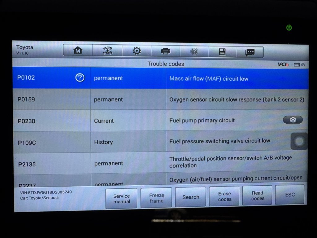

    bflooks

    #46273
    2,302

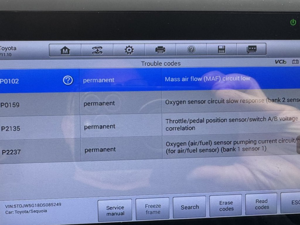

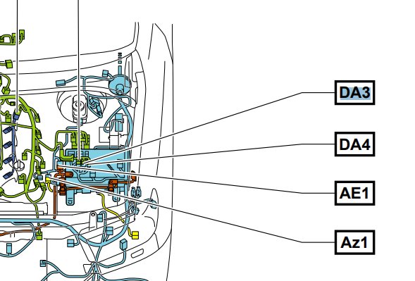

    Leave it, unless you really like that AAA tow truck and driver
  3. Jan 27, 2025 at 2:05 PM
    e30cabrio

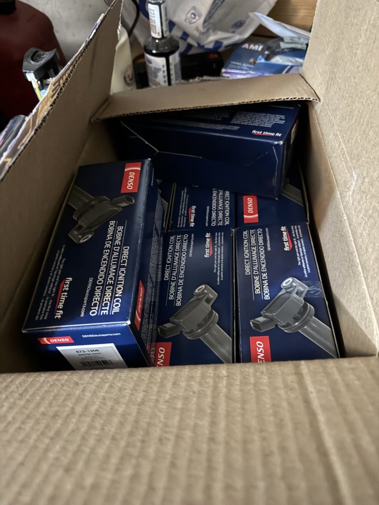

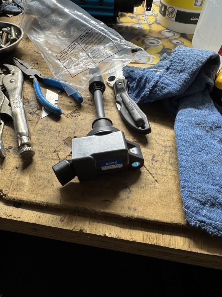

    Oct 20, 2017

    Different drivers, I liked the first one better. New guy wasn't as nice.

    Got it back, running poorly, has codes, sent Sniv a log.

    Didn't remember I never installed the new coils.
    Just swapped cyl 1 out seems like less misfire, I'll send Sniv a log.
