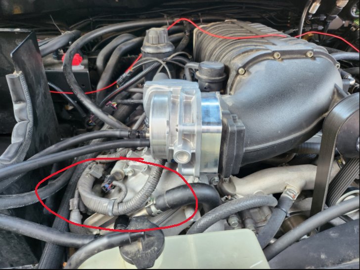

    If you wiggle the wiring harness on the passenger valve cover does it make a difference? The TB and MAF wiring all runs through that bundle...might be worth checking continuity/resistance on those wires.

    Jiggled while running, no change, apparently it is dumping fuel & thinks it is floored plumes of unburnt gas smoke are poring from the exhaust. :(

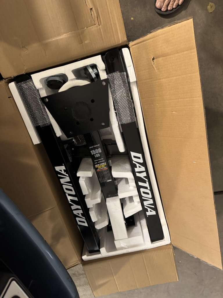

    New stand came.
    Much nicer packaging and an actual assembly manual.
