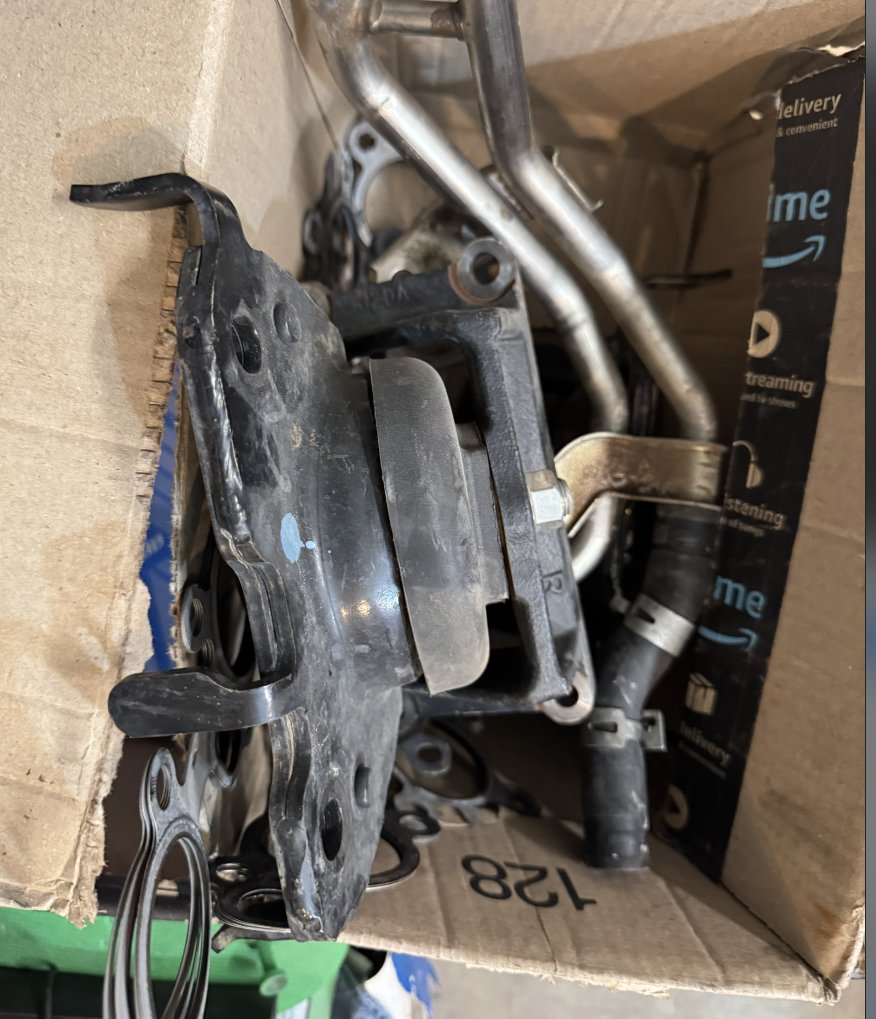

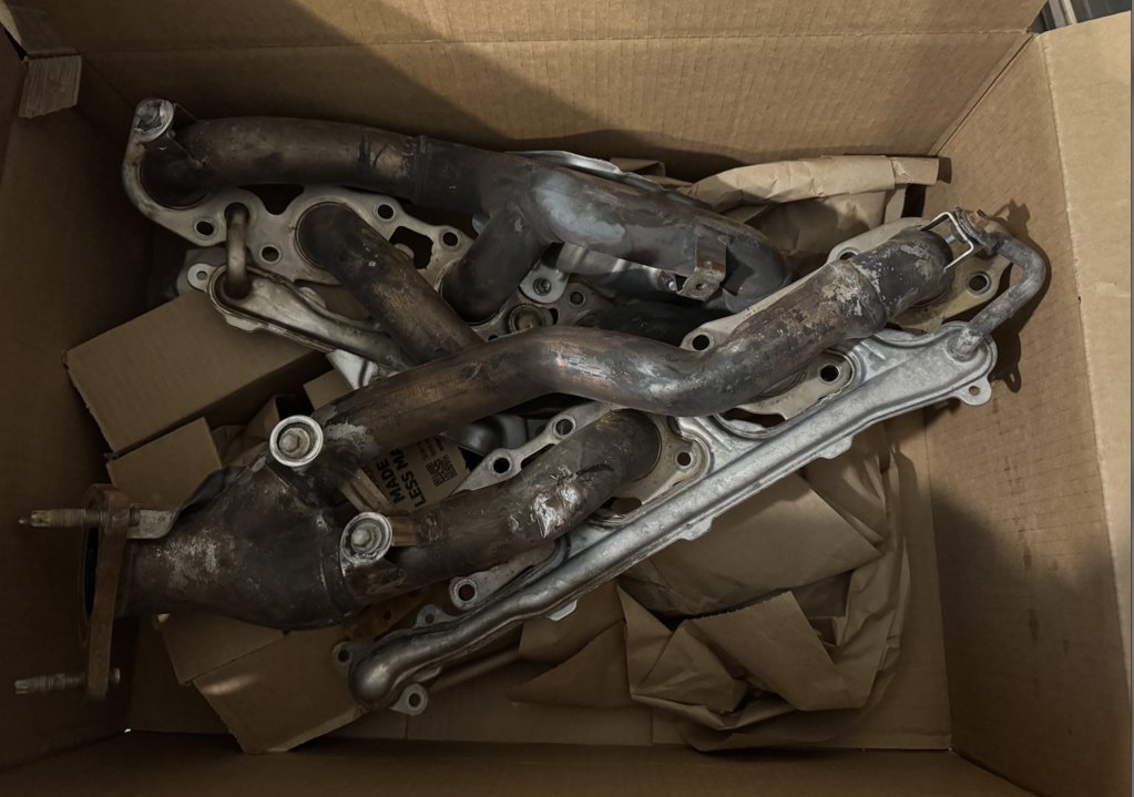

    I see why people say shorties are a waste, it basically has them stock.

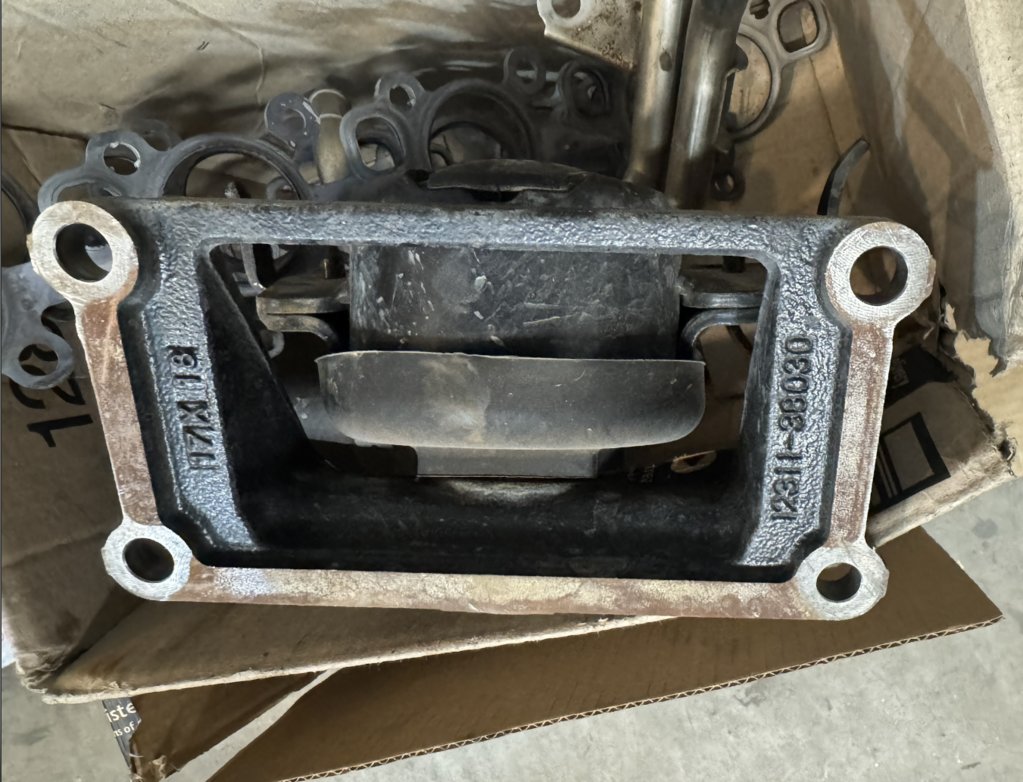

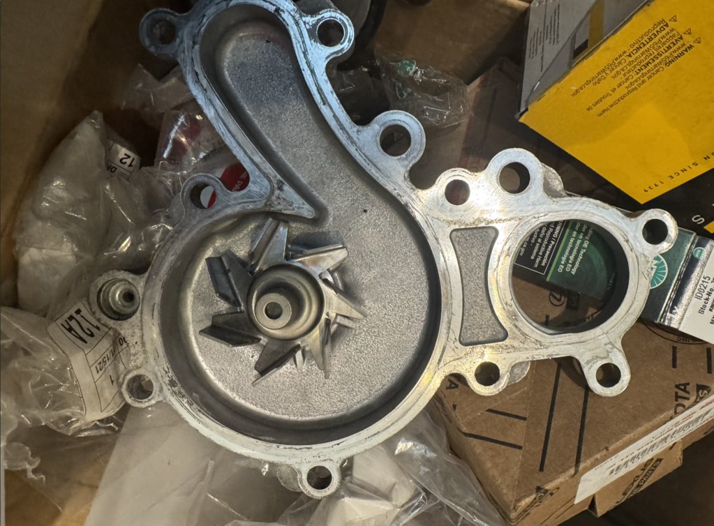

    70k waterpump & motor mounts look practically new.

  3. Jan 26, 2025 at 7:10 AM

    @e30cabrio did you bypass the trans warming puck? Extra coolant hardline from donor engine? Shorties are basically like the stock manifolds.

    I believe I removed the puck, but it's been 3 years or so, if not, I am sure I bypassed it, living on the surface of the sun I don't need any heat.
    I added the full OEM transcooler, I have the hardlines but they came separately so I installed it with rubber hose planning on swapping the hardlines in but never did.
    I have the thermostat pinned. they did reinstall the TB warmer which irritated me, as it wasn't running that was pretty far down my priority list :p

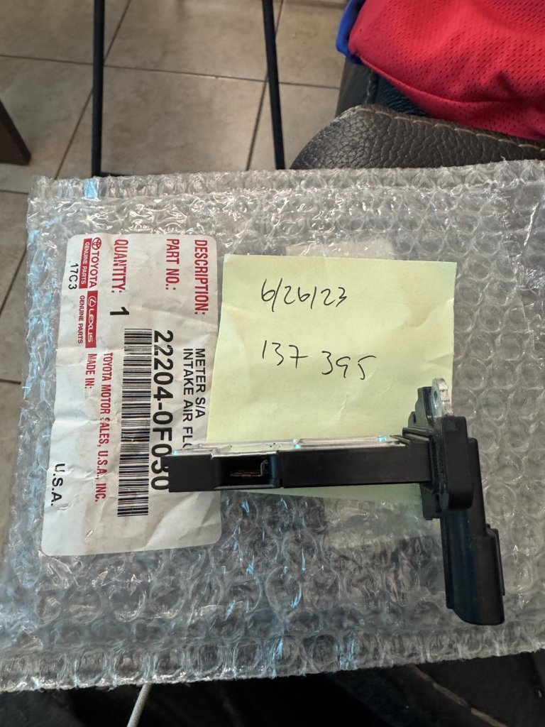

    Anyone know if the MAF is my issue, although it's tuned for the Turbokits MAF if I can run on the OEM?
    I have a sub 6k the TK replaced.

    They scale differently, so the tune is MAF-specific. If your tune is setup for TK's MAF and you have a stock MAF installed, that could be causing your MAF-related CEL.

    I have the TK installed currently & have the code/not really running issue, I ordered a new TK that they are kindly overnighting tomorrow but that's not helping until Tuesday. I am wondering if I can limp on the OEM until Tuesday.
    The truck is at the shop so I'm not interested in going there installing the OEM only to find it was pointless.

    I wouldn't. You could have over 20 swing in your fuel trims.

    Sniv is awesome! He sent me an OEM MAF tune.
    The shop is working on the truck, they are installing the Ruthenium plugs & Lexus coils, they think the RCF TB is the issue which is odd seeing as there are no more codes for the TB & it was fine before. They said the OEM plugs they installed were drowning in gas. No idea why.

    Seems more like a maf issue than TB.
    Cool @snivilous hooked you up!

    Unplug the MAF, it'll run like crap, but will go into a default NON MAF mode. I wouldn't be boosting or driving a long time like that, but you can always unhook a MAF if a MAF code leaves you stranded. The Tundra ECU can pull +/- 40% LTFT and then another 20% STFT, so it won't take long for the ECU to take up the slack.

    Yes, 100% you can just move the MAF voltage points from a stock MAF MAP into your current MAP and install the stock MAF. That's another way...
