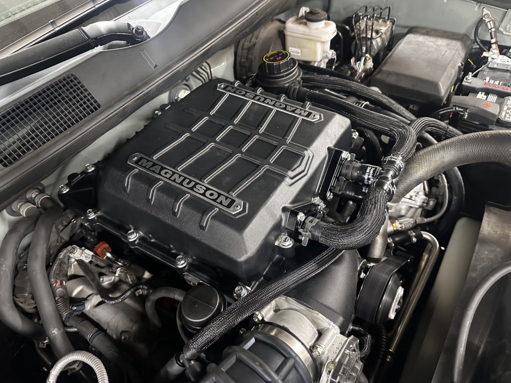

    Picked up my truck today. 30 mile drive home and few opportunities to get on it a little bit. I'm pretty happy, but not overwhelmed... Time will tell

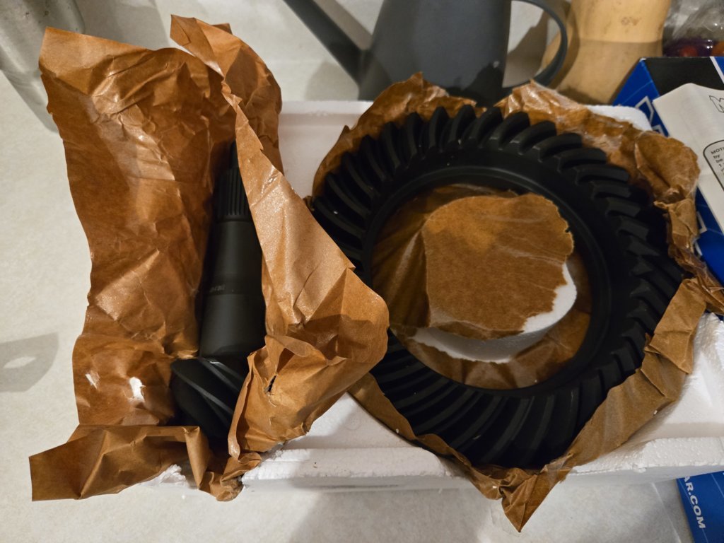

    I had my rear gear REM'd for round 2. Make sure the pattern is right on. A tad deep and you'll get a deceleration/coast whine. I thought both patterns were great. But after dealing with 57-60mph whine on the rear. I went a few thousandths more shallow on the front an it was good to go.
