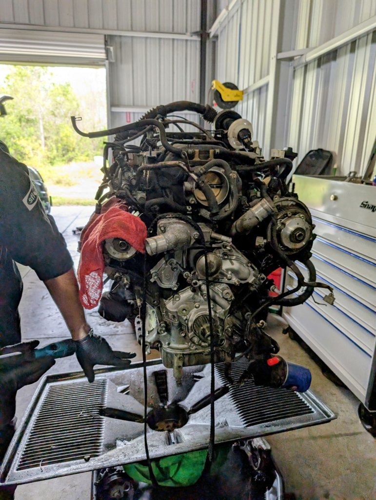

    It will be there a month tomorrow, but the body work is done & the motor is finally out.

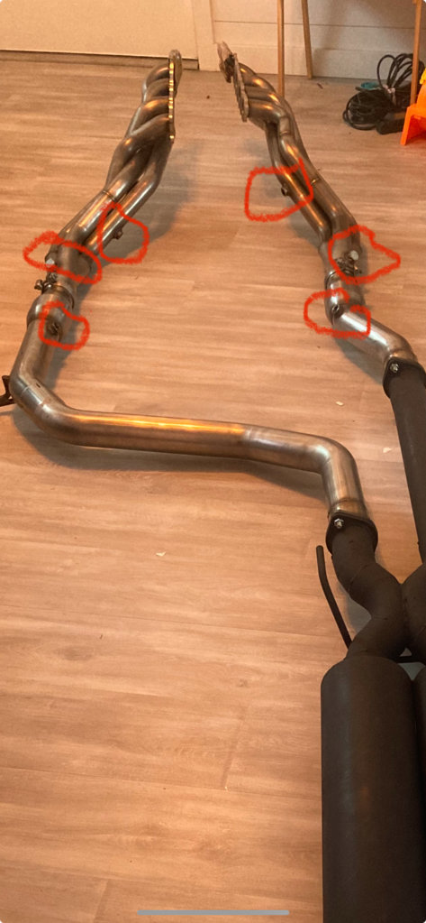

    My AFR oscillates when idling in Park, running ARH long tubes, not sure of a fix but also not sure it's a problem other than an irritant...maybe fouling the plugs? Like I mentioned before, I had LTH before the supercharger and didn't experience this, it started acting this way after tuning for injectors with the SC installation.

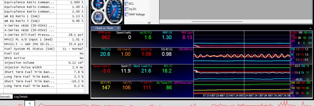

    I found one of the logs showing the AFR swings, only happens when in Park, Idling, under 160*, my sensors are in the collectors pointed at the collector...which is not ideal from what I've seen. Fuel pressure is boost-referenced at 43.5PSI base (MPVI2.2 in pic). This log was also taken when I had the vacuum leaks that I recently fixed...I really need to get a fresh one.

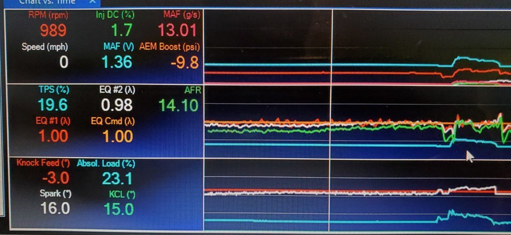

    My last log they did the squiggles like that for a few seconds, and the rest of the log they matched each other pretty closely. FWIW, the wideband oscillated in little waves that followed the EQ#2 squiggles

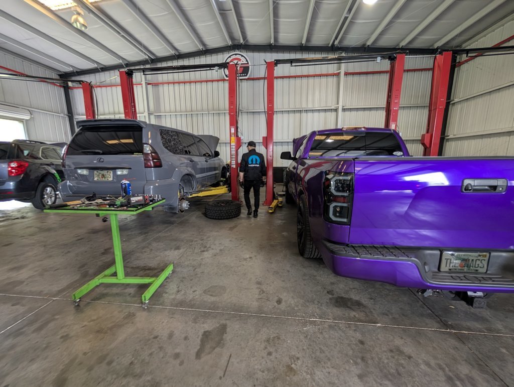

    Hopefully no more oil leaks when we're done. On my second leak now. Shop owner, who I'm close with, wanted to just pull the motor and re-seal absolutely everything possible to avoid more in the future after fixing the current one.

    Between this and the brand new tranny... I'm hoping this is the end of it and this thing goes on forever.

    Anyone know of a Geared Rotating Head add on for a standard engine stand that can keep up with a 3UR-FE ? Not looking forward to dealing with the motor in the normal fixture.

    My friend has one that came on a stand from HF and he had a Duramax on it and said it handled it fine

    I have seen that on their stands but don't see the rotating part alone. I got the idea from I do cars tear down videos, he has a HF stand with it.
