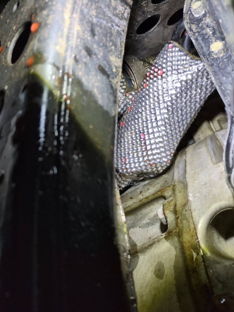

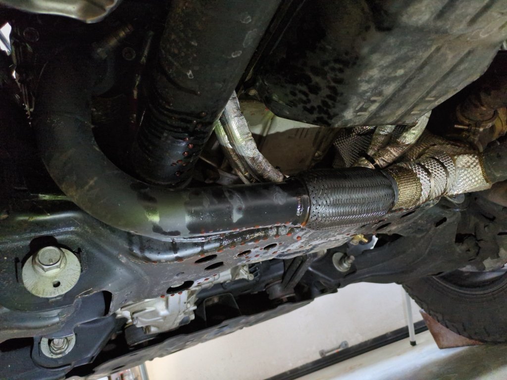

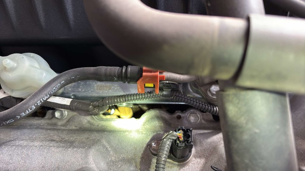

    Pulled all plugs, drained the pan, can't get the thing to budge manually via the crank shaft. Ended up loosening the pulley bolt without any movement in either direction. It was a pop, then silence. This is the underneath, but I don't see the source.

    Can you see anything by the starter? I had 8 and 6 rod pop through on passenger side. My crank was tuck from 8/6 and 7/5/3 rods.
