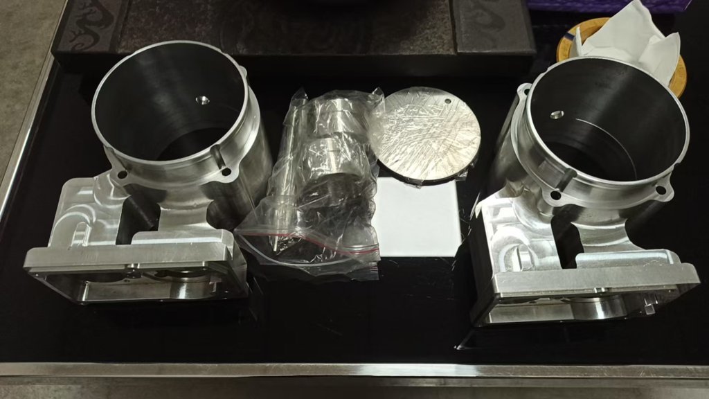

    I actually got an update from the machine shop a day or two ago on that front
    Hopefully RevB seals correctly and all the other upgrades work :fingerscrossed: at a minimum the sex appeal is a lot higher since I shaved 30+% of weight from the first prototype!
