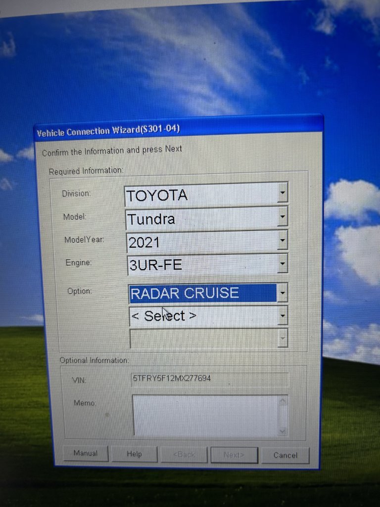

    Good news is I got more detailed pictures to update the how to unbrick procedure. I’m glad I wrote it down last time, as I would not have remembered lol.
    Now the question is do I try and tune it again right away or just be happy it turns on haha.

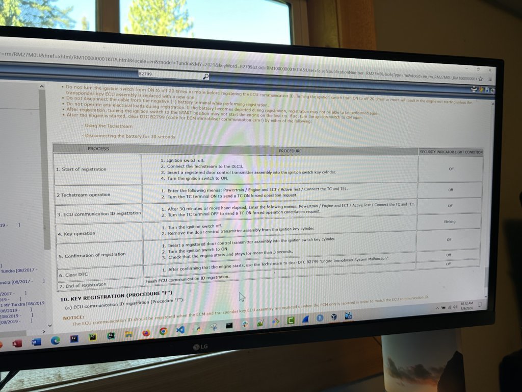

    So in my write up on unbricking I say wait 30 mins while you short the ecu with techstream and it’s definitely 30 mins haha. I tried at 10 mins and no go. 30 minutes round 2, success! Here’s the actual Toyota documentation on what’s going on:
    Then I decided to take a gamble and write a tune…..
    And success again! Time to go have a drink and think about my life choices.

    For 2020 and 2021 from my research if you brick the ecu you have to either replace with a different ecu or take the ecu apart and short it physically (which I think takes some other equipment to mimic some of the tundra systems). I bought two backup ecus hoping I wouldn’t need them haha. I think I may grab another now! Then follow the unbrick process after that to put in the right vin + reset the immobilization handshakes.

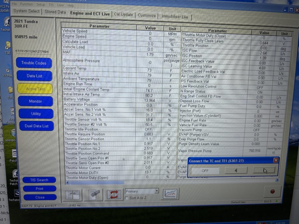

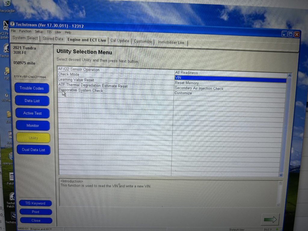

    (Can’t unbrick an ecu for 2020/2021 using techstream, but can swap in a different ecu then use techstream to setup that ecu)
    For 2020 the full functionality comes in around version 17.x while lower versions can do some things too. You want to make sure techstream automatically finds your specs like this:
    It does appear limited but there are a bunch of semi hidden things. Like you can change each computers stored vin number within a sub systems utilities (like the ECU vin), which can be used to program new keys for example:
    And you can manually cause trips/faults/etc within active tests, like using this option to reset the ecu:

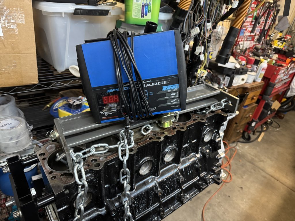

    I don't think I've disconnected the battery since the new transmission was installed, I've flashed a lot since then.
    I've done it this way most times. I'll even leave the stereo on, but I don't touch the laptop/cables/open or close doors. The waiting 10 second before and after I've accidentally clicked too. One other thing, I don't flash a "cold" truck, I've always driven the truck until it's up to operating temperature and the alternator has spent some time charging the battery. I didn't brick my ECU either of the two times with HPT, it was with VFT but I doubt that it was relevant, I've sure it was user error.

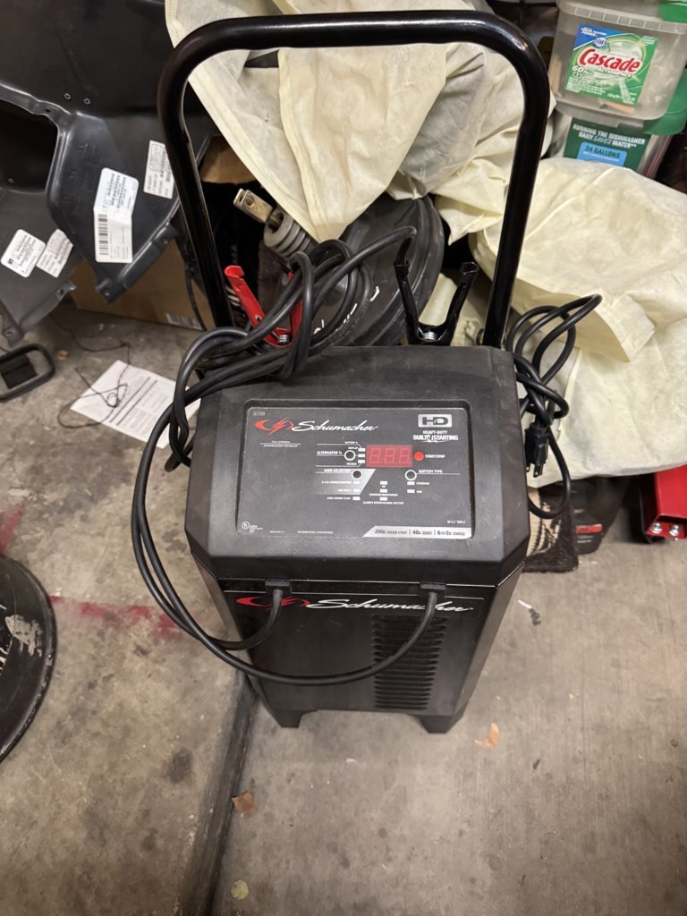

    I have a charger collection...
    The 3500 lives in the trunk right now since there's no motor.
    I also have a 90s Schumacher manual 2/15/110 buried somewhere for sub 12v batteries these newfangled computerized bastardas don't see.

    I bought the monster rolling one from Harbor Freight after I bricked my PC in an attempt to never have to deal with that again. Now it sits around collecting dust. I really should retune the truck at some point with ProSpeed. Would love to have Sniv take a look but then I gotta buy an HP Tuners device. :mad:

    I’ve got a charger/power supply. I can select the voltage from 13.4 to 14.5vdc up to 100amps. I use it to flash ECU’s to keep a constant 13.5vdc. You can see it top right.
