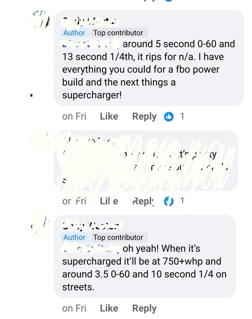

    I saw that on FB and was going to comment and decided to not waste my time. I don't know where these kids get their kool-aid from lol.
    NatesNightMare[QUOTED] and Mdl like this.

    Pro comp 7", 35" tires, method wheels, brush guard, light bar, roof rack, pedal commander, magnuson 2650 supercharger
    he might need the money to fix the ford when he gets it :rofl:

    I'm sure they are. I'm not mocking them. Just thought was funny because he thinks he's going to be running 10's when all of us in here know that's not going to happen. Either way you know if he does supercharge it he is going to be smiling like the rest of us!
    NatesNightMare likes this.
    hes claiming when hes ready to get the SC hes going to build the motor.
    what i found funny is he was saying his trans is bulletproof because he had it tuned
