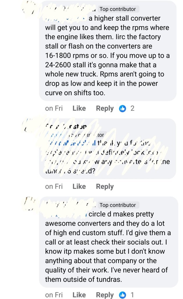

    I thought that in one of his videos he mentions an increase in stall speed of around 1000 rpm, but retaining the lockup clutch with an upgraded set to get best of both worlds and no issues locking up 800hp. I don’t recall which video that was, the info is just floating around in the mothballs somewhere. Might be wrong..

    :rofl:"Top Contributor" :rolleyes:
    I remembered that being mentioned as well, but couldn't find the source...they really need to include more detail in their site, would probably get more orders if people had more information.

    I even asked about using that TC for my IPT build and was told not to do it haha. If I remember right the main thing was if keeping the truck for street use keep the stall as is. I think the further explanation was the supercharger makes decent power at low rpm so no point in raising vs like a high strung turbo application.

    here it is

    yeah its some FB shit to basically say you post in here a lot :rofl:

    Yeah, quantity not quality

    Years ago I had an old bronco with a 400m (no poking fun at the boat anchor..) and C6 transmission. I rebuilt both of them; flat top pistons, RV cam, Edelbrock intake and 4 BBL on the motor, TCI kit and shift kit on the transmission. I drank the torque converter performance Koolaid and ordered something like a TCI sizzler performance street converter to go with the fresh motor build and ‘make the most of it’
    I HATED it.
    It was streetable, but barely. Power was on or off. It was a lot of fun about 2% of the time, but miserable the other 98%. If I had any brains in my head I would have done some dead reckoning and thought ‘I have a motor that makes peak torque around 1700 rpm and peak power at 3600 rpm that basically redlines around 4000rpm, and I want a converter stall half way through the RPM range?!?’
    I swapped it out for a low stall converter and was much happier. No issue getting in to the power band. If I were competing in the Anchors Away! racing bracket for comically slow large displacement motors, that higher stall converter would rock! But it failed miserably everywhere else.
    I kinda wonder the same thing about a higher stall converter for the tundra. Better lockup clutch I’d take, though.

    I know these guys. Great kids.

    you in that group too? :rofl:

    Not sure what group it is, but I seen the name through the scribble.

    You can change the stall speed...heavy duty damper springs and some other gadgets. I believe for daily driving you don't want above 3300rpm stall and too heavy springs will be harsh when engage/disengaging the TCC.

    High stall blows on the street been there done that no thx lol. As far as heavy duty goes I’d again say we havnt seen converter issues so why change it
