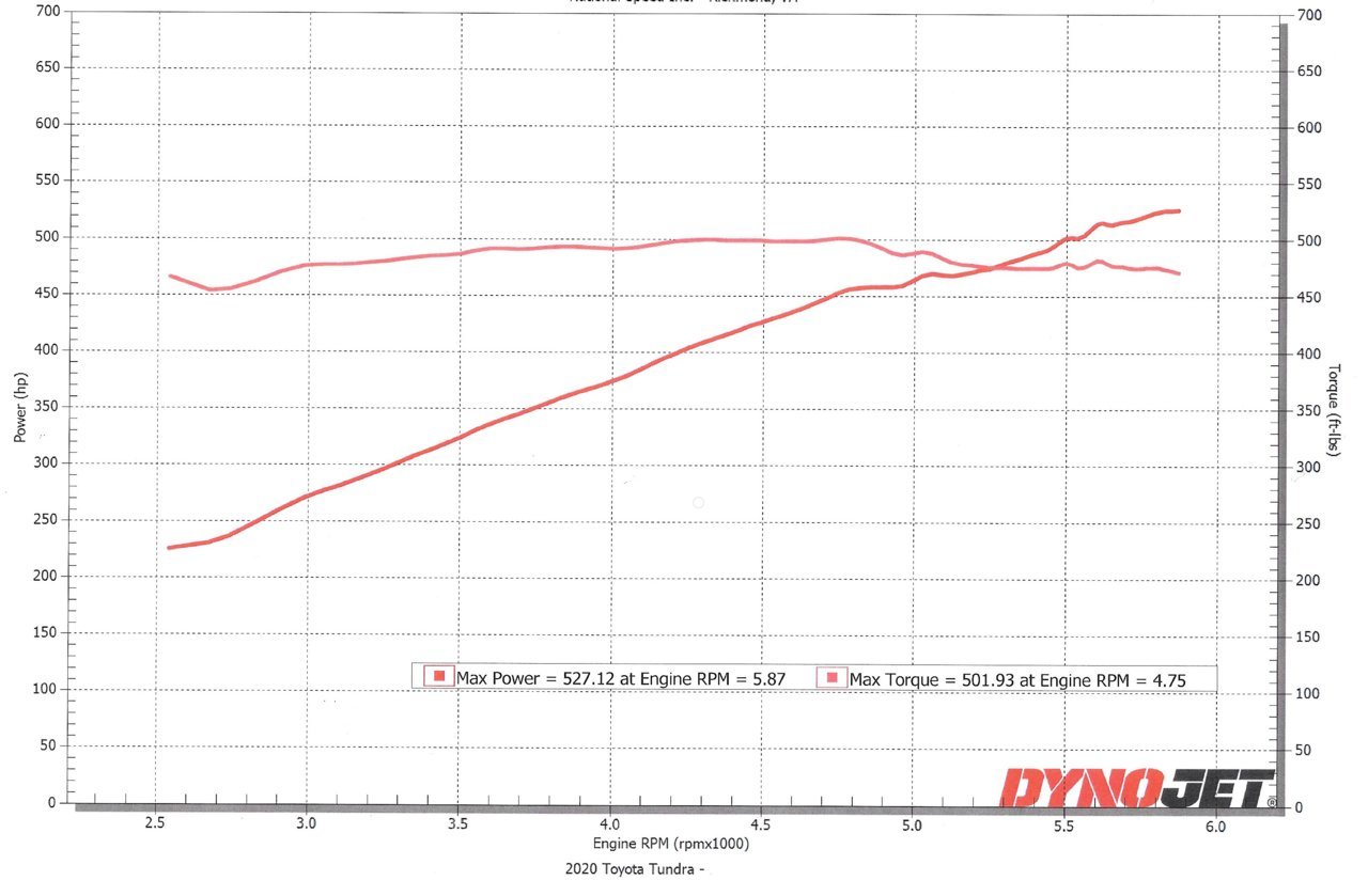

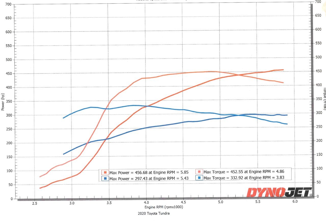

    As requested so you don't accidentally browse through my dik pic albums. These are smoothing runs, I think the final in a multi-pull series. First one is Stock vs Harrop Stage 1; second is Stage 2 plus the 84mm TB and the PS 4.5inch CAI upgrade:

    Flat tq. Looks awesome
    good tune

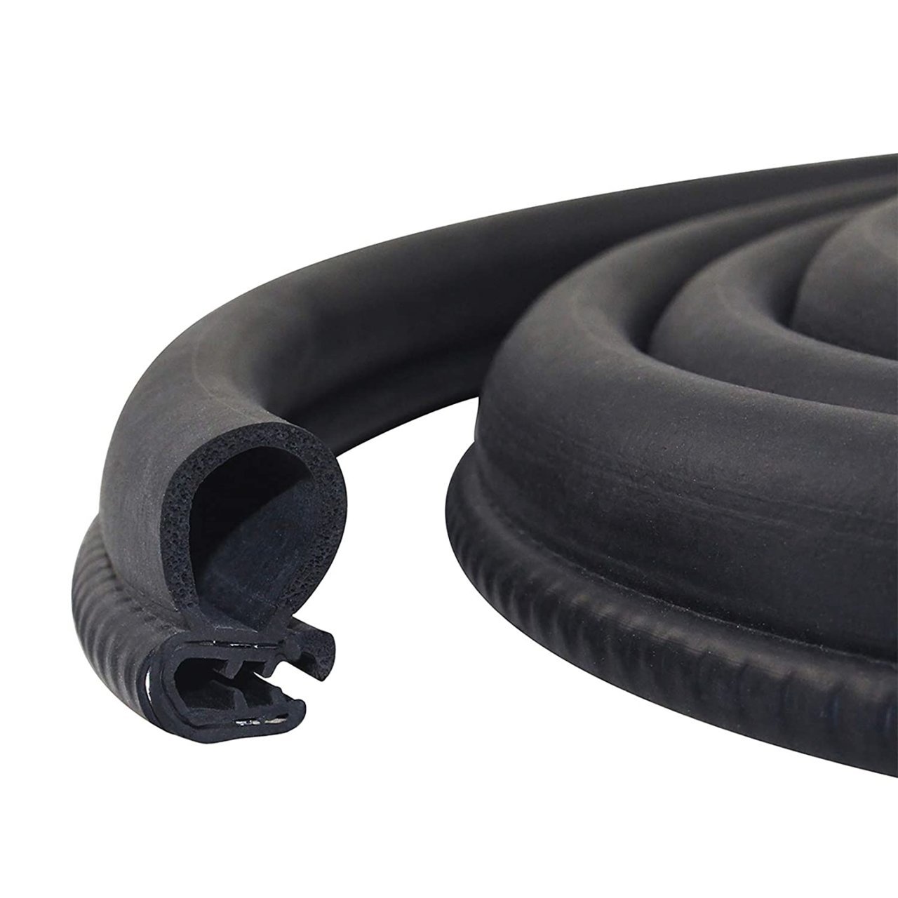

    Something like this should work, no? The CAI I had on my Tacoma had this and it sealed that fender gap tight!

    I'm thinking grommet for cabling holes and RV sweep seal could work maybe insulate as well.
    Still concerned about bottle necking airflow into the CAI. Not sure the juice is worth the squeeze if I am already seeing dropped temps; the lower numbers I was seeing were significant enough to made me think something was broken.
