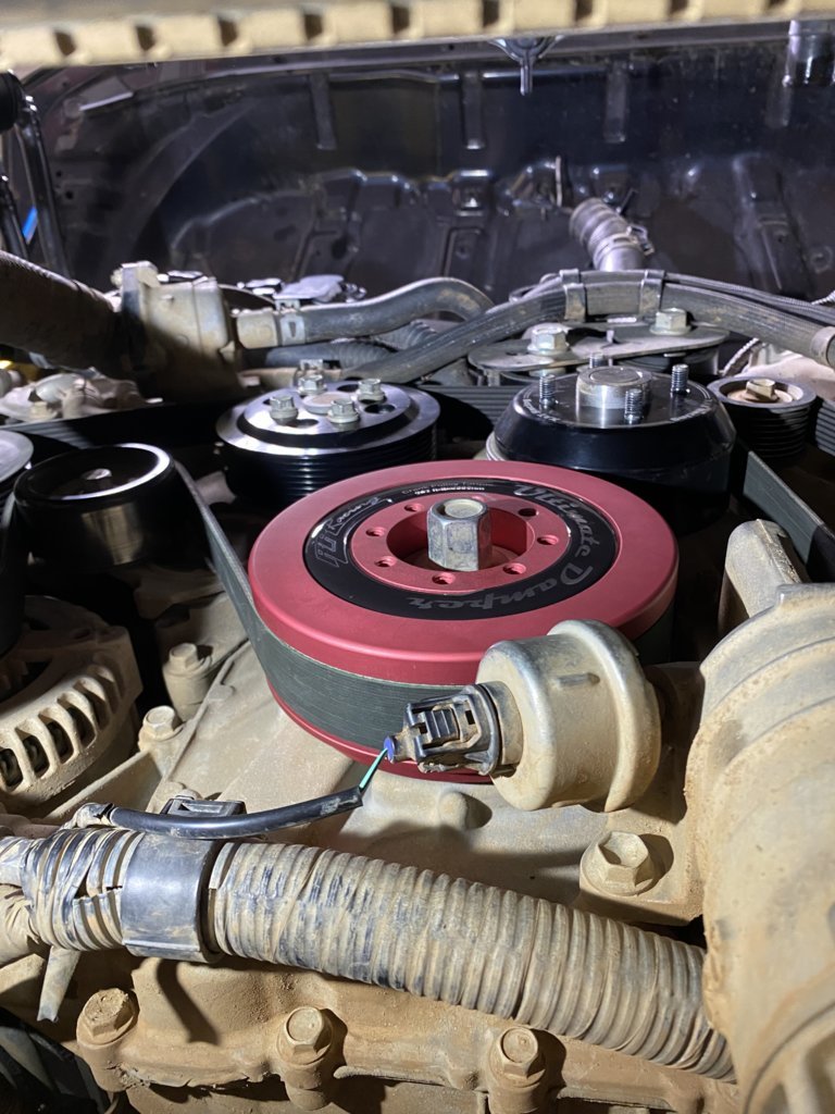

    Didn’t pull the rad for the new light weight harmonic balancer.

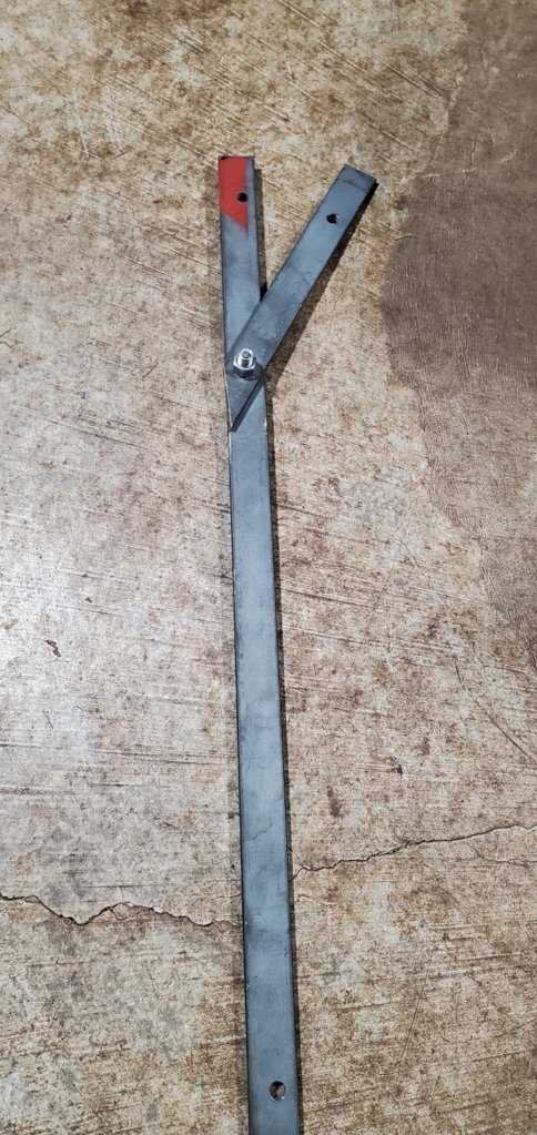

    I had to remove the radiator, might just depend on your pulley removal tool, I could have cut mine down and made it work without removing the radiator. It still would have been tight with the shroud in the way, and the radiator has to be drained to remove the shroud, so might as well yank it out.

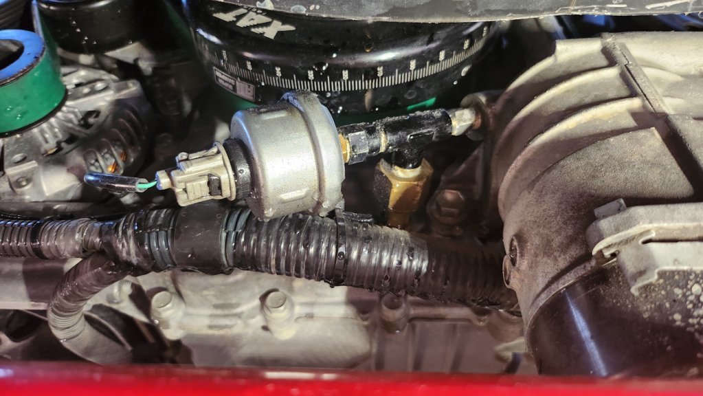

    And you'll need an adapter to relocate the oil pressure sensor, depending on the pulley size. The ATI pulley I got is stock belt pulley, but larger damper so I had to modify mine.

    I didn't have too. I have the e-fan so no fan in the way. But I remember swapping it with the mechanical fan on. I didn't require a puller either. Just used this to hold for removing and torque.

    I did utilize the 2 bolt holes to press it off. It wasn't on tight where I thought it would compromise the cover. But others may differ.

    It is not pressed on. I usually give the outer edges of the pulley a couple taps with a hammer quick and then pull it right off.
