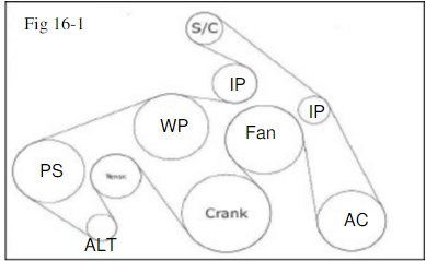

    Hopefully simple question. Is the bolt for the idler pulley below the Supercharger pulley right or left handed? Wanted to confirm before I crank on it haha, it’s an awkward one to get to. It would seem odd to me that both top idlers are threaded in the same direction since they spin in different directions.

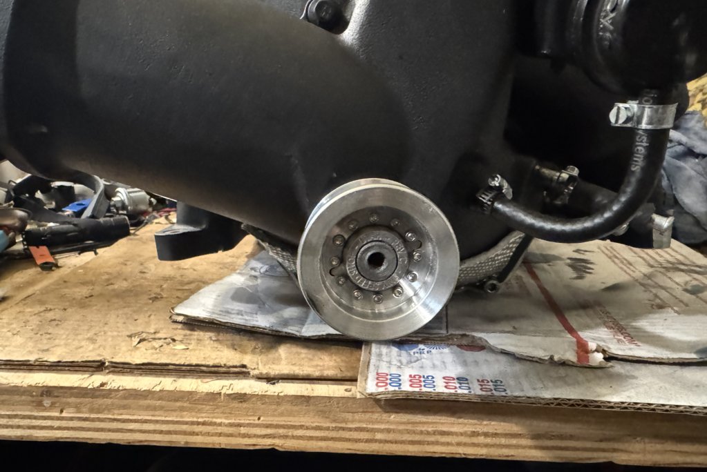

    I was concerned the pulley was too far forward. I was able to move it back with the pulley attached. Answering the question can it be done, my eBay tool did not make any contact with anything but the hub.

    Only the tensioner pulley is left handed rest are right. You probably already figured it out...

    About to find out! Had to go buy offset metric wrenches as that appears to be the only thing that can remove the 15mm on the crossover Idler Pulley. Toyota replaced my alternator under warranty believing that was the source of the sound (spent all day at Toyota… ya). Then handed me the keys and said that didn’t fix it and it’s likely the supercharger, which I doubted as I replaced the coupler myself 10k miles ago. I then got a mechanics stethoscope and Im no expert but one of the idlers was so loud with it you can’t keep the stethoscope rod on it, so guessing that’s the issue (TBD lol).
