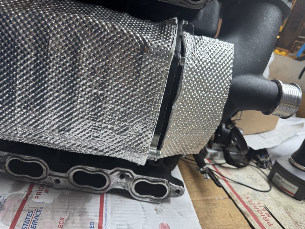

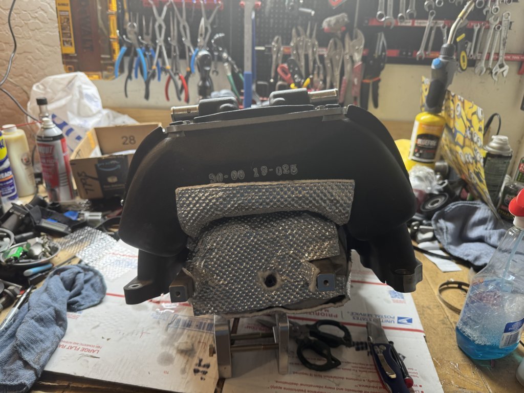

    What mine ended up looking like. Just put it everywhere I could

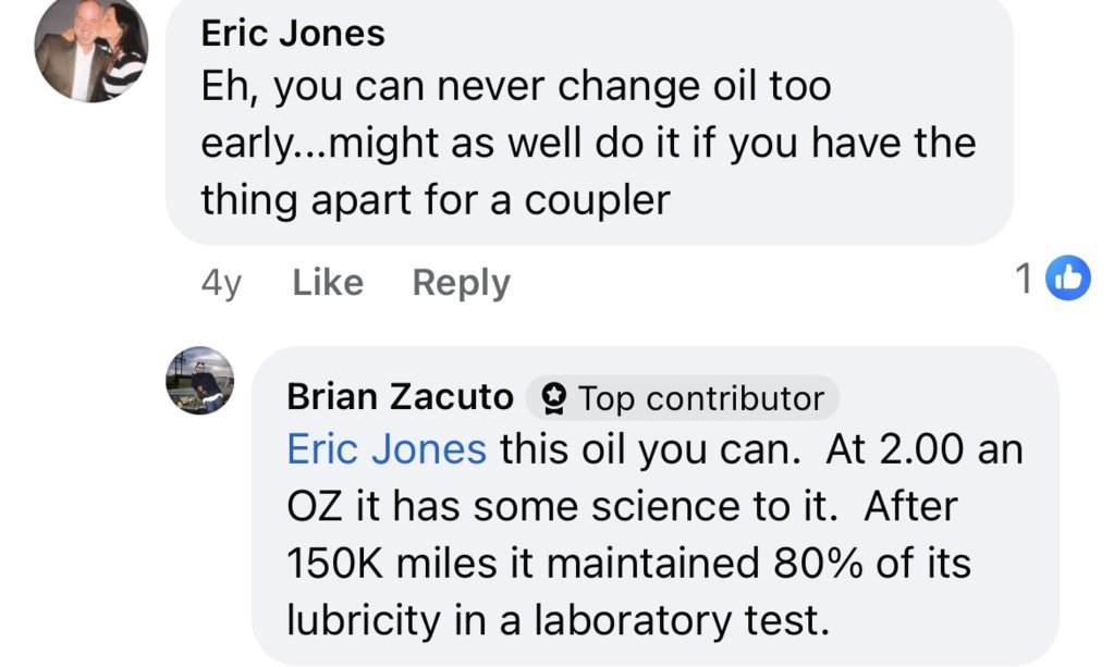

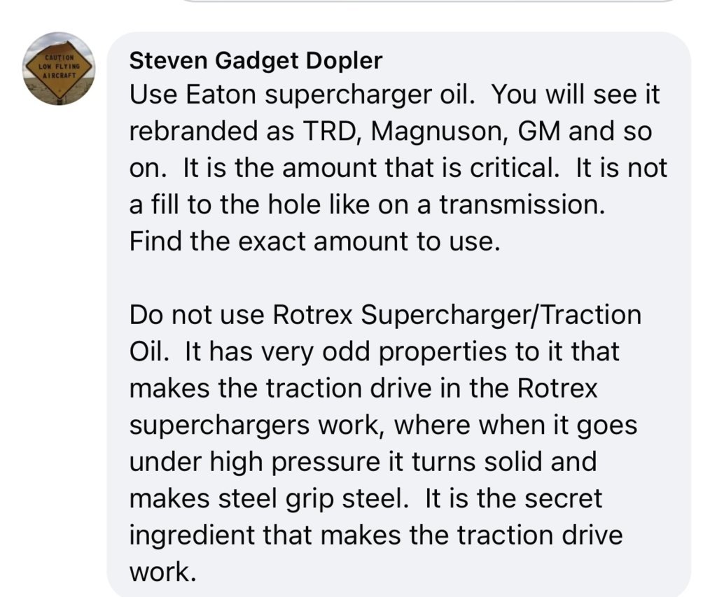

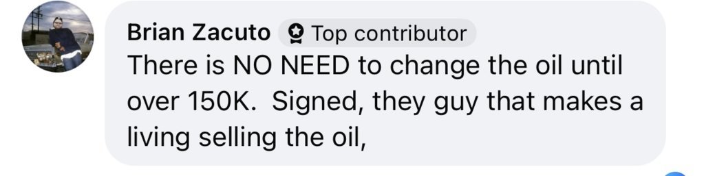

    Heck I don’t know, here’s some posts I saved about it. I’m just a master of regurgitating information I read online, not a master with the wrenches.:D Steven “Gadget” owns URD IIRC and Brian Zacuto is from SCOL. Both of them should know these units pretty well I think.

    Is it safe to assume JB's kit is ok to use as instructed (it says it is the exact best oil & amount) I have 2 SCOL bottles coming some day, ordered the same time, it's still processing.

    I think I shared this one a long time ago on here, but it answers a lot of questions which I assume are somewhat universal across most Eaton superchargers.
    Takeaways were slightly less oil is better than overfilled. Don’t fill to the hole, and the best way to get it all out is to remove the cover whether that be front or rear in the case of your blower. https://m.youtube.com/watch?v=3NFfZaS1XBU

    also tell us if it smells lol. The Taco s/c oil definitely did, and is notorious for smelling bad over on tacoworld thread.
  11. Dec 30, 2024 at 10:20 AM
    reywcms
    reywcms New Member
    Dec 20, 2021
    #72040
    7,536
    Rey
    North Plains,Oregon
    2017 Tundra Platnium
    Too many mods to come
    Procharger oil used to smell like absolute cat piss. Never had a positive displacement blower smell as bad as that. Whipple also sent pre measured amount to use. I would fill recommended. That oil doesn’t go anywhere else

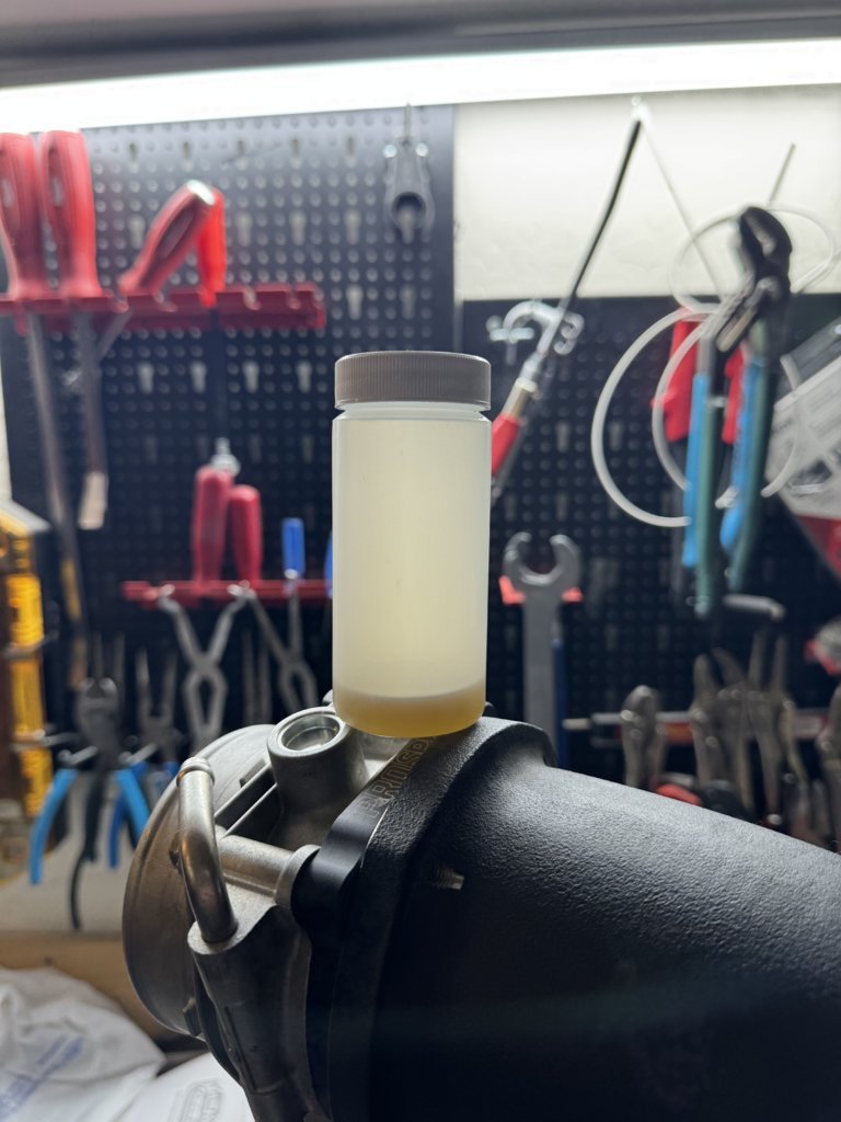

    Doesn't smell good but it's not awful (oil that came out)
    I emailed JB & asked how much to put in.
    Maybe I'll send it to Blackstone.
    That's all I had. Did the best I could.

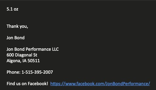

    JB's response:
    Guess I'm taking 2.9 out.
    FUN!
    Mdl and armyoffoo like this.

    Scol 7oz
    Jon Bond 5.1 oz
    Toyota 205 ml =7.2 oz
    So I guess the bottle I got is correct and my math conversion sucks as 205ml is not 8oz! Carry on!

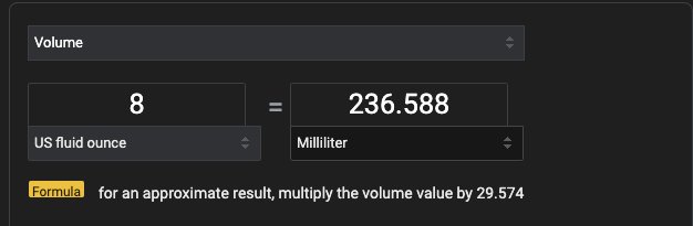

    8oz, it was the JB kit you linked.
    The Google says it is 236.588ML
