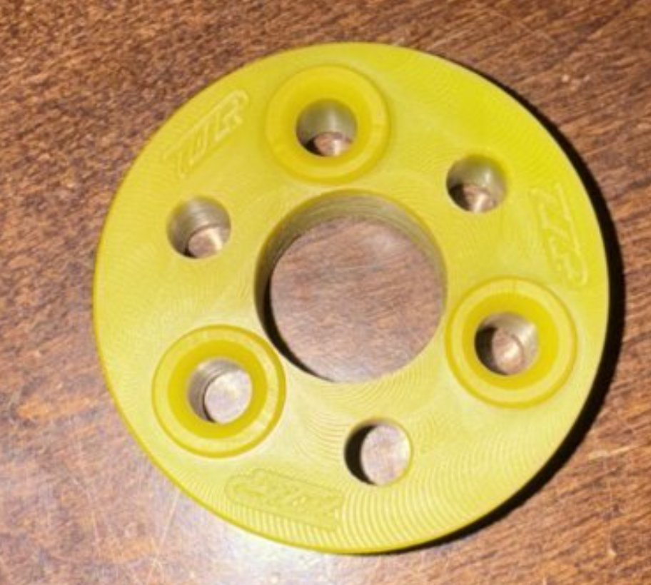

    Coupler from zzp

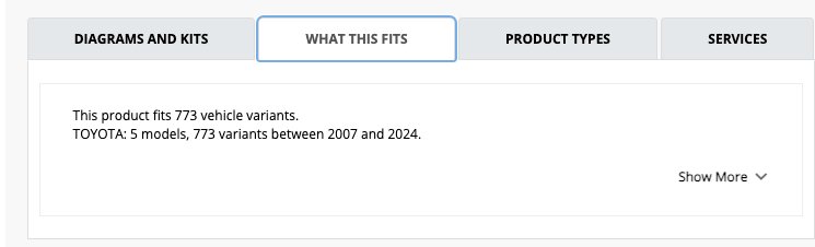

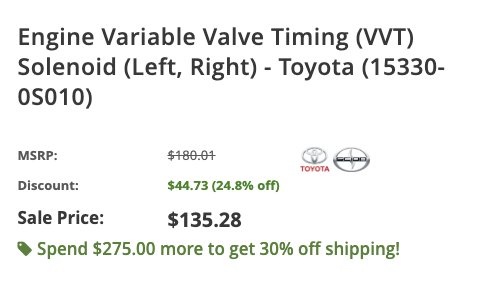

    The motor was delivered & they broke the VVTI solenoids, best I can find there is one for all 4, anyone know if that is right?
    I don't see exhaust & intake differences.

    Shitty!! Can you get a nice discount on the engine because of that? And just re-use your solenoids from old engine?

    The shop owner called & told me, the waterpump also sounds bad, I said they said it was supposed to be 70k mile & A condition, he was like they always say that move on.
    It was already cheap at 4k so not much room to complain, I am going to verify the vin Sunday when I go to see it (& get the SC to do the maintenance on it/put the heat deflector/Sniv pulley) They are closed Saturday, open Sunday)
    I ordered the 2 VVTI solenoids & waterpump, hopefully they are in stock, parts was closed when I called at 6:07 but they open ay 7am.

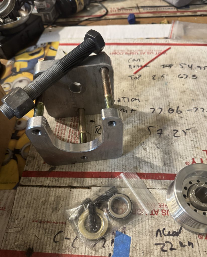

    The entire SC will be on my bench, I am taking the snout off to do the ZZP coupler & r&r the oil (Jon B. kit coming tomorrow) I have the eBay 2.3 on there now, I removed the original pulley before install because I had a dyno appointment and yours had not come yet about 2 years ago.
    I don't have a press, I used the tool the eBay pulley came with & plan on using it again.

    That's an infinitely better press on tool than URD sells. I've broken two URD tools...

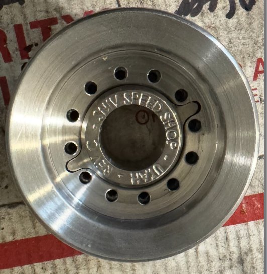

    Allens are in.
    Sniv's pulley is great!

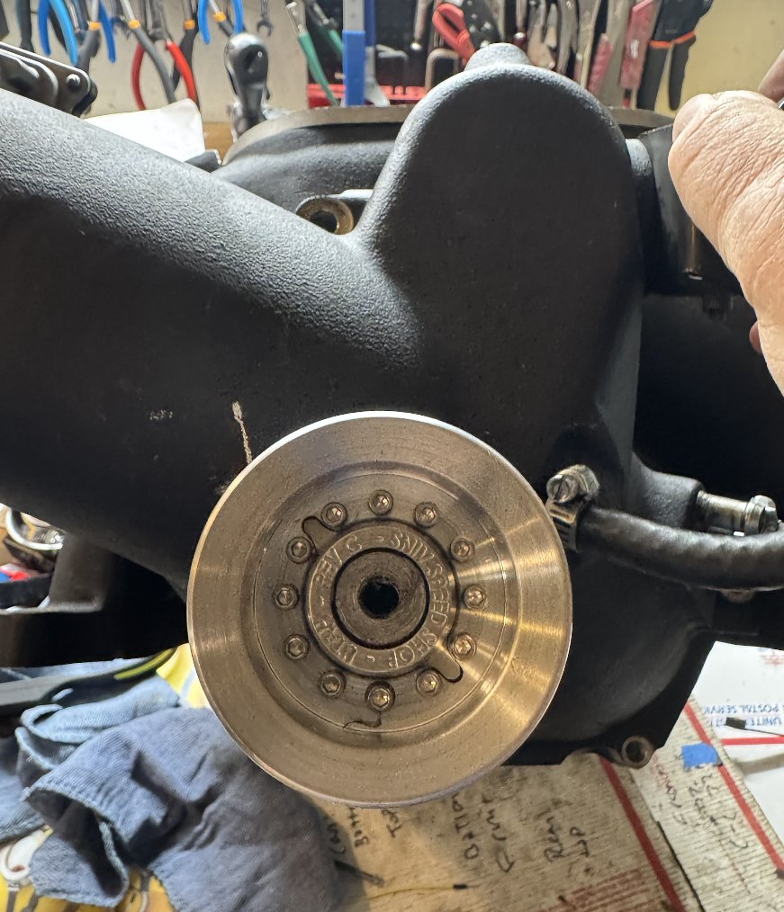

    Should I put the rest on the snout in one of these configurations? (Or other)
