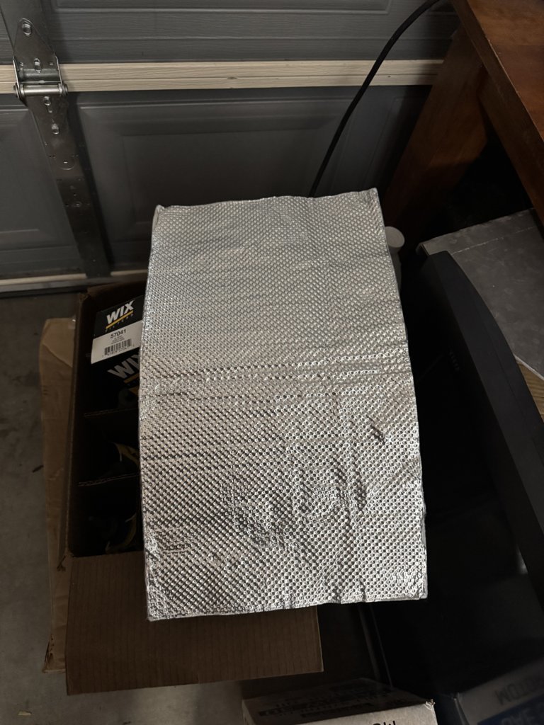

    What is the best way to trim the under 1900 heat deflectior?
    I'm hoping the shop will let me do the pulley and shield.

    Scissors!

    I used scissors to cut mine

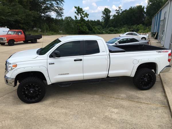

    Not sure I’ve ever seen a boosted DCLB. Closest I’ve seen is this sweet RCLB which didn’t seem to have any issues with speed!

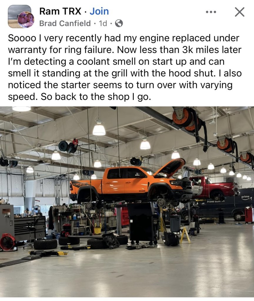

    I should really follow more of these pages. I guess it’s not all sunshine and rainbows for the trucks “factory built” for the big power either.

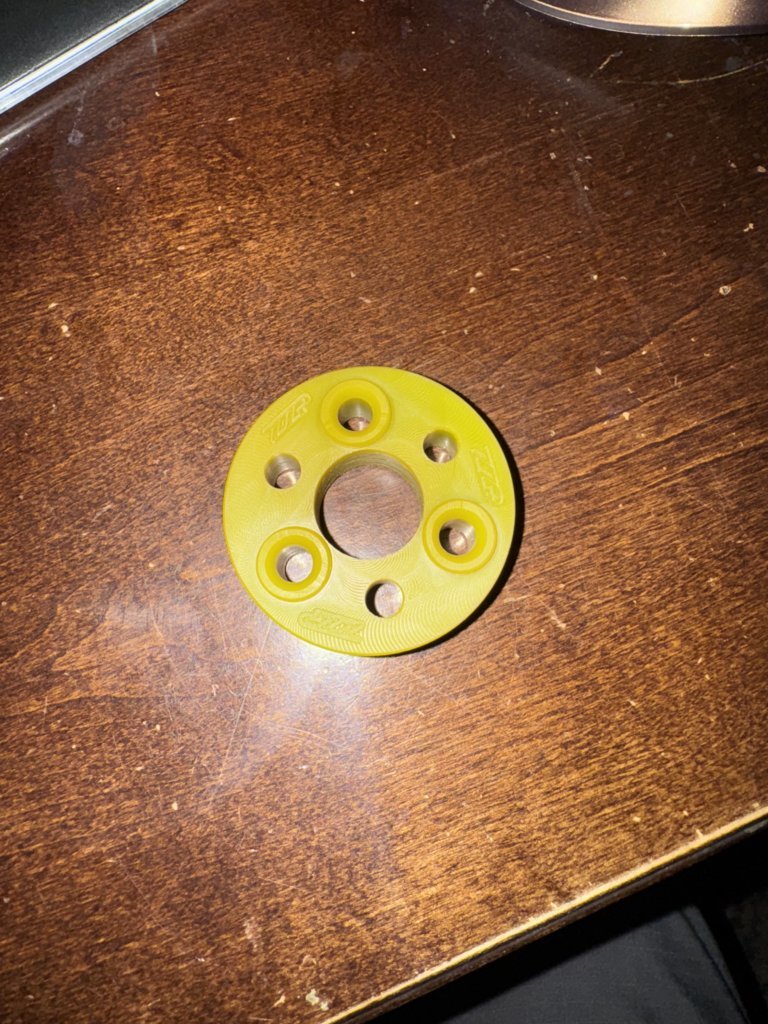

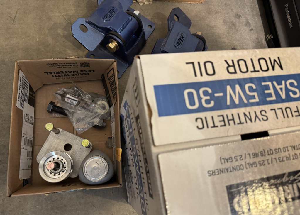

    The owner of the shop said because of liability I can't do the pulley and heat shield in his shop but once it's off I can pick it up and bring it home to do it.

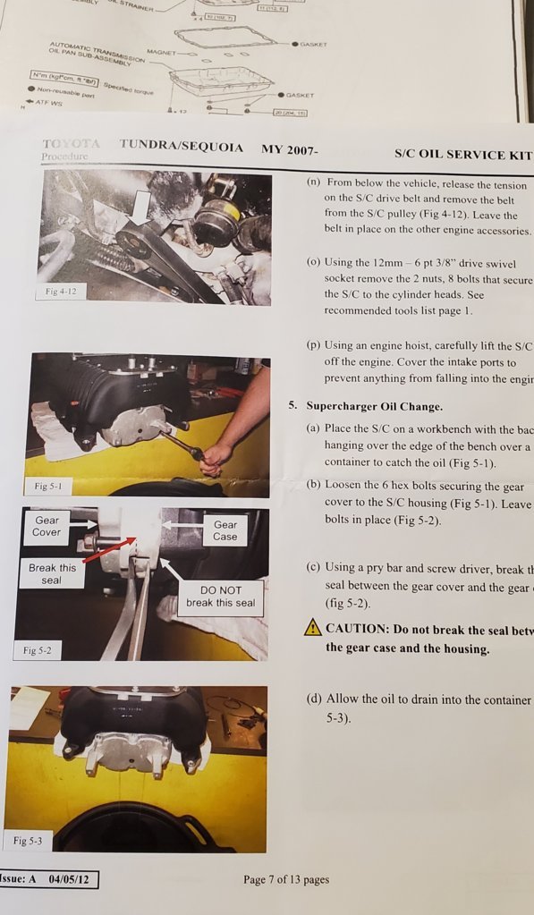

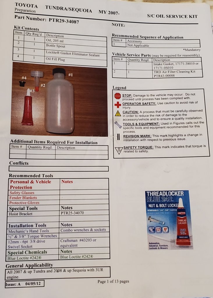

    Good time to change the rotor oil in the SC

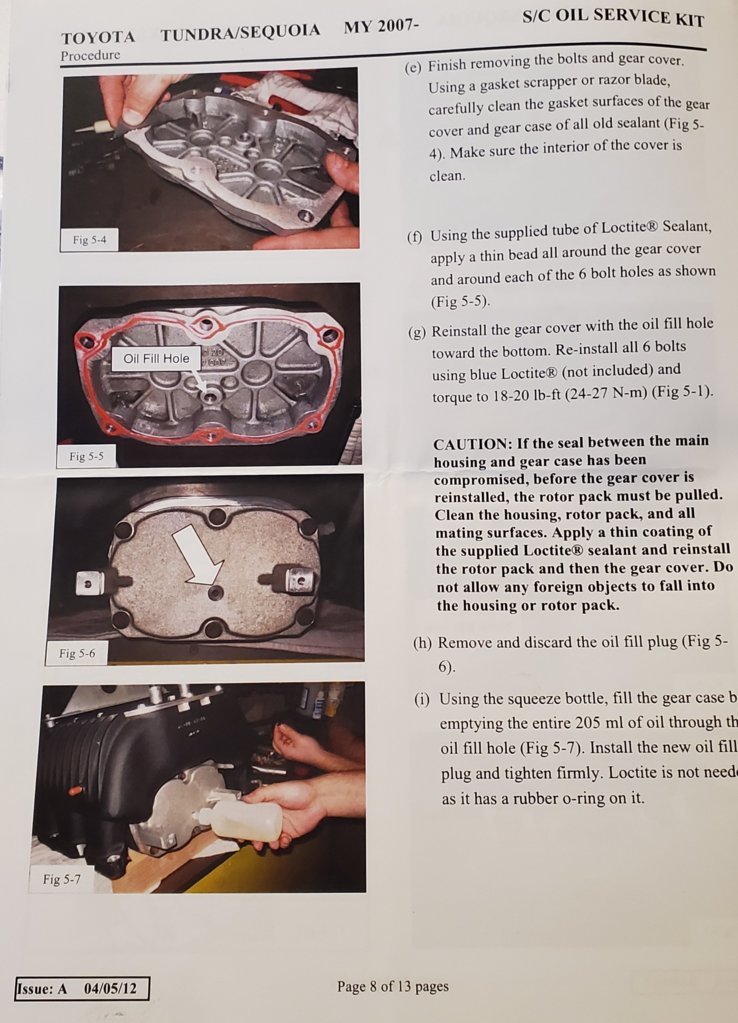

    Should I do this?
    Anything else? Just call scol and get it from them?
    Edit, no answer at SCOL, the site is pretty sparse on Maggy parts/stuff.
    What oil/what should I get?

    I got mine from Jon bond back in 2015. This is the Toyota svc kit. Don't know if they still have it.

    Ordered 2 bottles, in case.
    Do I need a new fill plug? If so where is it hiding, all I see on SCOL is an Eaton fill plug, sorry for so many questions

    The plug came with the kit. I'm pretty sure you can re-use it with a little blue loctite.
    **it's been a while since I dd this. plug comes ith an o-ringand doesn't need loctite.
