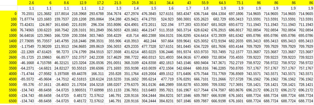

    Ok here is where I am and it seems to run very well.
    Low end shifts are smoother. I found that pre 100F trans temp, the trans shifted a little smoother than when it was warmed up and my trans table took over. This lead me to believe that the table I made might be too aggressive and indicated I should dial back the numbers a bit. I tried to follow some of my driving habits, as well as the torque curve, and to make the table numbers match what I think the motor is producing at WOT (or near WOT). I may still lower the high end numbers just to see how everything does, but right now it's shifting quick and effortless with high load in the 5k-6k range. Downshifts are firm and catch right away when you hammer the throttle. TC locks up right away and just launches you. I might be splitting hairs at this point, but I might as well do some trial and error and find out what gets it perfect from the tuning side. I know the springs are stiffer so it's never going to shift exactly like OEM, and that's likely a good thing because the OEM one bit the dust. I'm going to drive it like this and see if the ECU likes the line pressures a bit more and keeps 2757 out of the picture.
    edit - pre 100F trans pan temp should keep the trans shifting in cold shift parameters, that is why I mentioned that specific temp.
    damn, i added the wrong screenshot. Just updated it
