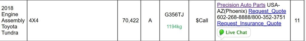

    I found a 70k '18 Tundra motor. The yard says it is not compatible. That is wrong no?
    Mdl likes this.

    It is compatible, everything will bolt right up

    Thanks for verifying that the '18 fits

    Like @armyoffoo stated it fits. Viktor said a lot of vendors will say it doesnt fit according to VIN but they do.

    I paid 4k delivered from around the corner where the truck is now for this:
    The shop just called and said Toyota said it will only work in a non flex truck, I said I have a non flex ecu (had a nightmare with the system thinking it had 85% ethanol when it had 10), Sniv tried to fix it in the tune, I said fuck it, got a new ecu. That's paying off now :p
