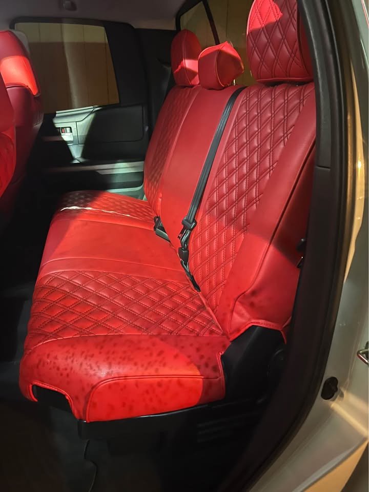

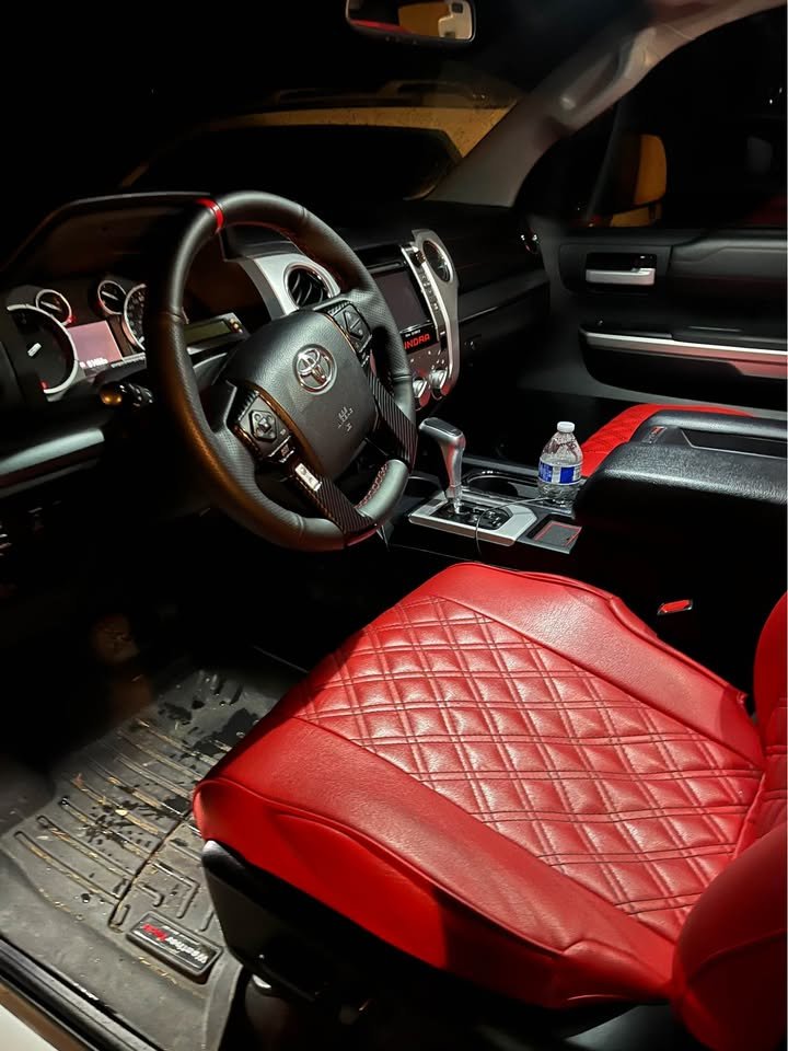

    Oct 20, 2017
    #10410
    6,573
    West Valley, Phoenix, Az.
    Boosted 2013 Sequoia TRD FAUX
    What do you guys think, doing both heads is north of 5k parts & labor and I still have a 143k bottom end (I can't do the machine work, don't trust machine shops here don't have the bandwidth to do this right now) or get a used motor.
    I found a few 200 Series LC motors, what do you guys think makes sense?
    Am I wrong thinking 200 series & LX570s get better build quality?
    This makes it look like they are the same
