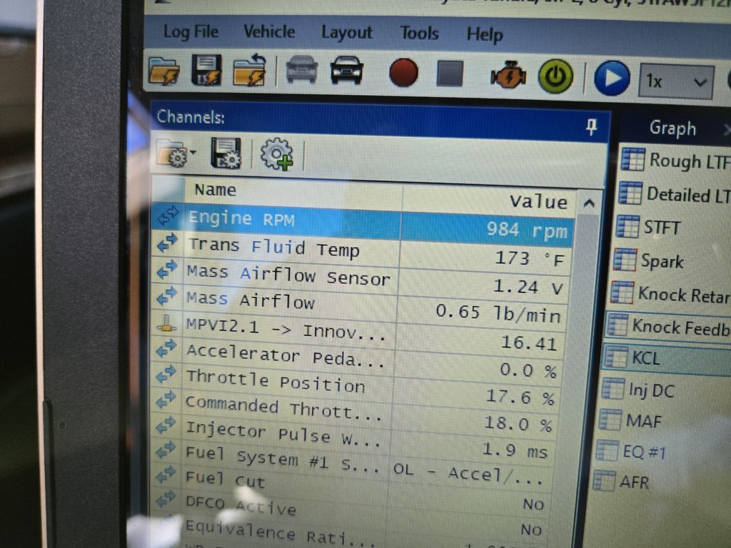

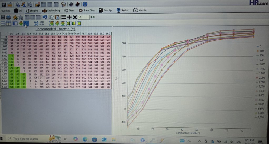

    So decided to to drop lock up further, normal/AI-criuse/tow-haul 4/5/6 under 2k and unlock around 1300rpm. Also added 20% taper 50% from 17.2 to 86 commanded throttle in the optimum torque trans table. With transmission pinned and a 40 mile drive on the highway, only maxed at 173. Transmission shifted like butter. Granted just loaded the tune. It's a little jagged at 2200rpm so will smooth out/interpolate these areas.

    Do you have a cooler? Doesn't sound right. I take you left from AZ, temps are like what, mid to high 70's and lows in the 50s. Here in sunny SFla I am at like 160-70. Over Thanksgiving weekend I was in mid 30 to 40 and trans temp was around 130-35. Also, while cruising on the highway my converter and trans temps are pretty much the same, 1-3 degrees off.

    lol im up at 7k ft. not all of az is scortchung desert i left at temps of 30°. highest temp i ran through was 65°. yes obviously i have a cooler its an 18 and i pinned it. trans pan temps were under 200 and cinverter unlocked would get extremely high
