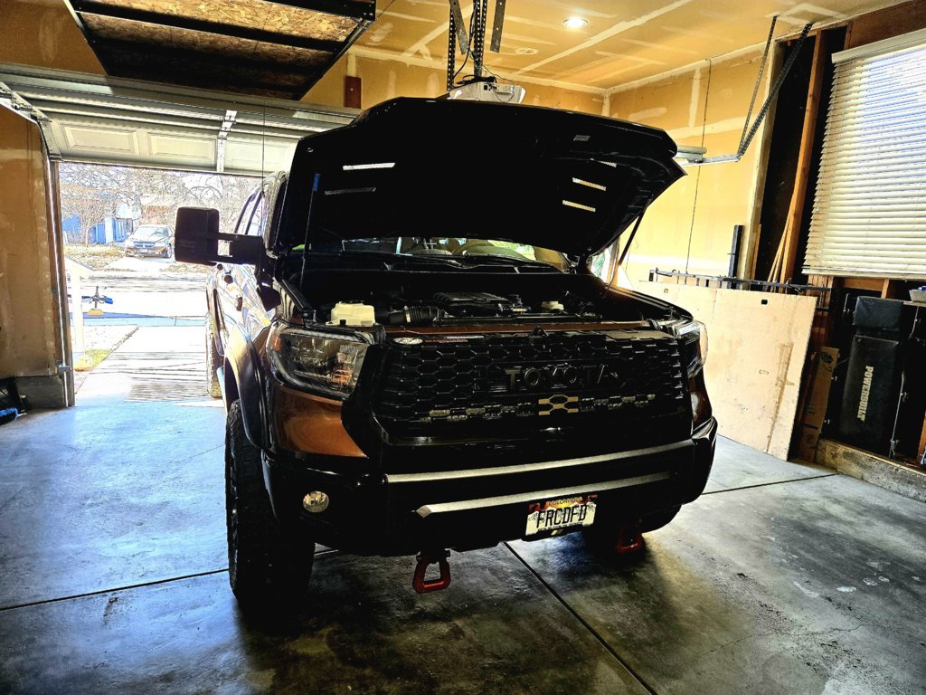

  6. Dec 20, 2024 at 4:07 PM
    ARES35
    ARES35 New member for life
    Aug 8, 2018
    #17920
    1,006
    Mile high
    Blown 2650 17 1794 Tundra 4x4 CM
    2650/750cc/76mm/SPD DP-DD exhaust/HP tuned
    Smooth as butter! Pulled it into the garage, looked around and pinned the thermo right off the bat! The reman is shiny lol
    e30cabrio, HulkSmurf14, Mdl and 2 others like this.
