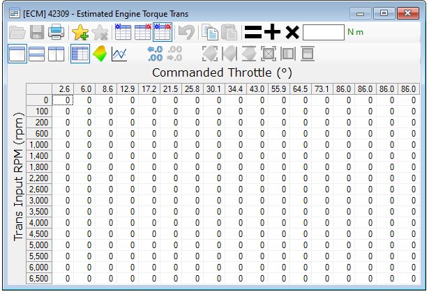

    Can I ask which table you guys are referring to? I'd be willing to experiment a little with mine to see if there's tangible feedback I might find to share.

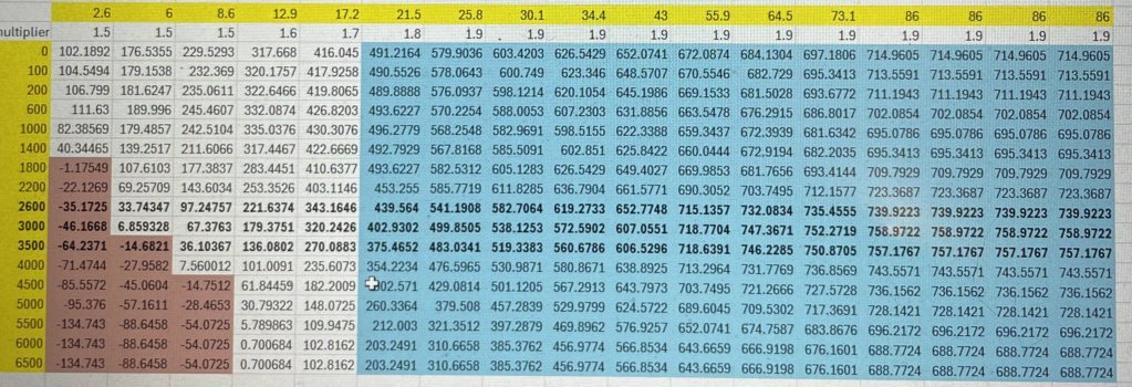

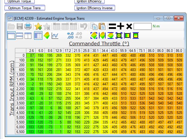

    This is the comparison of your stock one vs this one:
    Literally the same table :D
    Wynnded and Mdl like this.

    that screenshot shows 5xx torque. the stock table only goes up to high 3's. unless i can't read...
    ARES35 and helidave like this.

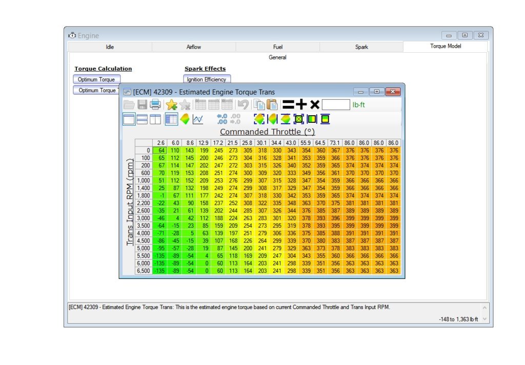

    my stock table
    Mdl and ARES35 like this.

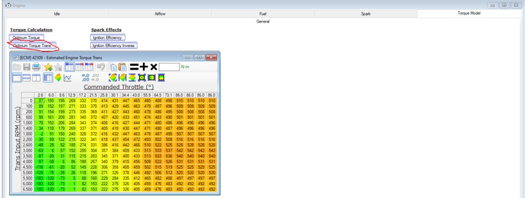

    What the fuck, this is what mine shows for your stock table:
    Wynnded and ARES35 like this.

    your stock table is correct.

    So from talking to @carn_dogg and @helidave my computer seems to be transforming the displayed values of the trans table, but the tune itself seems to have the correct values. I'm so confused.

    I feel retarded, so it was a display issue but nothing was wrong lmao

    When I first got HPT the same thing happened with the MAF table. Everyone saying it maxes at 511 and I'm like wtf, mine only goes to like 65. Took awhile to figure out you can change units :rofl:

    Yup, between stock and the TRD values theyre exactly the same. At least the TRD tune I reference.

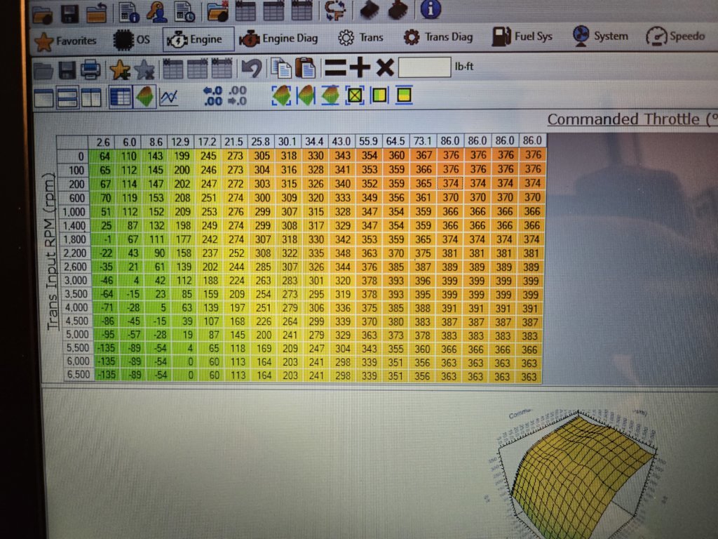

    Here is mine. I only have my excel version now. Blue is PE for me.

    758@3k damn!
