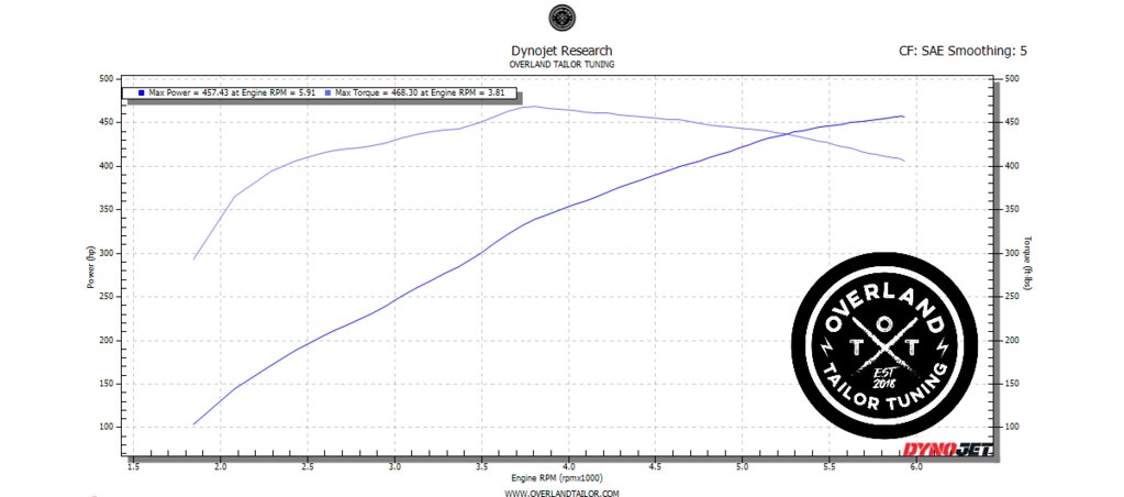

    If you’re at 105% IDC, you are not able to meet your fueling targets. But the context and details are just as important to the story as your duty cycle.
    What RPM are you observing that IDC & what was your PE/COT value at that RPM? What was your Injector constant? How these are configured are important to the picture. (You don't have to share that info btw!) Your calibration and/or, in combination with a potential install or mechanical issue, could be an underlying contributor to why you're seeing the IDC you are. Without the context, it's an incomplete picture of what's happening.
    On a typical sea level install with our calibration, after a confirmed baseline on the factory Magnuson tune (one reason we ask our clients to shake down the vehicle on the provided calibration), we will see a high 80's IDC at 6200RPM, which will yield results like this:

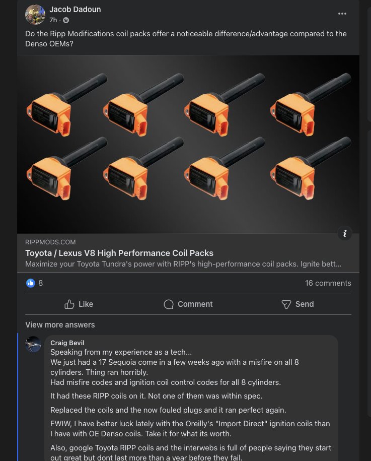

    Posted on 2nd gen Sequoia FB group.

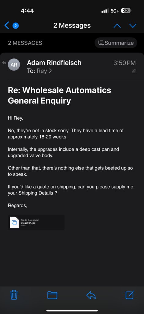

    Whelp interesting findings but not surprised since all the rebuild kits I’ve seen are similar

    So pretty much get a local/level10/IPT rebuild with possibly their extreme valve body? Or your reman with a beefed up VB?

    It looks like there may be higher performance trans rebuild materials available from McLeod/Raybestos. I don’t know who is actually using them over OEM though on the “built” trans options out there. If the Aussies aren’t using them I doubt there is much to be gained. My takeaway right now is get a valve body on the stock transmission, the sooner the better. Then keep the fluid clean with frequent changes, and keep it cool with the trans cooler and pinned thermostat for your best chance at a long life.
