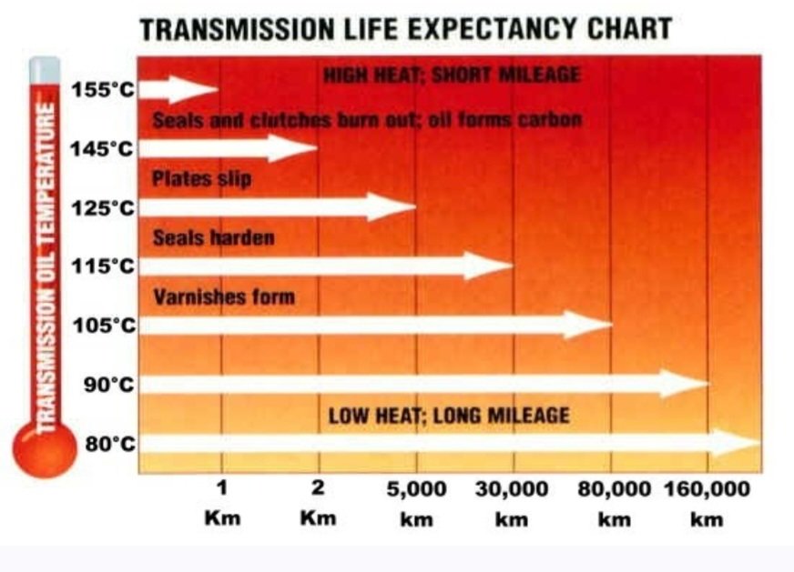

    This was posted a while back in the transmission cooler threads.
    Edit for @helidave :p
    80c=176f, 90=194, 105=221, 115=239, 125=257, 145=293, 155=311

    Magnuson 2650 w/76mm pulley, ADS suspension, 35's, misc overlanding bro-trophies
    Can somebody convert that to freedom units?

    Rockies
    Souped up truck
    100C = 212F

    Midland of the Mitten
    Doing the math in my head.
    250 is 155c
    80 is 175f

    JBA Longtubes, Snivs 2.0 SC pulley, ASP crank overdrive pulley 6.71 in, DD Full 3inch dual exhaust, IPT valve body, Airbox mod, 4.5inch intake, Denso 750, 450 Walbro, W/M injection, GM 95mm TB, SABM, Camburg UCA, Icon shocks, Speedmaster LSD, Motive 5.29 Gears, Mickey Thompson Baja Legend EXP 35's, Solid Offroad engine and transmission mounts, DIY Traction Bars, Tuning by Snivspeedshop.com
    Toyota wants it to run hot for the proper viscosity...nope!
    That statement is too much from Toyota.
    I believe the WS fluid was designed for best longevity under 200 can withstand to 300deg. I've been shooting for anything under 190 deg.
