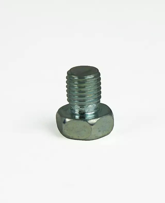

    I was thinking M8 x 1.25 or 1.0… the latter is super close to 5/16-24. Also note the plug uses an o ring seal, but a crush washer may work if the flange around the hole is machined for it. Plug is 90341-08001 (the 08 that starts the second series of number frequently tells diameter) and o ring is 90301-06196.

    I'll order one of these as well, will return what I don't use...or more than likely will go into the box-o-adapters
    https://bradshawsupply.com/products/8mm-2fp-m8x1-0-male-metric-o-ring-to-1-8-female-npt

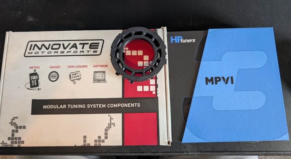

    had some parts arrive. I wasn't going to do the HP tuners just yet, but that website kept eyeballing me.
    I reached out to Colton, he said that Whipple told him to go away until next week to get an eta for shipping. Good news is, Whipple HQ (not sure if thats where they ship from) is in Fresno CA....so only a few hours south of me.
