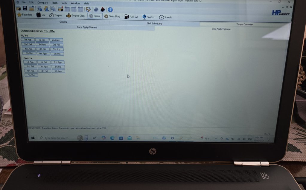

    Looks like the earlier trucks and OS have alot more tables to modify......wish we could copy and paste those tables to our versions on HP. That a big dream though

    What about flashing a different calibration with techstream that has all the tables? You must be able to overwrite different cal ID's, cause that's what the TRD tune does. You'd have to start over with your tune file but most of the stuff should just copy over

    Hum. I dont have a torque managment table other then the torque model/torque calculation/optimum torque trans. Is this the table they're tuning?

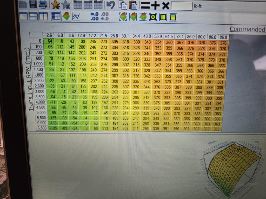

    Yup that’s the one. It lets the trans know what to expect from the engine so it can act accordingly. As I understand it. Increasing values makes a big difference on how it shifts

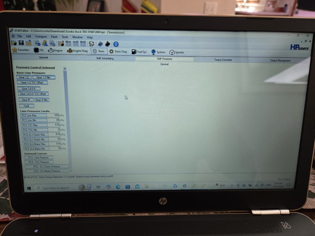

    I would assume increasing these values would bring on more solenoid line pressure to close up the gears clutches quicker.....but man it would be nice to have the ability to actually 5une the line pressures to close up the clutch packs quick. I dont want no slip lol. I wonder what calculations they're using to modify this table, percentages?

    Yeah they're using a multipler. So the standard change for SC application for Level10 is to take that entire table (positive values only) and multiply by 1.4 or 1.5. I ramped up to 1.9 by 20 or so % TPS.
    Results in firm shifts. You can tell the difference for sure. Make a change, flash, and see. Not going to hurt anything. Just will give you an idea of what the changes do
