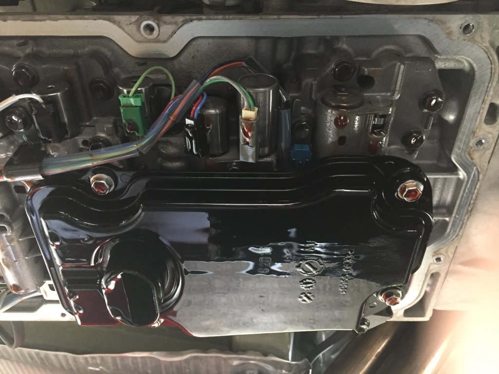

    Why cant you just add more fluid?
    A cheap bore scope will show you the correct level with a standard pan. install new pan and and view the level and adjust it where its the same as the original pan.
    Am I missing something?
    FWIW, I never got worked up checking the fluid level when the temp was 100-115*. Fill it untill the stand pipe weeps then add a half Qt after the plug is inserted.

    The deep pans have the proper height on the overflow port, so adjusting the level is just like stock.
    We are looking at the pump intake on the filter no longer being at the bottom of the pan due to the increased depth. This is less than ideal for eliminating air that could enter the intake.

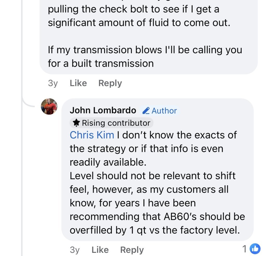

    John from IPT recommends adding a quart over full as well.

    The only reason to overfill is to make sure the pump intake doesn’t have the flow from the pan/reservoir interrupted.

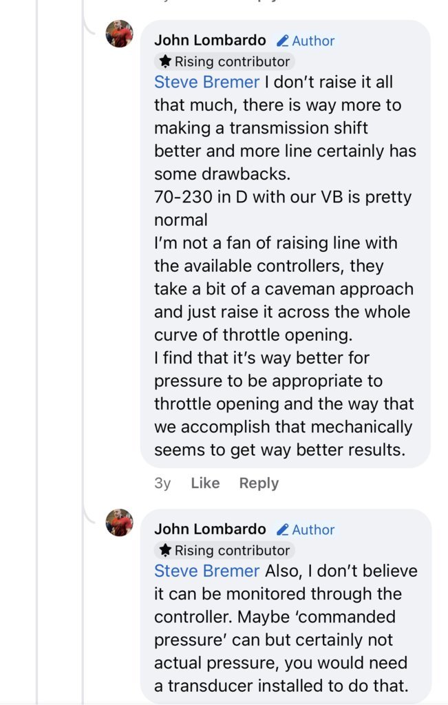

    Some additional relevant comments.
    Wynnded, Mdl and ARES35 like this.

    He mentioned that to me a while back. After the trickle at 100deg. Throw a quart in and call it good. No issues for the past couple years. I mention it here and there but some don't want to deviate from Toyota specs...

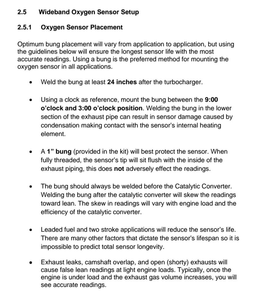

    Not if your running high flow cats FYI, you can run it after no problem doesn't skew.
