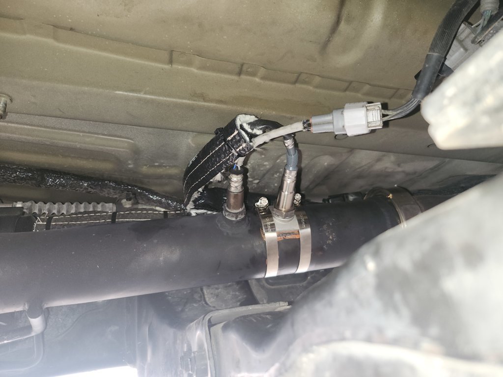

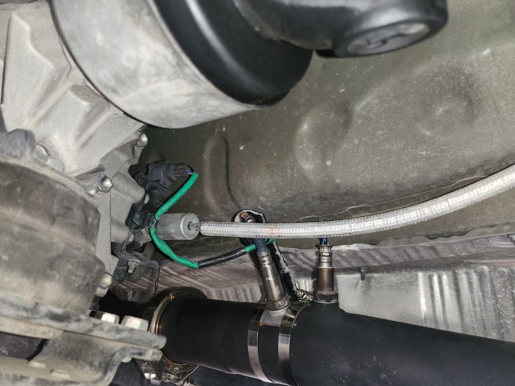

    I do passenger side, clocked away from the stock upstream sensor. It's easy to reach and mark. You can then unbolt the exhaust from the header and catback and pull it out to weld it on. The O2 bung from Innovate is too long, I cut it down to about half length too.

    Passenger side before the cat by the trans cooler brick

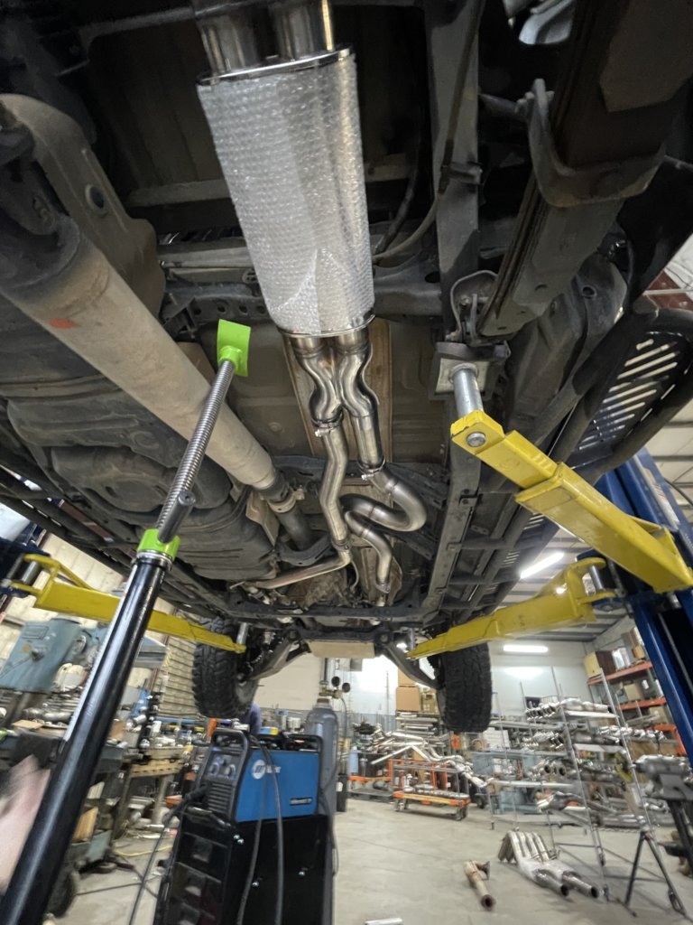

    You should be able to drill and weld a bung on the mid-pipes without dropping them. Here is where I installed my wideband sensors without removing the exhaust, and there is room to weld...which I'll get around to doing one of these days.

    This is kinda what i imagined doing beforehand. I'll need to figure out if its much of a difference between having it on one of the manifolds vs mid pipe.

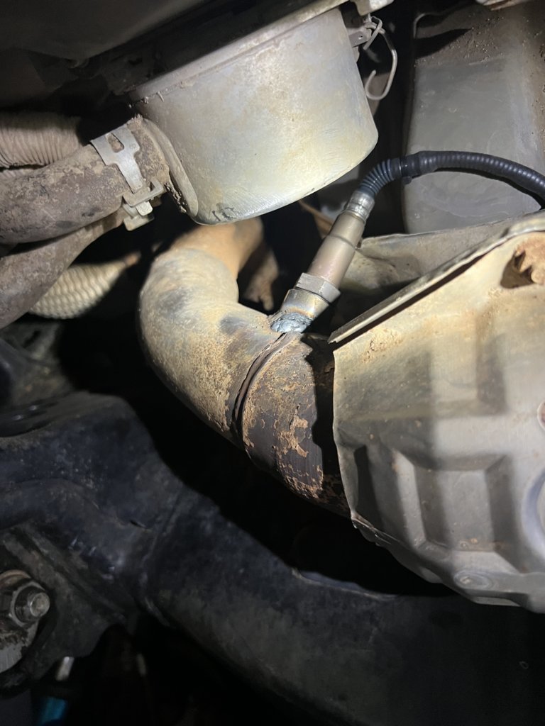

    The wideband should be at least 18-24 inches from the exhaust ports on manifold. Believe AEM is 18 and Innovate 24. Before the primary cat is optimal.

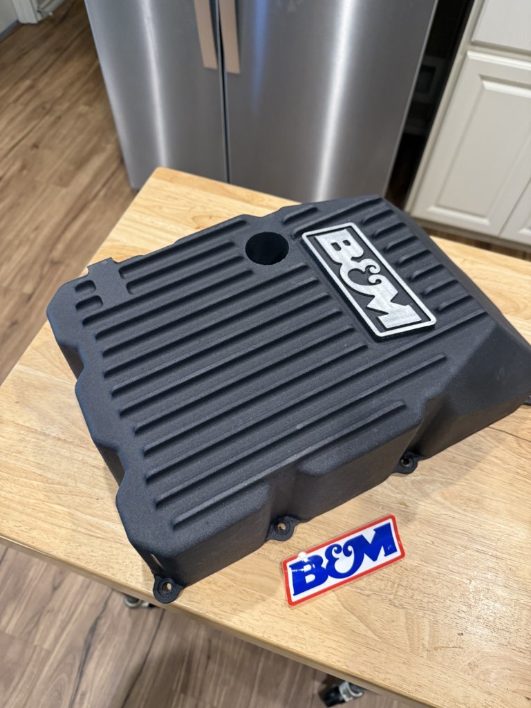

    There’s one thing that keeps me up at night with these deep pans, even the PML that I run (which has some baffles), is that they don’t lower the sump pickup to the bottom of the pan. Just like an engine, all we need is a little air sucked into the pickup to create a momentary drop in pressure and hell could break loose. I mention this only to try and cover all potential points of failure.
    Since we’re talking about it, has anyone ever logged the pressure on the trans for an extended time to see if there are drops during various maneuvers?

    So you’re saying we need a longer sump pickup lol. Not sure what the stock pickup looks like but cut it in half tig weld an extension.

    It's plastic, part of the filter...might be able to make a tube adapter that it slips into, then some longer bolts and spacers to keep the filter in place.
