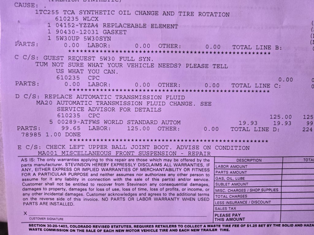

    My understanding as well.
    Serviced by Toyota… the story just got more interesting…
