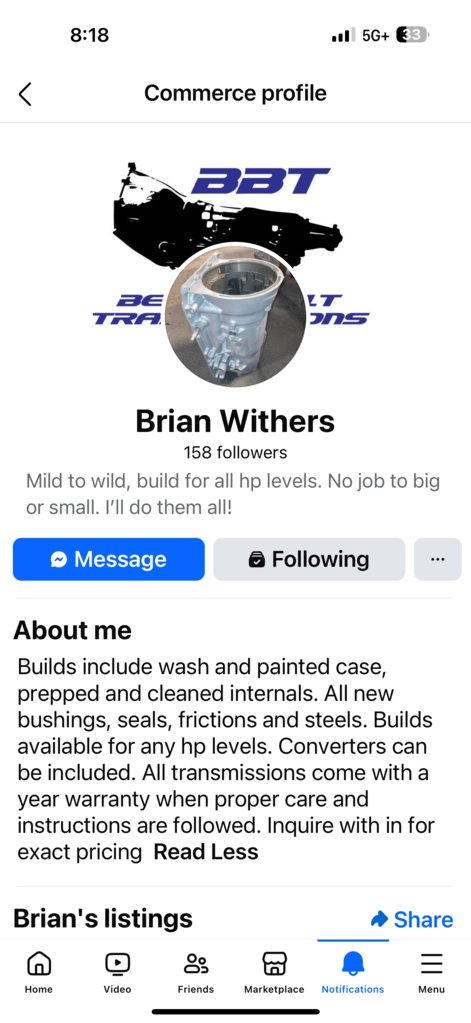

    Found a local trans guy could be an option.

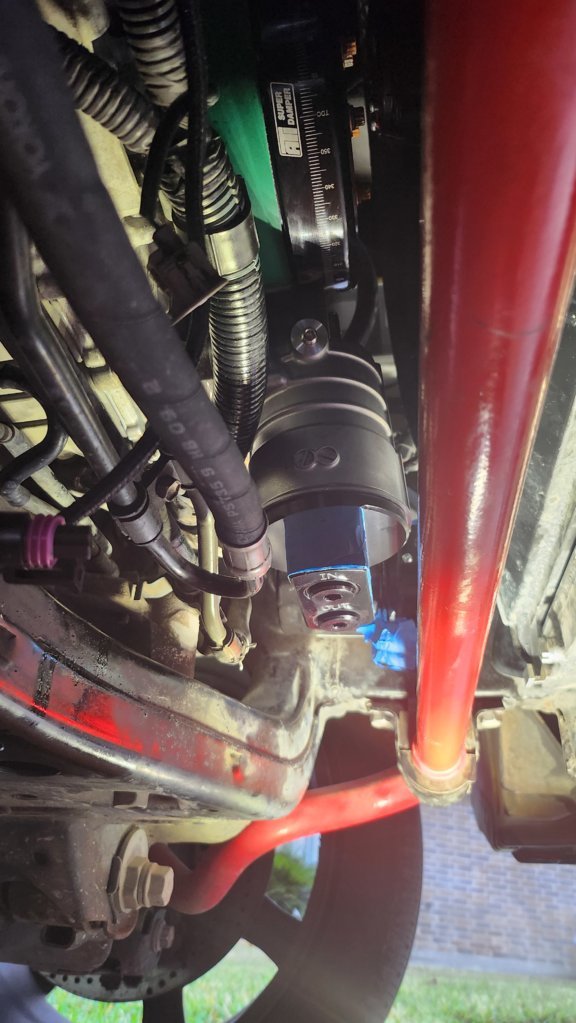

    Who designed this power steering setup with the lines zig-zagging across the engine bay like they had a deal with the supplier to use 300% more line than necessary so they could get their kickbacks?!?!?!!?
    /rant
    Seriously though, this power steering line setup is just dumb, and in the way of my oil cooler project.
    koditten, reywcms, ARES35 and 2 others like this.
  27. Dec 8, 2024 at 9:11 AM
    armyoffoo
    armyoffoo Member
    Jun 4, 2018
    #15876
    1,257
    Cypress, TX
    2018 Black TRD Sport CrewMax
    Supercharged with all the trimmings
    The pressure line from the pump makes 2 U-turns before going back to the rack, maybe they designed like that to reduce the pressure over the length of the run? I'm going to channel my inner Project Binky and make a couple brackets to get it out of my way.

    That's the cooling loop is my understanding
