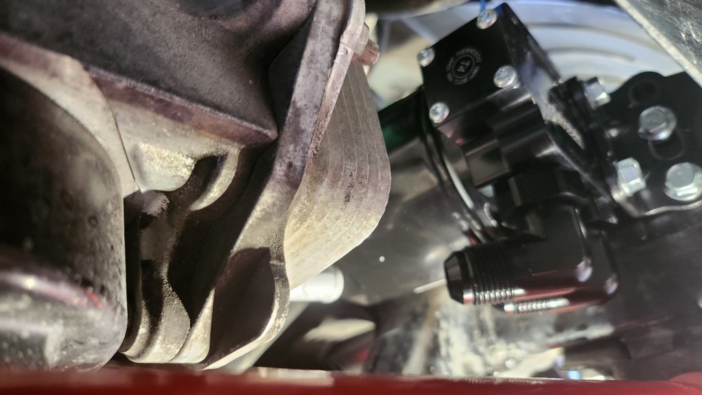

    I'm pretty sure my fittings will clear with room to spare, but I have the option to move it up another 1/2-1" if needed. Or I could get banjo fittings if it came down to it. I want to keep it between the bottom port on the heat exchanger and the fittings that go on the engine so I can easily drain as much oil as possible.

    1 1/4" - 1 5/16" between the the fittings and the sway bar, should be good. I used Earl's AT949010ERL that I was going to use in the heat exchanger, but I have more room there than I thought. Oil is draining now, and then I can swap out the stock oil filter assembly with the one from the models without the tow package.

    Any fool-proof way to clean a oil heat exchanger core out? I ran water through it for a while and blew it out with compressed air, but I just wanted to be sure before I trust it with my oil.

    I would think it would be good to use a gentle solvent like mineral spirits or even gasoline and let it soak in there. Then rinse with hot water and dry with low pressure compressed air or something.

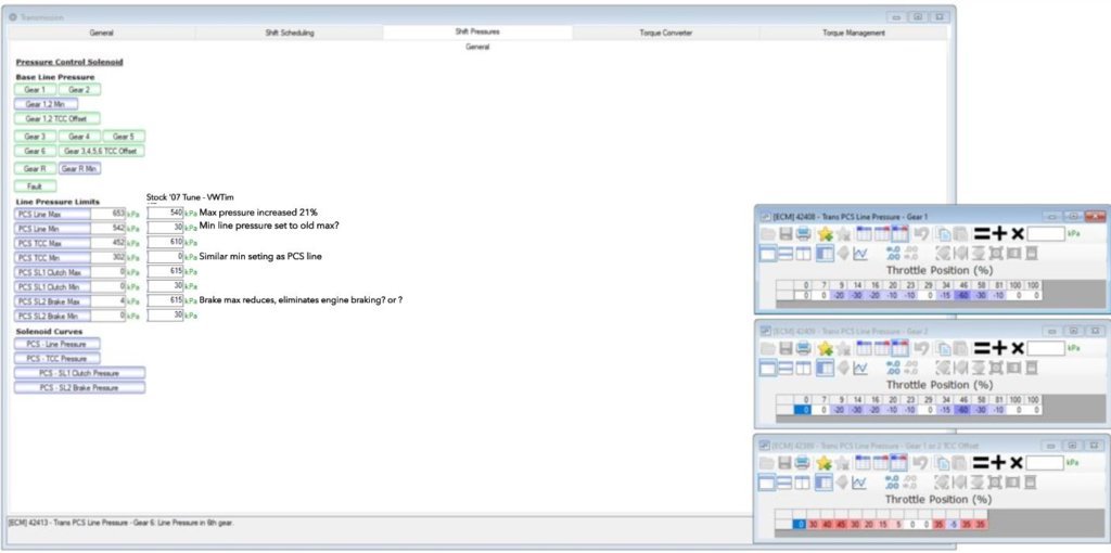

    @snivilous
    I spend a few minutes digesting this, at least the TRD tune portion as I've largely left my trans tune alone (except lockup) I overlaid the line pressure limits over your screenshot and wanted to talk out loud to see if I'm understanding what you guys are?
    1. PCS Line Pressure limit is increased ~21%, then from the base line pressures, it appears those tables for gear 1 and gear 2 modify those pressure limits and reduce the pressure over 34% throttle position?
    Assumption, increasing pressure thru lower throttle % should in theory keep heat down, but then it reduces pressure a bit near WOT to "back off" and take it a little easier on the trans. Thoughts?
    2. PCS Line Min and PCS TCC Min are both substantially increased. Unsure if this is again to keep heat down at the potential cost of loss of "rubber band" drivability?
    3. PCS SL2 Brake Max is reduced to almost nothing. Unsure exactly what the SL2 solenoid controls but appears to be engine braking lockup pressure, wouldn't this reduce potential for engine braking and go into a coast situation on decel?
    Any comments or thoughts from anyone?
    ARES35, Wynnded and e30cabrio like this.

    I'll have to look into it, but I think the values for the tune I showed arent displaying correctly (common on the 19-21). The values you overlaid look correct, and those values aren't modified, so if they're different something is wrong.
    On the 19-21 the solenoid curves are literal gibberish, that's why I think those values are also and I just didn't notice since I've never tried to change them anyway since the TRD tune doesn't change them.

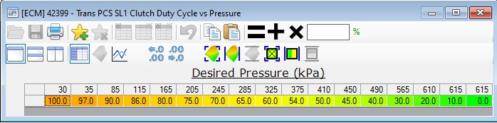

    To follow up, a normal tune (TRD file from my truck):
    The funky tune I posted:
    SL1 Clutch Pressure curve on my TRD tune:
    Same curve on the funky tune:
    On the 19-21 that are funky I just change the Base Line Pressure values (the ones highlighted in green before), everything below that should be ignored on those newer trucks since HP Tuners has issues reading/adjusting the data (as evidenced by the gibberish).
    Wynnded likes this.

    Interesting, pressure limits are identical to my stock '07 trans tune as is SL1 curve. Then the only differences so far are the gear 1 and 2, mine has them in 1 map, "Gear 1 or 2" And it looks like you have the compare from TRD vs OEM, so they reduce pressure at high throttle? Or are you comparing backwards?
