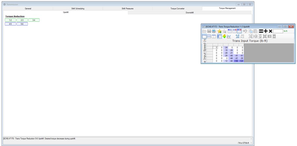

    Viktor did that on some tunes and I carry that over specifically when people want it, set torque management to zero at high rpm/torque so it's not doing anything if you're at a WOT shift. I've never had issue with it, but nowadays I just run the TRD values (which aren't like that) just since they seem reliable which is my main goal. As Silver17 pointed out above, the transmission stuff is a bit magical and I don't want to step outside the lane and screw something up, so TRD values are 99% and if someone wants to try and get nasty then I start turning off the torque management like Viktor did.

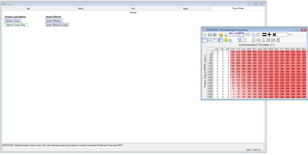

    I'd have to look back but when I did raise trans optimum torque table with the GM 95mm TB it resulted in misfires at WOT. I believe that's when you got @reywcms TB going with just the airload increase and did mine from scratch.

    Trying another torque table this evening. CEL came back on for P2757. Truck rips when WOT, but need to make more adjustments for lower RPM's to have it smooth when there is less load. MTF

    Ok so I used a new table that reduces expected torque in the lower TPS range and increased expected torque in the higher (>21.5%) TPS range. Results are cleaner and smoother shifts for light throttle driving. No CEL's - yet. Aggressive throttle and driving shows little difference. Overall improvement. I think we have one more iteration to get through before we are there. I think lowering the back half of the table a bit, maybe back to 1.7 or 1.8 instead of 1.9 would be good now that the lower TPS shifting is back to TRD values and smooth.

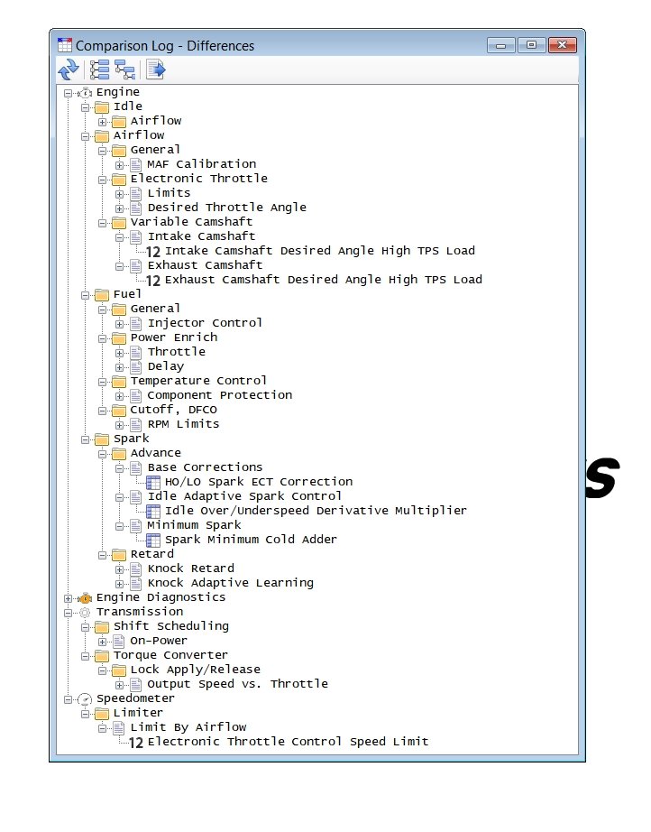

    Okay gang, here's a stock tune that I was able to stumble upon on this computer, I'm not on the one I use for tuning/logs and store all my related debris. Open it up to see what can be seen. I probably wouldn't flash it until someone can verify that compressing/decompressing has no detrimental effects on the tune; we don't want any bricked ECUs. I don't know, maybe someone has received a compressed tune file from a tuner and there's nothing to worry about. I know that there are file comparison tools/applications but for the moment, baby steps, eh?

    Yea, I loaded one of my files to compare and it shows all the differences. Looks like it's all there except the Optimum Torque table, which is there but it won't compare for some reason. must be slightly different between the two calibrations or something like that

    I noticed another difference: My truck has a whole tab on the airflow page of AICS stuff that yours doesnt have

    That's because it's a TRD tune for S/C'd trucks where the AICS is nonexistent because it goes away with the stock N/A intake manifold. I wonder if your truck's tune is a modified N/A tune.

    That makes sense, because I didnt flash a toyota supercharger calibration we just built on my stock cal id.
