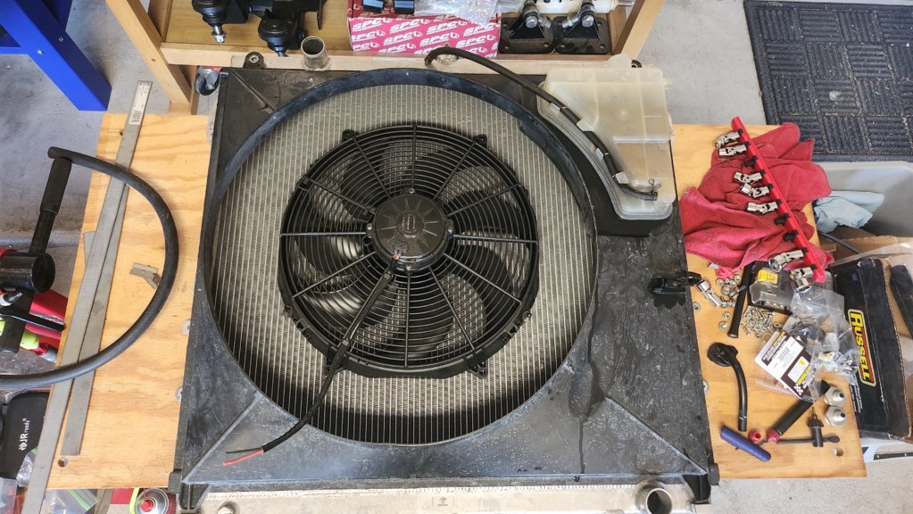

    Are you going to make/buy a new shroud or run it as-is?

    Going to run it as-is for now and see how it does, it's a Spal 16" fan that moves a ton of air, so I'm hoping it'll be good.
