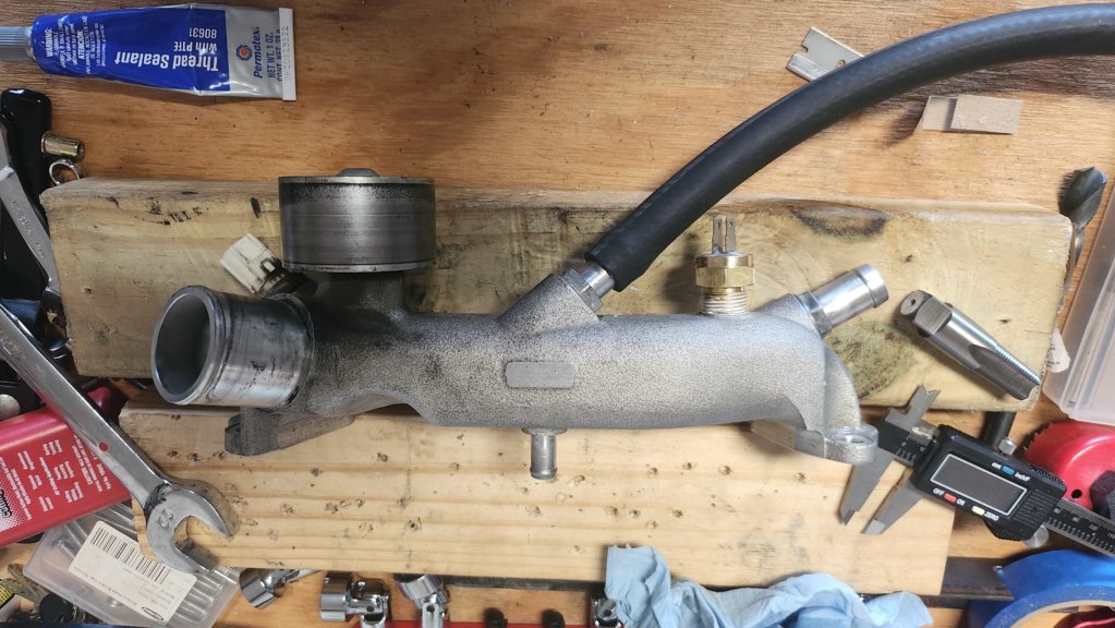

    Oil cooler lines deleted and coolant lines adjusted...thinking about taking that water-cross over pipe off and drilling/tapping that unused boss for my electric fan thermo switch. @Mdl , where did you mount your coolant temp sensor?

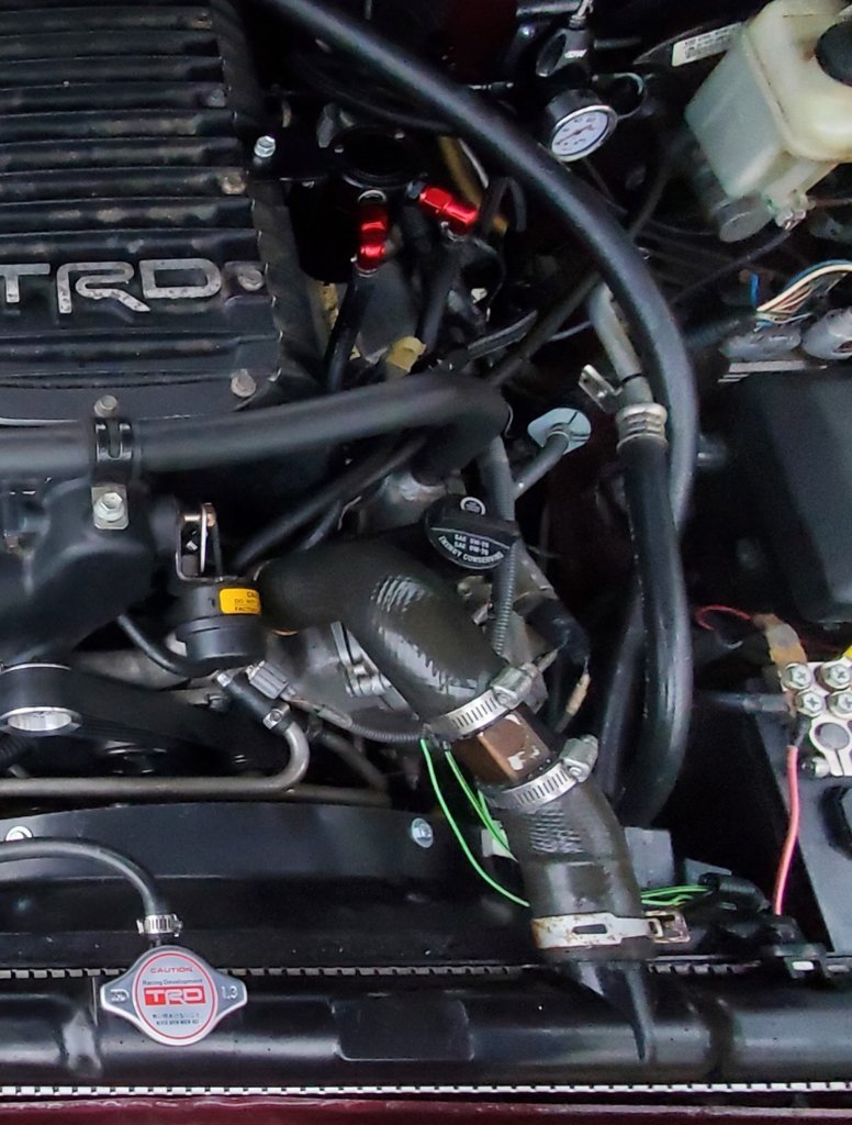

    Upper rad hose tapped to fit the 195 deg BMW thermostat. The 195 works great with the stock engine thermo. No short cycling of the e-fan. The cross over seems like a decent location. I got new silicone hoses and was thinking about a new spot.

    Thank you sir, I got a painless wiring switch that's on at 195, off at 185. I've already got the coolant drained, so I'm going to take off the crossover pipe and see if it's thick enough.

    That has been working great for me. Let me know how it goes before I hack up my new hose. Haha

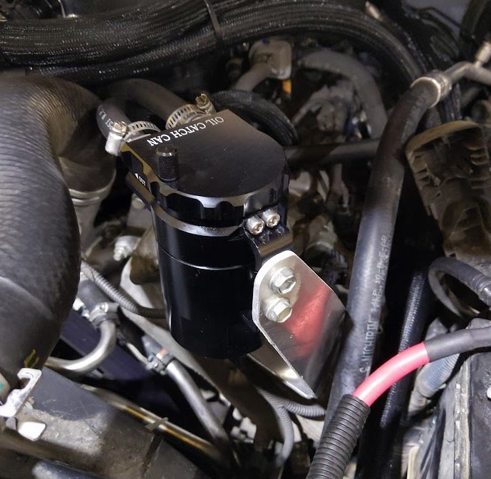

    Thanks! I'm going to go the Amazon route for one.
    Any good mounting locations? I saw on the J&L site they use a mount just to the right of the radiator.

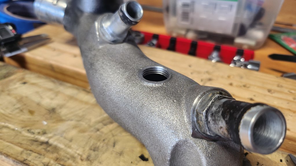

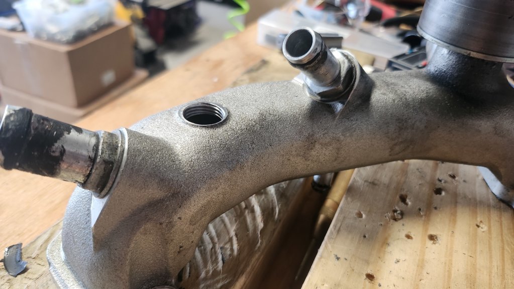

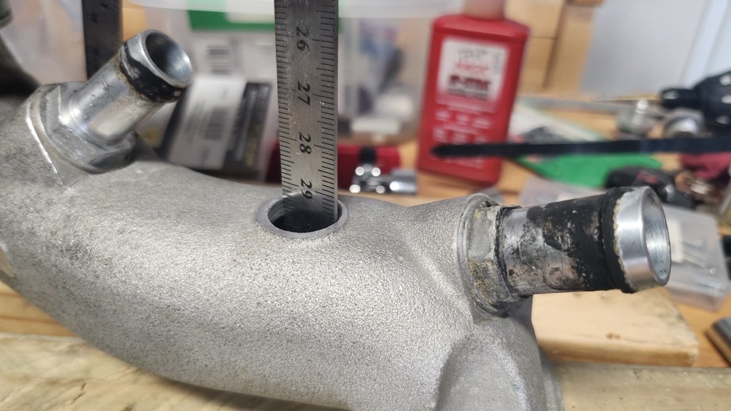

    Looks promising, this is drilled with the bit that came with the 3/8 npt tap. I will try tapping it later tonight.

    Not particularly, and depending on the blower, intake, and coolant reservoir there's spots that work better on some trucks than others.
    This spot was a little funky but ultimately in a spot not used for anything and gave good access to unscrew the can and was a bracket going to some unused tapped holes on the driver's valve cover.
    Pro speed "mounts" theirs off the passenger side top of the blower which actually isn't a bad spot. Where Radium mounts theirs next to the radiator is good but can be a bit tricky to unscrew. IMO the radium mounting bracket is the ONLY reason to get their catch can, and even then I think their bracket needs to be modified to actually be worthwhile. I'll make anyone a bracket to help them avoid the cost of the radium if that's what pushes someone to their can.

    I'd be down for buying a bracket if you have the time. I'm fine placing it wherever the hive-mind thinks is best for a Whipple setup.

    If you can make a drawing with some dimensions I can cut it on the plasma table and send it over for cheap. Will certainly beat the effort and looks of using an angle grinder to make something!

    I got a solid 3 threads out of the crossover pipe, sensor mounts solid and clears the coolant hose. Bottom of sensor is flush with the pipe housing.

    I'm switching over to an electric fan, this is the thermo switch that turns the fan on at 195 and off at 185. I just got the fan mounted, need to slap a plug on it and mount the radiator back in the truck. This fan looks so small compared to the stock clutch fan.
