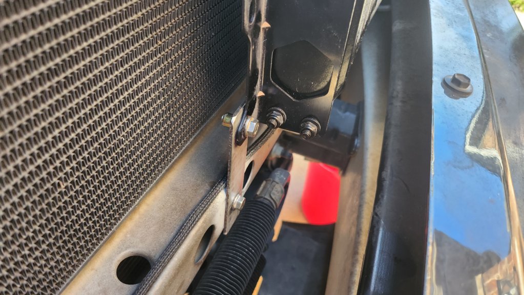

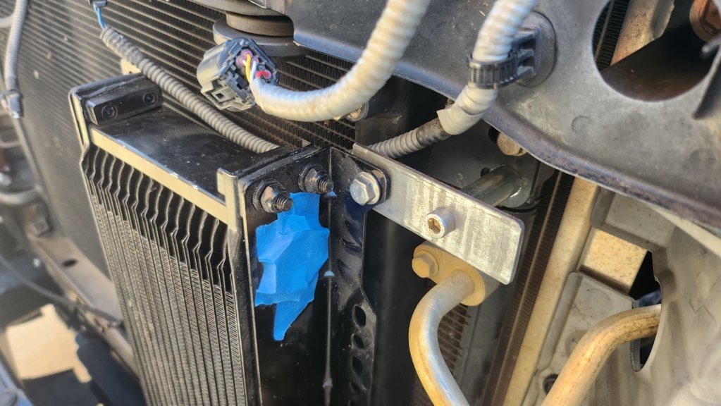

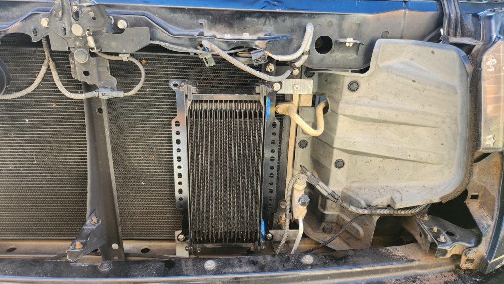

    Weather was nice today, so I started my Oil cooler project...first mounting option didn't work out, so I ended up with the solution below. It's pretty solid, but I still want another mounting point, need to trim the other pieces down an inch or so and paint them. After that, I can remove the stock oil cooler and get my remote filter mounted and lines made.

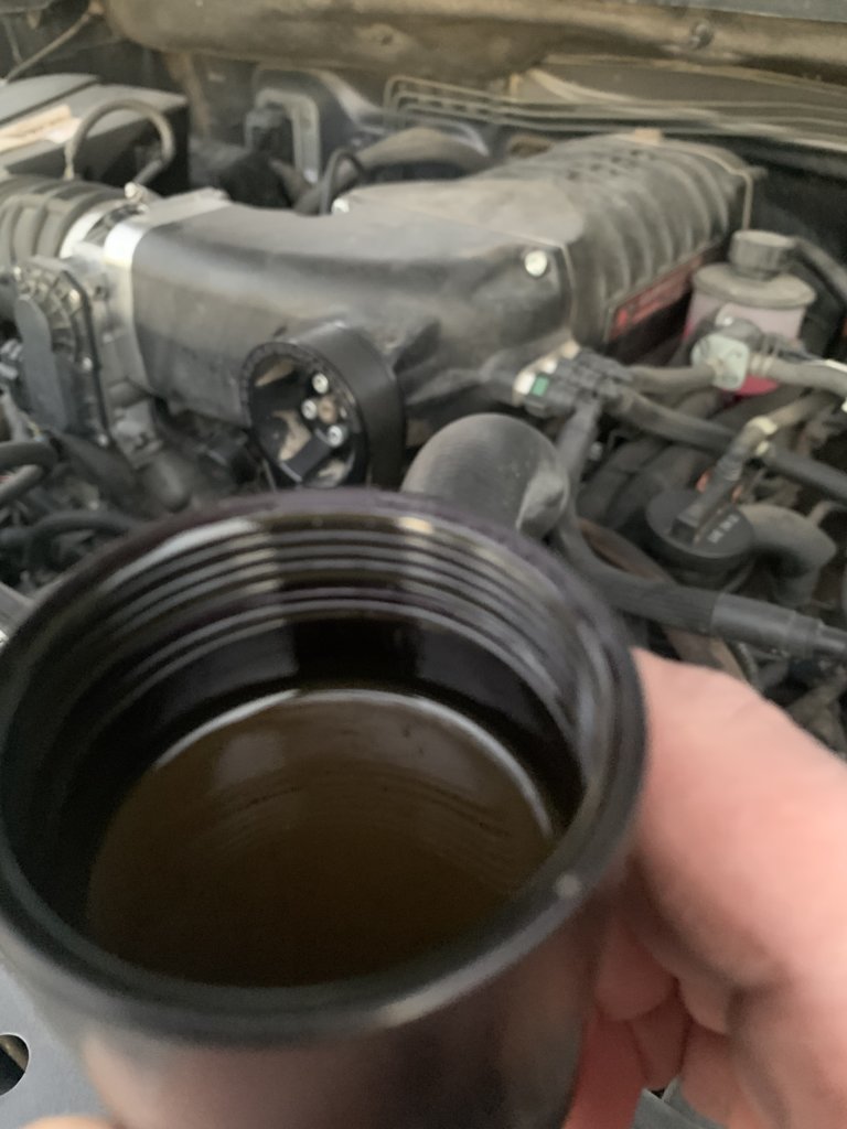

    Yeah I'm not sure I agree w the catch can. I've put 12k on my setup and have nothing in mine. Good PCV valve and you shouldn't have any blow by. I may have wasted the $260 on the radium catch can.

    The newer Radium design seems to let a lot by, the earlier design catches quite a bit. Not sure what the deal is, maybe they have a fix if you contact their support?

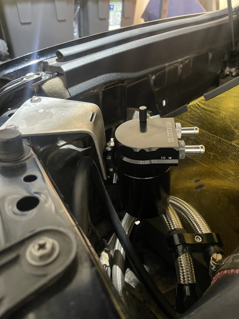

    Custom made mount @snivilous made for me since I wanted it in this spot since moving my window washer tank. Don’t think it’ll fit if the tanks not moved.

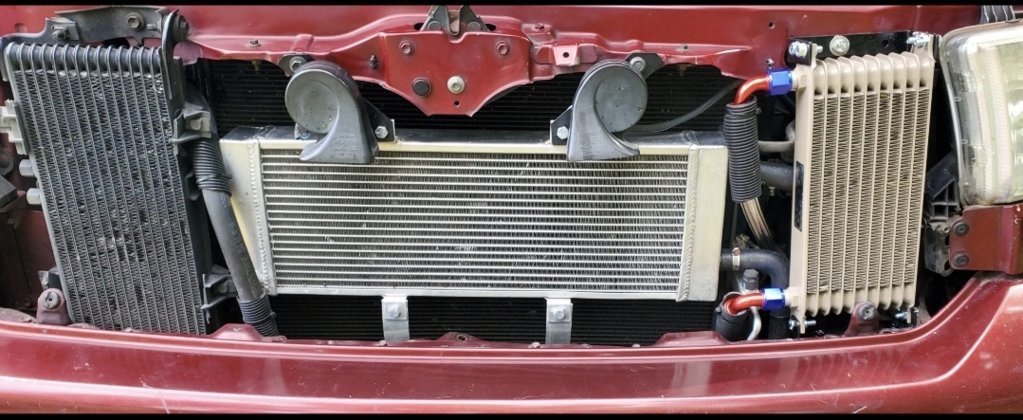

    When I deleted the transmission coolant puck and thermostat my trans stayed at 150-160 deg. I installed the Derale thermostat and it kept my trans temp at 190deg. That's where I wanted it at for longevity.
    The engine cooler was cheap $75 ebay find. Black would of been better.
