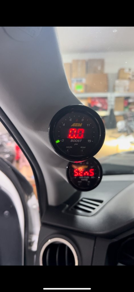

    Mpvi is different than what’s included. I run the AEM gauge no issues. Here’s the pillar mount for reference in his truck. I run the steering setup

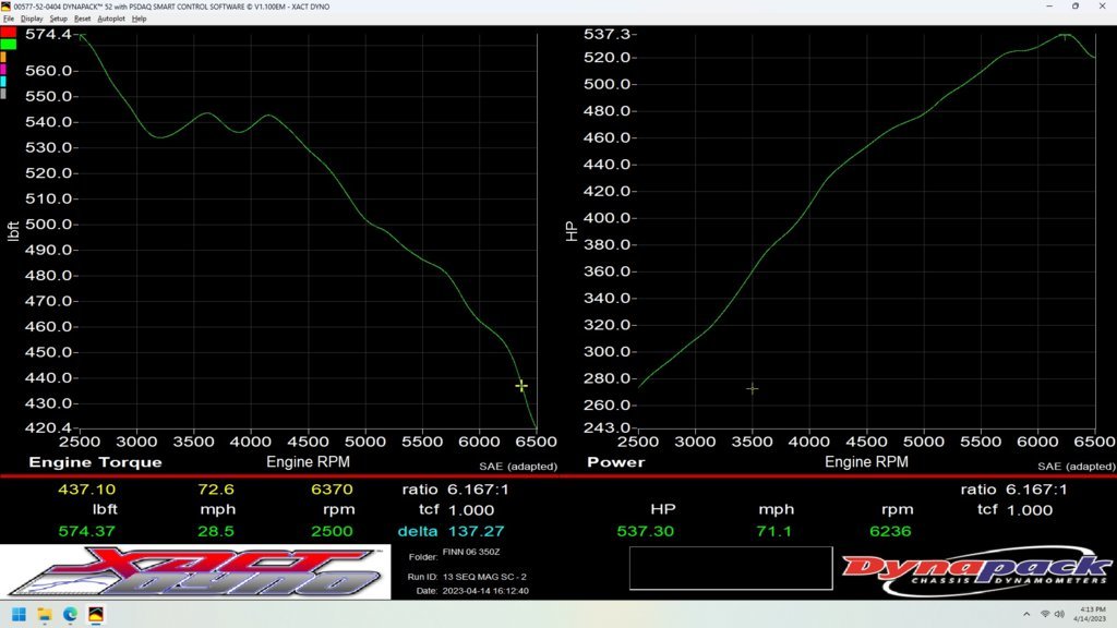

    I had 2 450s bought from Walbro because counterfeits fail & no support from Walbro. Currently I have 5-0 650s running at 60 lbs on the 340 with a 2.299213 pulley and RCF TB, my Tree runs amazingly thanks to the sniv magic tune!
    This was before the TB, SPD highflow cats, and the sniv tune.

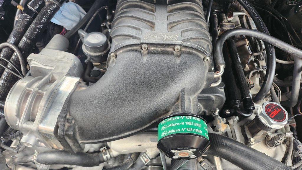

    I got another belt, this one is 9/16" shorter than the previous belt (K081196HD).
    K081189HD is perfect for Harrop 77.5mm pulley on spacers, tight but not difficult to get on.
