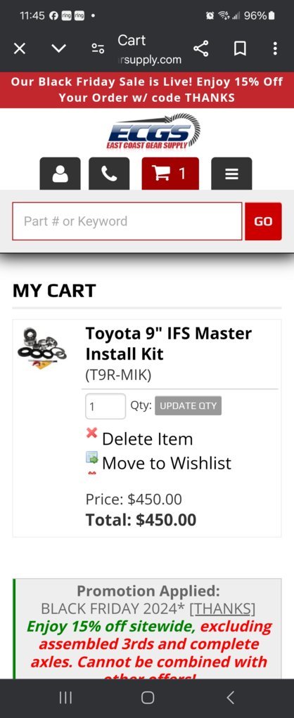

    FYI ECGS has 15% off. I'm still searching for the front master kit as well as a LSD.

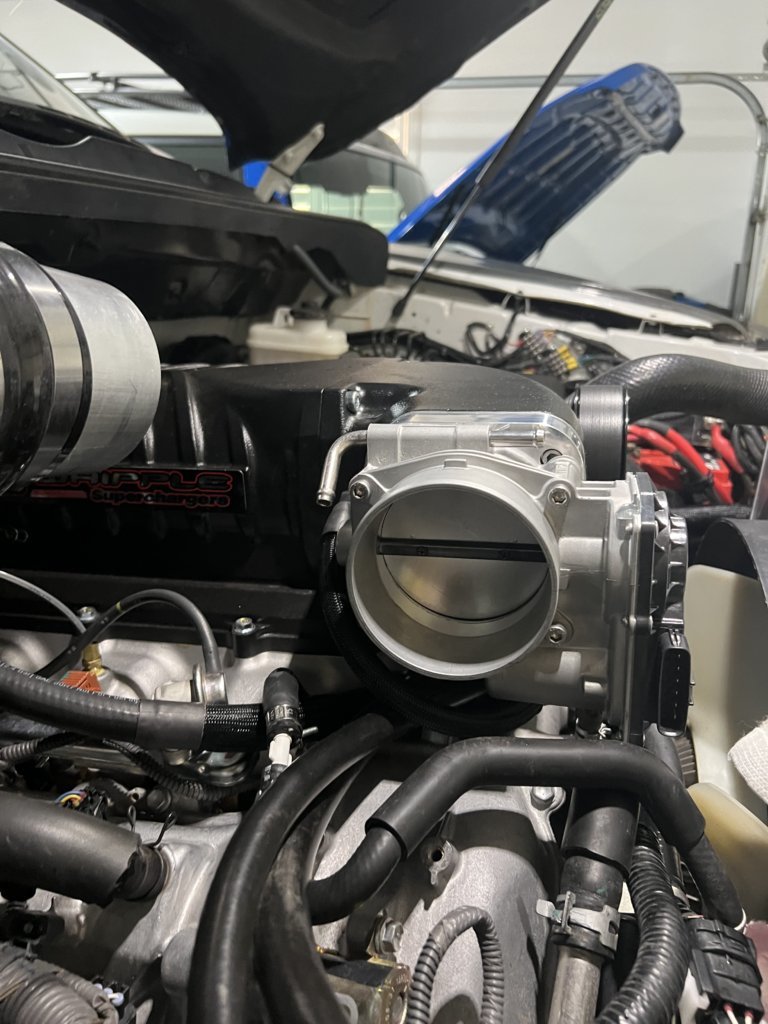

    You could also the rcf throttle body as well while you’re in there. This his setup.

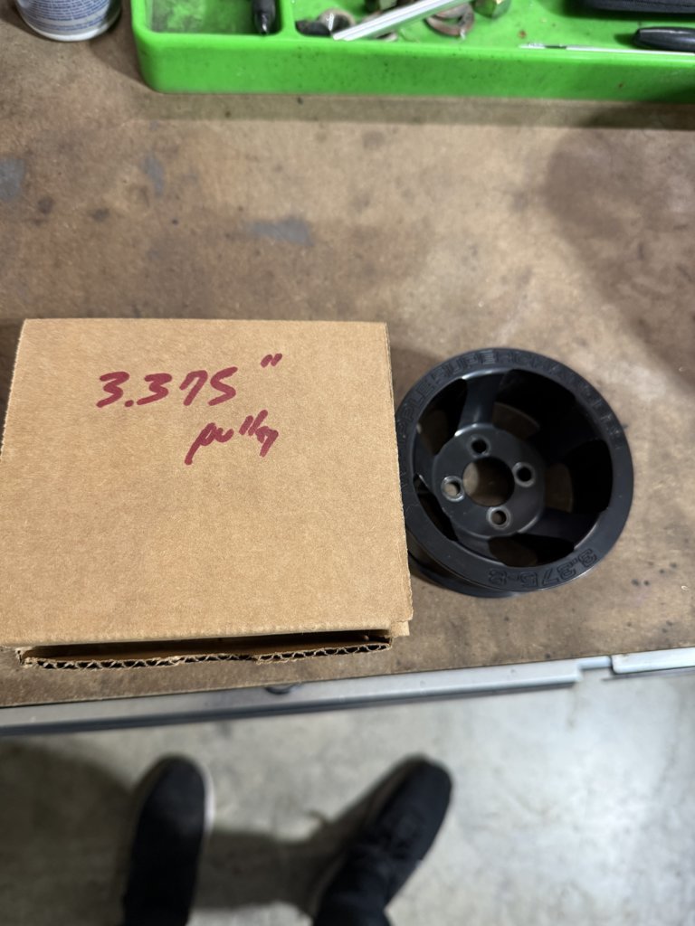

    Whipple kit comes with 650cc injectors also so those are good to go. Recap if it were me while it’s apart lol
    450pump
    Afr gauge
    Rcf and adapter
    Maggy box
    Tune
    Smaller pulley- I probably have one laying around lol

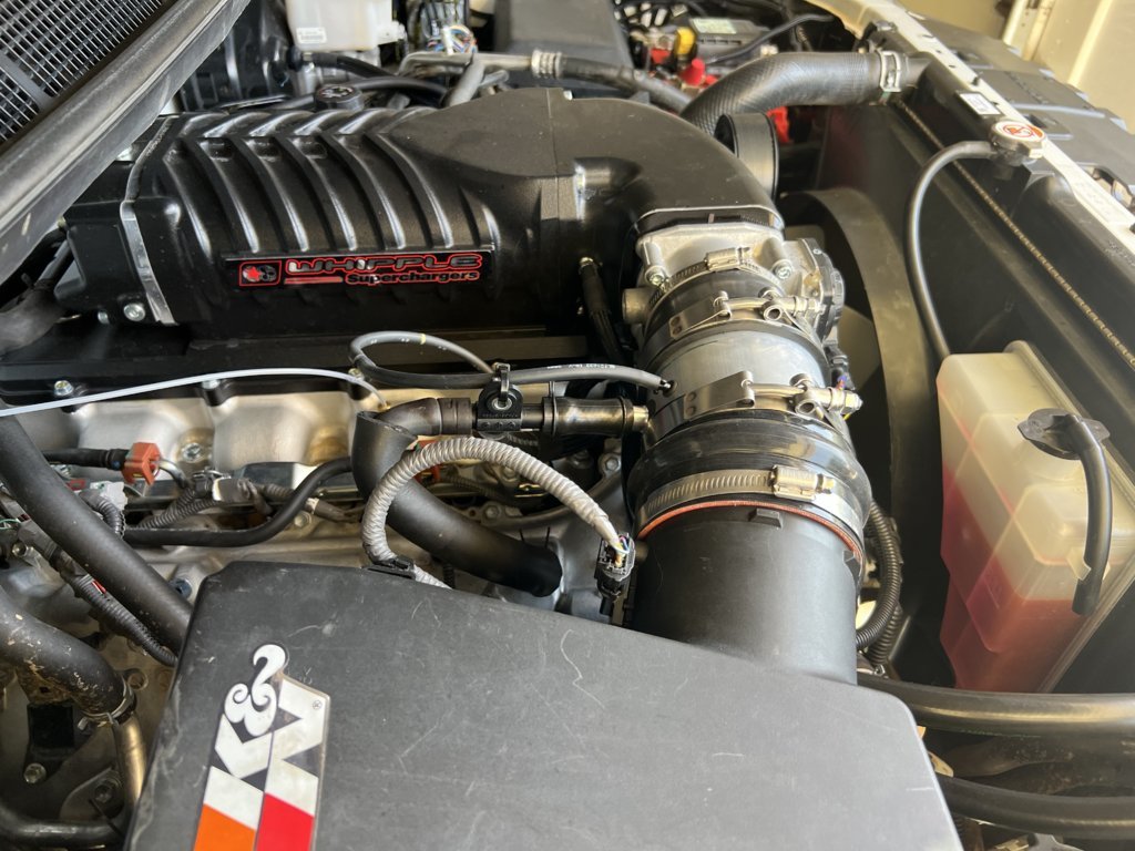

    @Danimal86 - except for the 450 fuel pump, this is the setup I am running. It works very well and I'm happy with the power levels and reliability.
