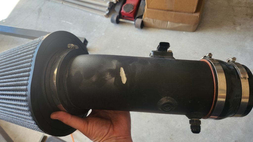

    So, maybe I spoke too soon about the spacers putting my intake in a better spot...the top is getting sawed through by the ProSpeed box cover, should be an easy fix, I just need to modify the box cover. But what I really need is to put on that other snout and make a new intake. It was hard to get a picture, but there's a pretty good chunk taken out of it, probably half the thickness of the tube wall.
    Mdl and reywcms like this.

    ow
    Speaking of glitches, my catch can has been getting progressively more "smokey" In N Out opened 2 blocks from my house Thursday, I sat in the drive through for 45!!! MINUTES & had smoke billowing from under the truck (where the filter somehow sent the smoke).
    Any idea on mitigating that?

    Modded my lid awhile go since it does this with the outstanding design of Prospeed lol
    Mdl and armyoffoo[QUOTED] like this.

    Maybe a new PCV valve would help, generally more smoke means more blow-by so could be a number of things, valve seals, valve seats...rings
    HulkSmurf14 and Mdl like this.

    Yeah, since the kids are out of school next week, I might just get the new snout installed and start on the intake...I plan to put the element (or most of it) into the inner fender a la ViktorG-style, so I'll be ditching the hot box.
    j_supra, reywcms[QUOTED] and Mdl like this.

    That escalated quickly.
    I'll start with the valve (which is about 18 months old.

    The Pro speed catch can is vented to the atmosphere where most are a sealed unit. I believe the new Pro speed catch system recirculates all gases.
    e30cabrio[QUOTED] likes this.

    Yeah, unfortunately, smoke is usually a bad sign...steam from condensation is a different thing, but that usually burns off once the engine gets up to temp. Maybe the filter is saturated and dripping onto something? Still wouldn't be good to be saturated either though.

    I got it from Rey, not sure which can it is.
    Here's what it's doing.
    https://vimeo.com/manage/videos/1032719480

    Steam it did that in the winter here
    Mdl and e30cabrio like this.

    It's 60 degrees at night right now.

    Yeah, I think you're fine, just like you exhaling "smoke" when it's cold enough it's just warm air in a cold environment, nothing to worry about.

    Thanks!

    Sorry for the concern, when you said billowing I pictured Uncle Buck's ride...my bad.

    With a car behind me with its lights on in the line, it seemed billowy lol
    I don't get how it exits under the truck
