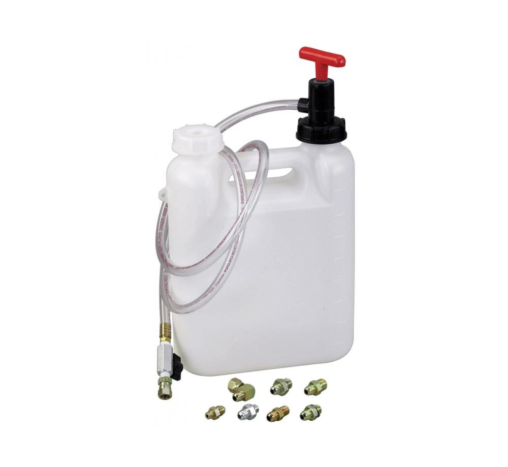

    I tried with one of those pumps that fits on the bottle, and gave up...bought one of these and it's a life saver, and not a wallet-breaker. I put in 1 qt at a time and marked the line on the outside of the container so I know how much goes in.
    https://www.summitracing.com/parts/mvp-1735

    I have that one too!
    I am ready for a trans flush & prefer to have a trans dedicated filler to be certain nothing else gets in there, thinking the 35-dollar deal is the way to go.

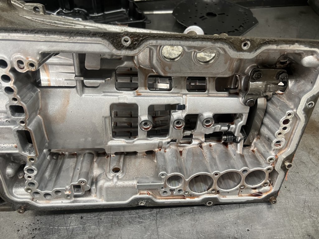

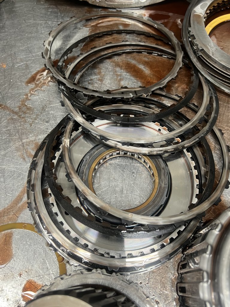

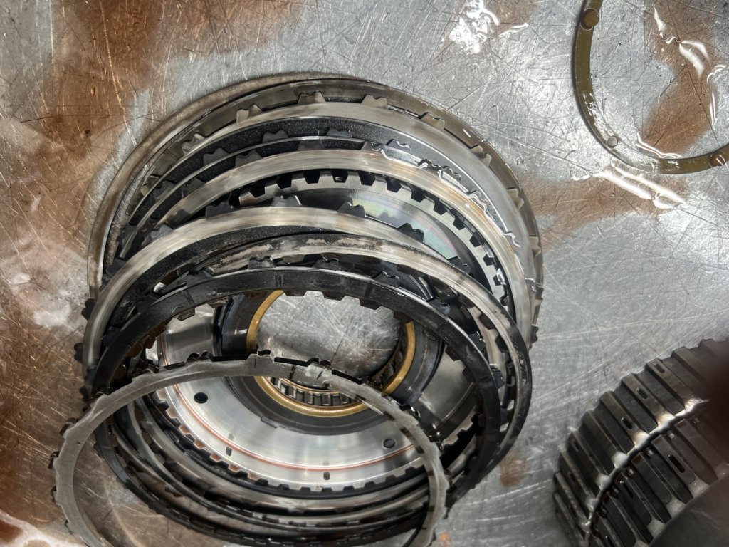

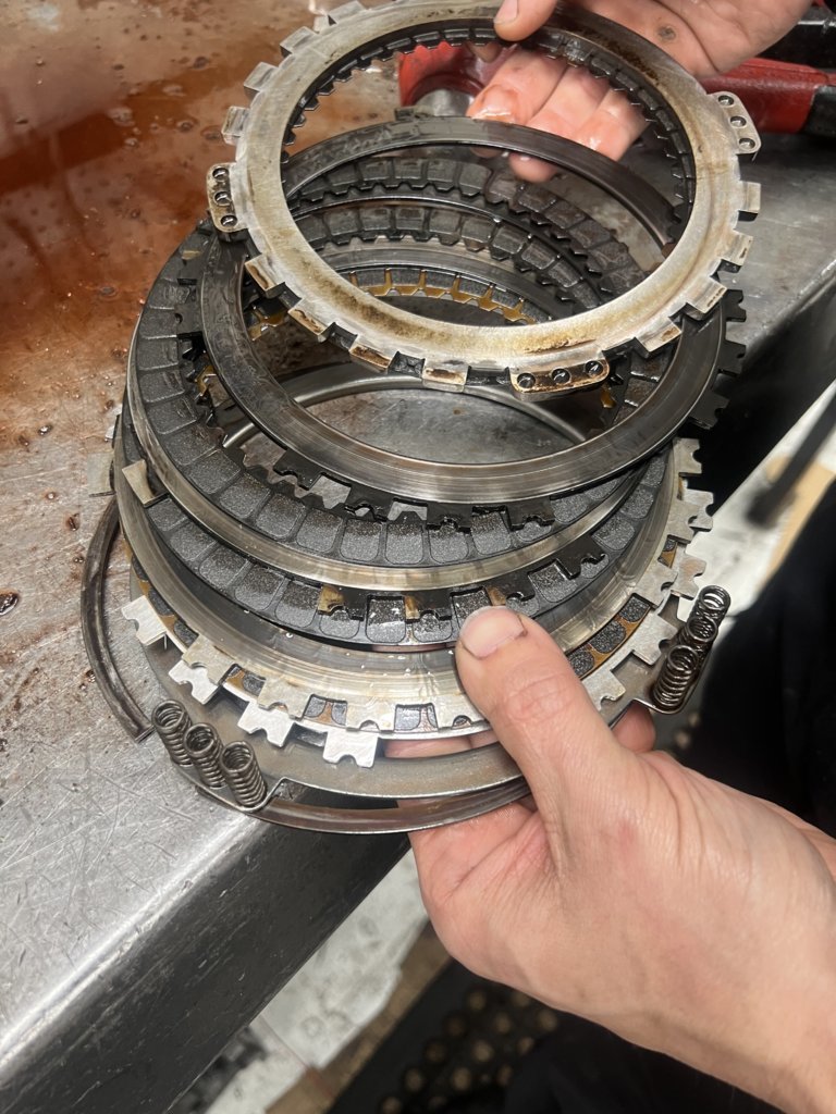

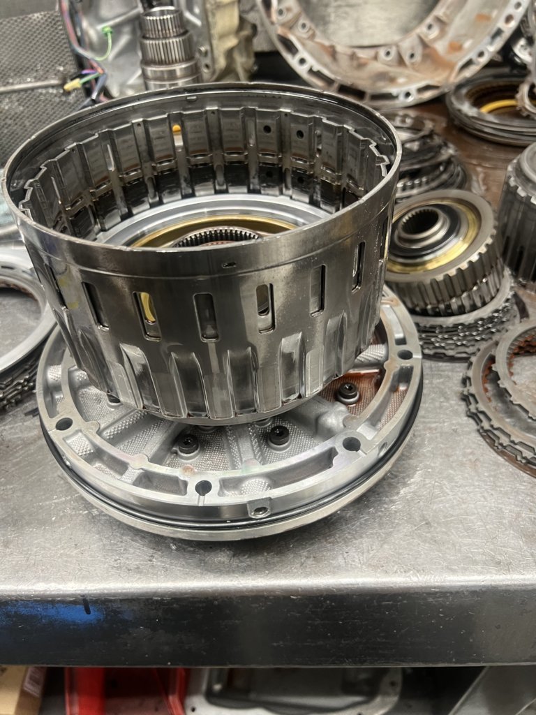

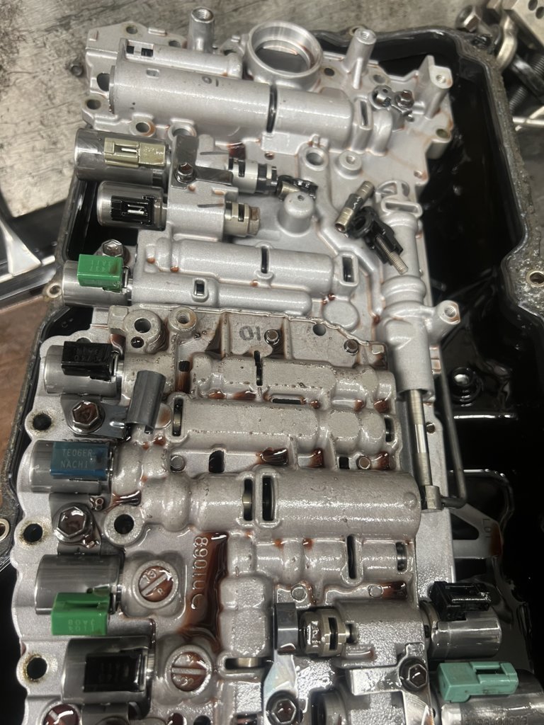

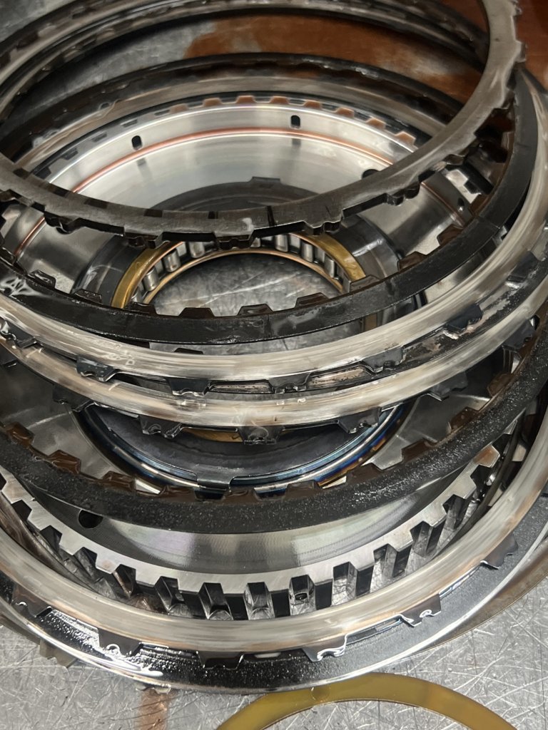

    Ok so first round of pics are back from level10 on my stock trans. Here they are. I’m no transmission expert.

    A little C1 slippage and burnt.

    C1 is for 1st gear? Making a wild guess there, but it makes sense lol.

    C1/C4 are engaged 1-2-3-4 but I could be backwards for C4 looking at it. C1/C4 both connect to input shaft and intermediate shaft.
    Just found the general ab60 pdf.

    Most of them look pretty bare, with little clutch material left, except for the pack the second to last pic.

    yup you can see the burn

    Those should be for 5-6. They are tearing into it quickly. What's the turnaround eta?
