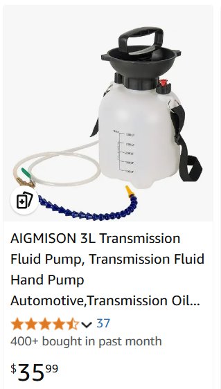

    so does everyone use a pump to fill or drain?
    im trying to see if a can driveway change like an oil change or have to take it in
  21. Nov 19, 2024 at 6:56 PM

    I use a cheap oil pump from the auto parts store. Like one of these...

    Drain it from the drain plug. Remove the fill plug on the side of the trans. Run a hose from engine bay to side hole, attach a funnel to holes and fill. Very easy.

    This is also how I refill the transmission. I have a hose with rag bits stuffed in either end to keep from getting dusty or dirty that I only use for this procedure. The rag bits also keep fluid from dripping out when it is stored and when you are snaking down the side of the engine bay. Just pull the rag and make a 90 degree turn in to the fill port. I’d also recommend a hose clamp and/or second set of hands to hold the funnel on to the tubing when dumping fluid in to the funnel.
    This has worked exceptionally well for me.

    The old style official Toyota fill tool which is an OTC 6492. It wasn’t exactly cheap when I bought it years ago, but it is a ridiculous amount of money these days.

    nice i have one of those. maybe ill get a nee one just for this.
    whats the fluid amount?

    I have one of these...I use only for Trans fluid.
    when I do Drain & Fills...I usually drain ~4qts...put back in 5qts.
    level it out with the check valve trickle dance.
    after the first time....it's just too easy not to do it.
