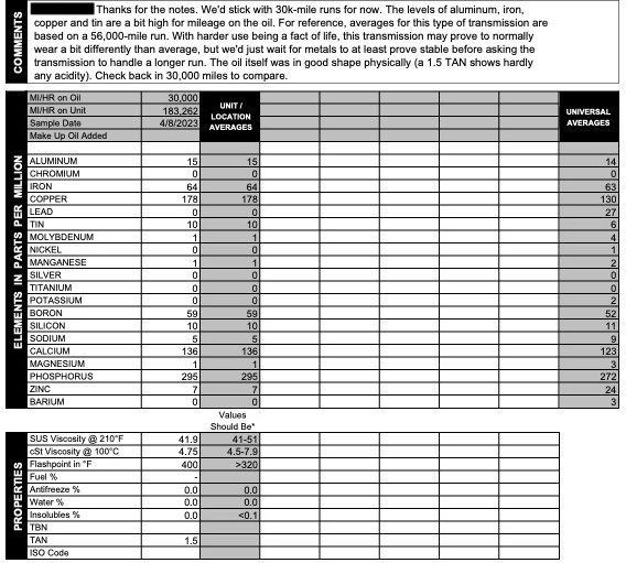

    For those that have had transmission fail.. @Ponderosa_Pine @Mdl @carn_dogg @reywcms I'm curious to know what your transmission fluid maintenance schedule looked like? I've been very good at ~30k mile drain and fills and am hoping that will pay off.
    Also, has anybody done UOA on their transmission fluid? I had one done through Blackstone Labs at 183k before getting serious about installing a SC to try and get a glimpse of the transmission health. I'd be happy to post it, but the gist of it was: oil itself was in great shape, wear metals were a bit high for the mileage. Curious to compare notes if anybody else has done lab work. I should have sent another sample in when I performed the last D&F a month or so ago but was in a hurry. Oh well.
    Wynnded, bflooks, e30cabrio and 2 others like this.

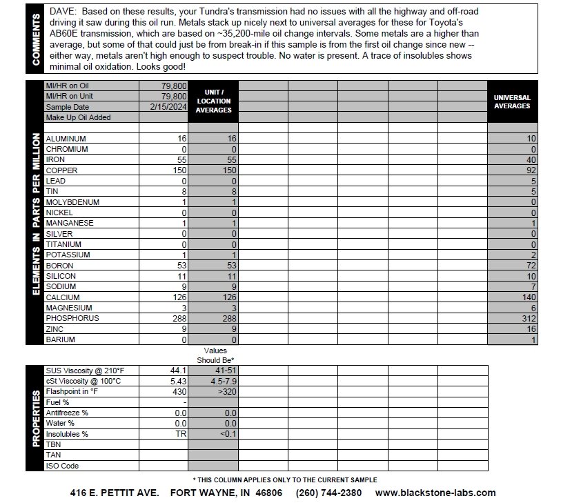

    I did one at 79k about 1000 miles after I put the supercharger on. First time it had been changed as far as I know.

    Your guy says its based on 56000 mile intervals and mine says its 35,200, and the universal averages are way different. Gonna be hard to judge what's good or bad if the target is always moving

    Ya, I noticed that as well. I wonder if they break it out by generations and run different averages for Gen 2 vs Gen 2.5. We can focus on fluid properties and wear metals, I suppose. I'm surprised to see the wear metals so close considering the large discrepancy in mileage between the two vehicles. Hopefully that means they are both wearing well? Or being abused equally...
