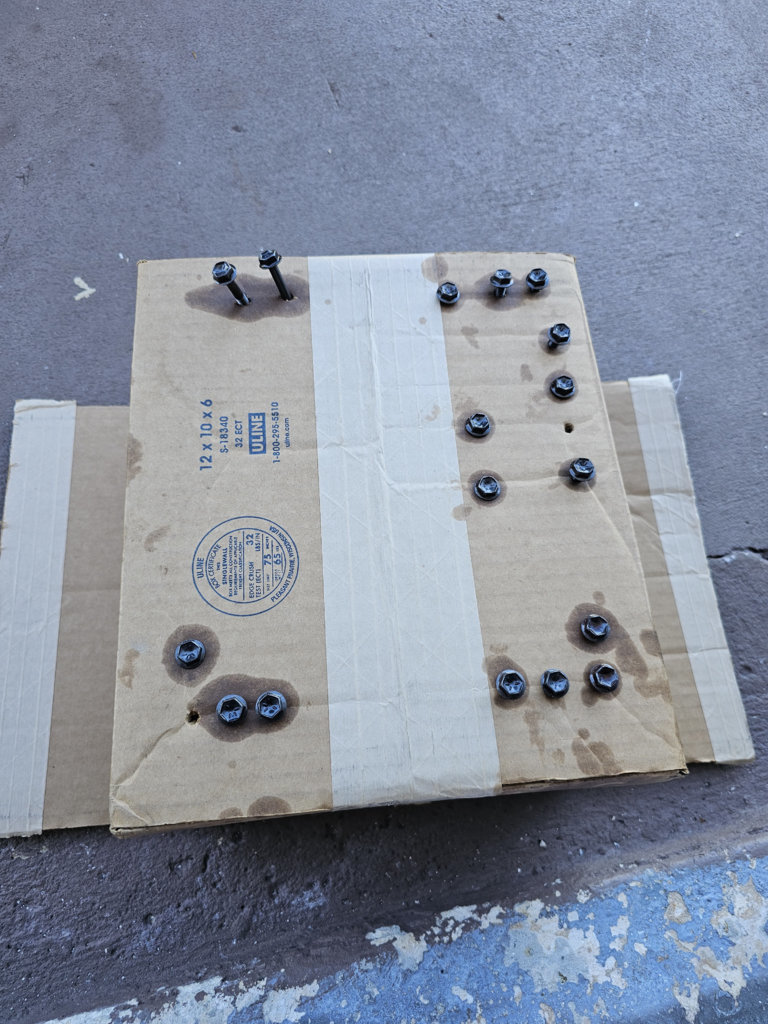

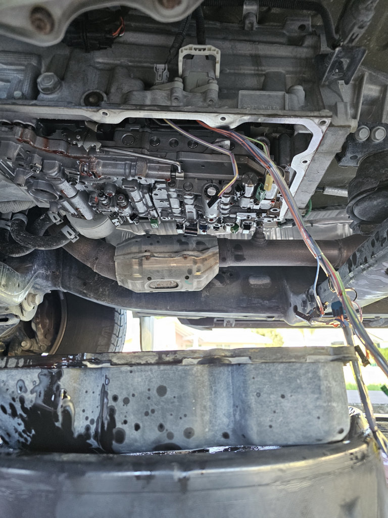

    Be ready to catch the check ball spring and accumulators/springs. I just layer the bolts and temp on a clean towel as I took them out. Accumulator side will want to pop down.

    I took the OEM truck jack and secured a piece of wood to it. This way I was able to drop it down slowly so could catch the accumulator and spring, also the check bal and spring.

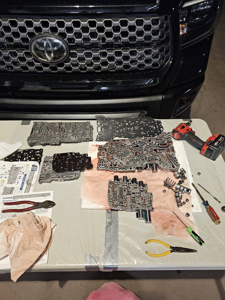

    Well, the kit is all in. If you follow the instructions and go step by step, it's a piece of cake. Make to more mock up for the valvebody screws so everything goes back in where it belongs. Break time now, again.
    By they way, 1 of the replaced parts was starting to get some wear.

    Well, it's in and it runs fine. I ain't going to lie, I was shitting bricks putting all back in. The kit itself is a walk in the park. Instructions are easy to read and the pictures are spot on. I will say I did find an error on the bolt size and the color code part. One set of bolts was labeled 25mm in red and 30mm in green, should be the other way around. My OCD ass triple and quadruple checked all the check balls, which didn't need to be replaced because from factory they aren't metal, and made sure all the plugs that I replaced were secure with their clips. One of the 4 accumulator pistons is a pain since it doesn't stay in place like the other 3, all thought the metal one does fall out, a bit of grease keeps it in place. The spring and check ball that goes in the case kept falling out since the grease only gave you so much time to work. I measured about 8-8.5 quarts that came out total. I still have to do a fluid level check. Also switched over to Valvoline Maxlife. When I was putting away the old parts, I noticed another part that was showing slight wear on it. I am at 47k miles, so wear does happen early on. Guess that's why those 2 parts that had wear are replaced with better ones.
    Now as for the shifting. No noticeable difference to speak of. If there is, it's minor. I wasn't expecting anything, though, since what I think makes it shift better are the replacement of the springs in the 3 accumulator pistons. From the research I have done, the kit replaces problem parts for better ones and the actual better shifts come from the springs. I also added a high pressure Sonnax valve since the kit comes with a standard one. So, basically I just improved the longevity of the trans by replacing know failure parts.
    Time wise. I started at 3pm and just finished now at 1am.

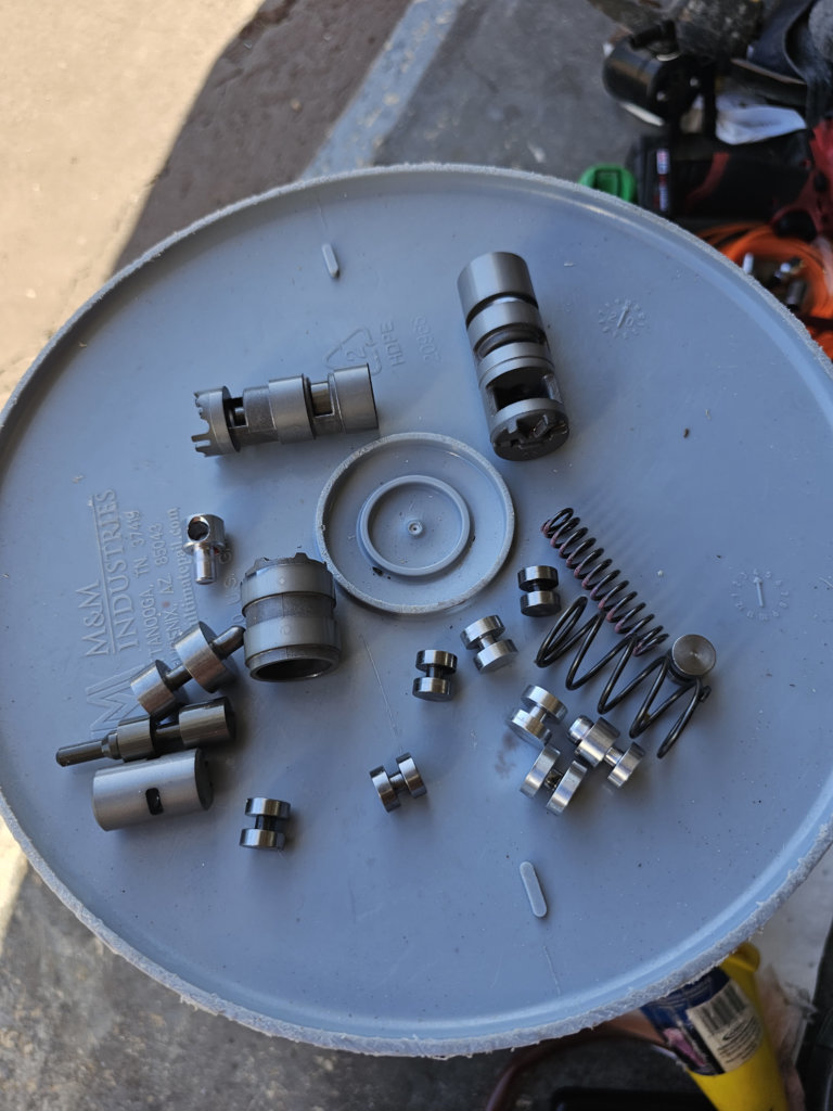

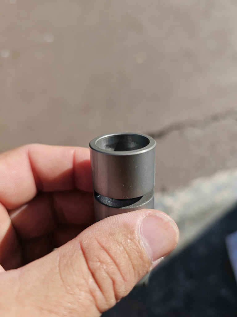

    These are all the parts replaced. The 2nd pic is one of the parts that had some wear. That one is the B1 accumulator pistons. The updated one brings an O-ring and extra grooves for better lunrication. Cures delayed engagement, burnt clutches, forward slip &flare shifts. 3rd pic is the boost valve. That one I replaced with a high pressure one. That valve is explained here. https://www.sonnax.com/parts/4452-line-pressure-booster-kit
    The little plugs are now O-ring based for better seal. Here's all the info on the kit. https://www.sonnax.com/units/34-ab60e

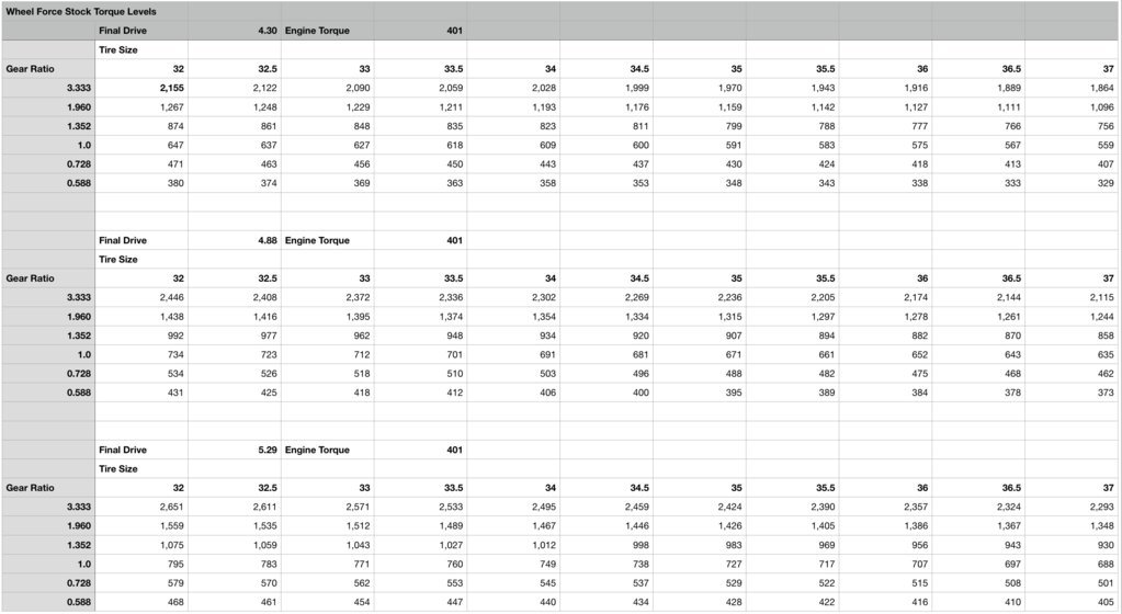

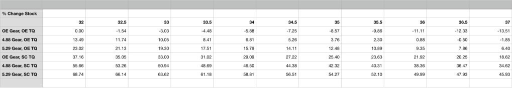

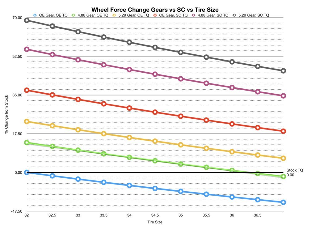

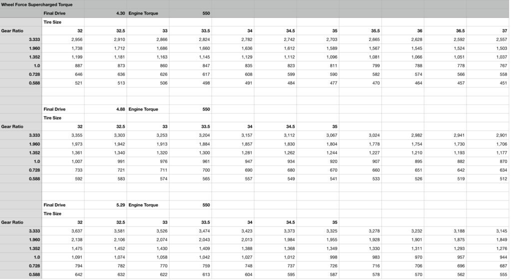

    So I decided to calculate some data: Wheel Force (kinda like wheel torque, but calculated at one wheel) for OE Torque vs Supercharger Torque vs Tire size. Might cross post this on a few other threads, but maybe not. Then I made a chart, cuz those can be helpful. Hopefully...
