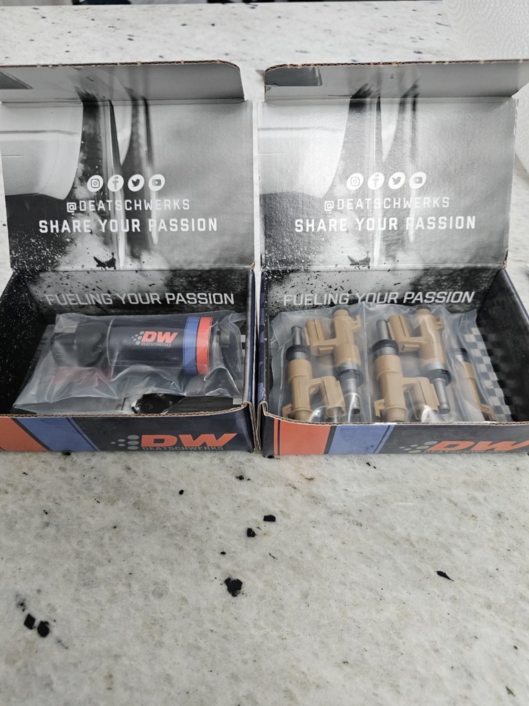

  9. Oct 5, 2024 at 9:18 PM
    pursuit2550
    pursuit2550 New Member
    Jul 29, 2020
    #50029
    2,279
    Florida
