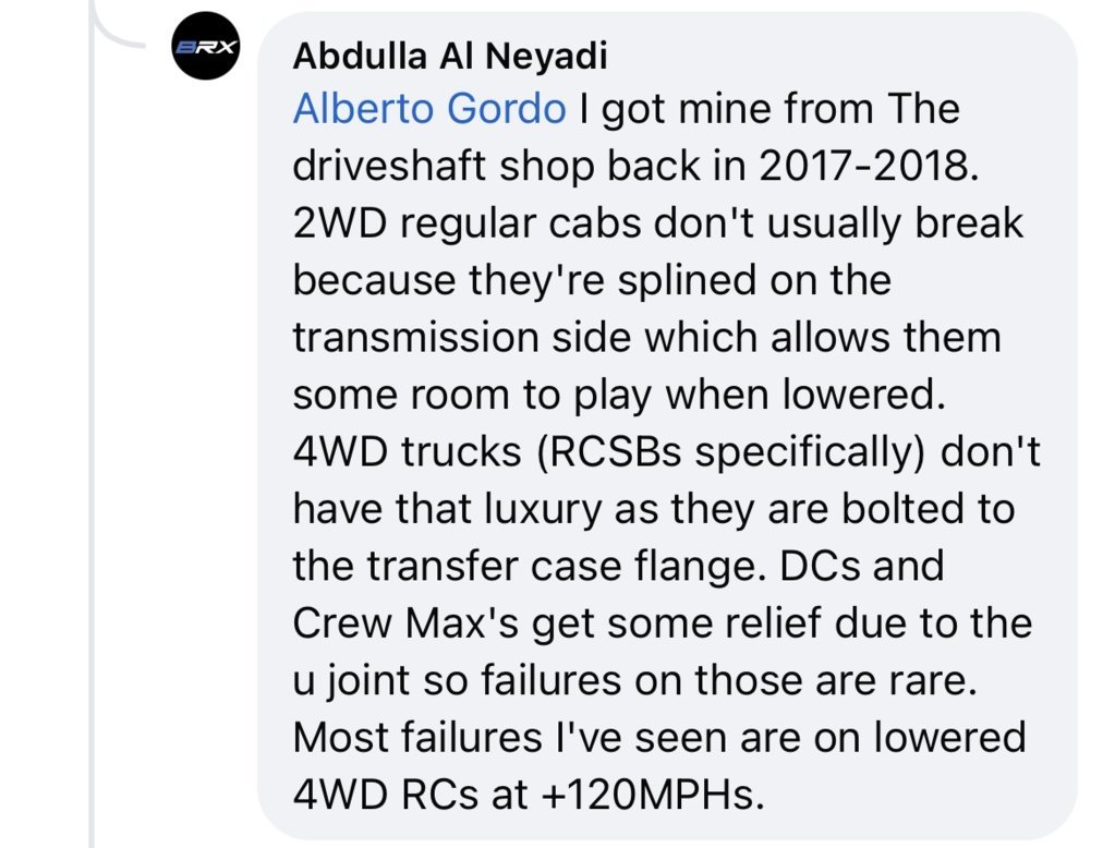

    Funny, I was just looking at some info from Tom Woods driveshaft the other day; they noted that they don't balance shafts past 3200 RPM or so because that's as fast as their machine spins. Curious, I decided to do some math and figure out driveshaft speed with my stock tire size and factory gears as it's not uncommon for highway passing speeds to reach 95 MPH... or more...
    70 MPH is almost 3200 driveshaft RPM.
    95 MPH is almost 4300 driveshaft RPM.
    120 MPH is over 5400 driveshaft RPM!!
    And for the 5.13 crowd, 120 MPH would be almost 6500 driveshaft RPM...
    Eeegatts!

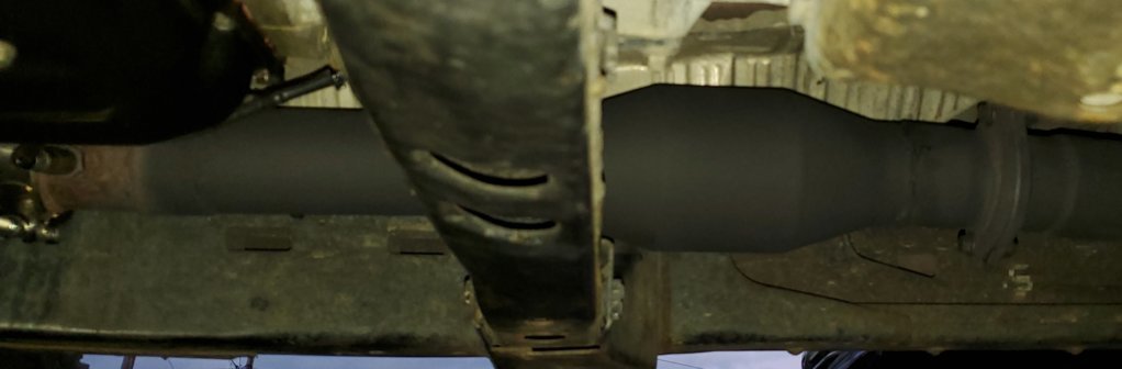

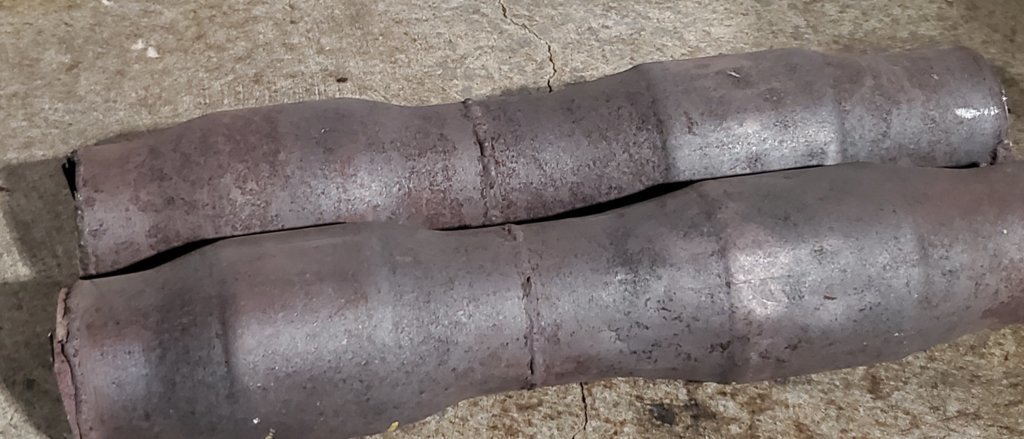

    Last week I got rid of my mid pipe setup that had one gutted cat and a 200 cell metal cat. I wanted to get the gutted cat out of there and have a nice straight 3 inch to the new heavy material 400 cell cat. After seeing the video's about velocity and keeping things flowing after the collector I wanted to put the cat a the end of the midpipe. Glad I did as one of the metal cats was buggered up. At least the fuel smell is gone. Quieted it down a little at idle but still roars when on it. Oh and I ditched the BBQ paint for some rustoleum high heat ceramic paint. Haha:rolleyes: someday stainless but what I got works...
    It's held up well for the past 12years.

    what size exhaust are you running?
  24. Sep 30, 2024 at 4:12 PM
    Mdl
    Mdl Hey there...
    Jun 14, 2023
    #98638
    3,520
    PNW, WA
    2007 TRD SC'd
    JBA Longtubes, Snivs 2.0 SC pulley, ASP crank overdrive pulley 6.71 in, DD Full 3inch dual exhaust, IPT valve body, Airbox mod, 4.5inch intake, Denso 750, 450 Walbro, W/M injection, GM 95mm TB, SABM, Camburg UCA, Icon shocks, Speedmaster LSD, Motive 5.29 Gears, Mickey Thompson Baja Legend EXP 35's, Solid Offroad engine and transmission mounts, DIY Traction Bars, Tuning by Snivspeedshop.com
    JBA LT's 1 7/8 collectors. 3 inch true duals with x-pipe. One of DD's first creations for the Tundra.
