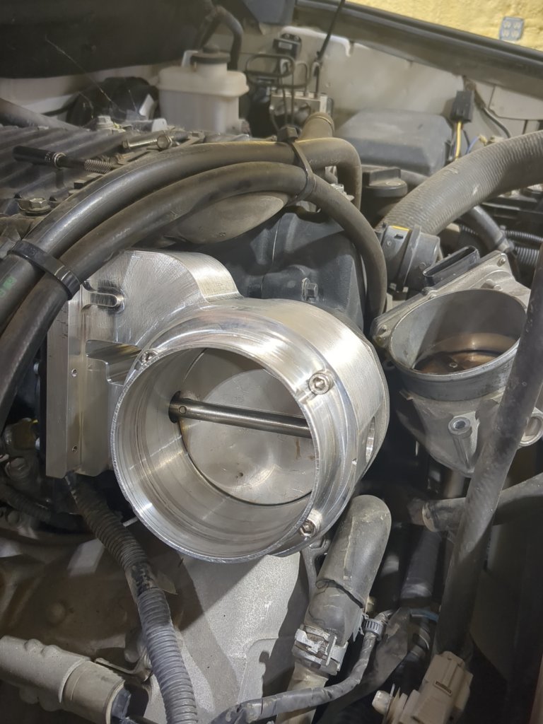

    Been a process figuring out how to put it together. Some post machining, some sanding, breaking parts, plasma cutting new throttle blades, but it seems to work! The idle is surging bad, I'm on my second throttle blade and evidently it's still not sealing well enough so will have to try making another, but it did respond to throttle inputs which is a win!

    What's the gap? On that 103mm TB I had I was able to move one of the plastic gears and closed it up. Awesome that you got it going!

    Right now is maybe .020" in a couple spots. It's not a matter of closing the blade more, just getting a consistently round blade that fits correctly.

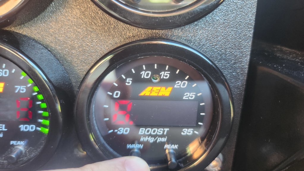

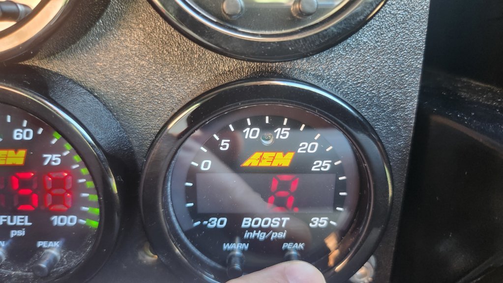

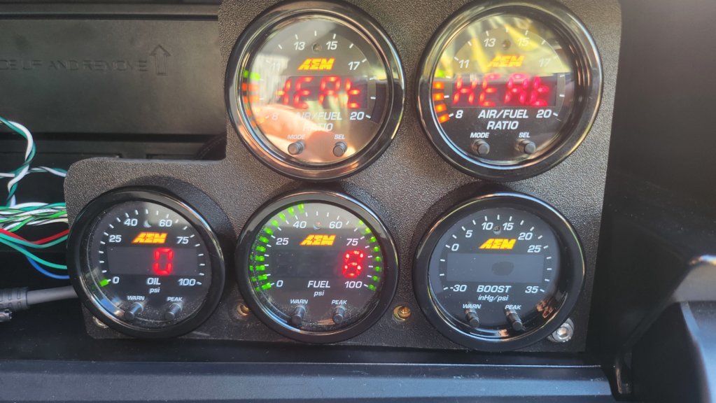

    I got my replacement boost gauge from AEM...and it's DOA...been dealing with trying to get a boost log since I started tuning with @snivilous back in April...now I get to deal with another RMA.

    Weird- that's annoying. Did you replace harness etc?

    I did, I rewired with the harness with the new wiring they sent with the replacement gauge. I had to take the glovebox out to remove the gauge, so I took the time to shorten the wiring and make the gauge cluster removable. I also tested with another harness I have, only power and ground, not much to mess up.

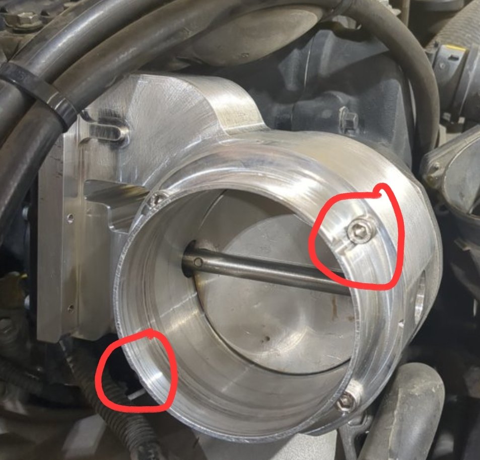

    Did you have any excess air from these 2 spots for the TB bolts that maybe arent sealing with the coupler? Try fill/smooth with some rtv to ensure no excess air gets in. You know I'm the king of airleaks...

    I was worried about that too, but the coupler I'm using is thick and compliant enough it seems to fully seal those pockets. This was proven yesterday when the throttle blade I coated with RTV just to experiment with worked well enough that the truck couldn't start since there was no airflow. That super tweaked throttle blade I got to work well enough to drive around, but the truck didn't like it and kept throwing stuck open or stuck closed errors so now waiting on the new laser cut blades.

    Did you try the harness before cutting it up?

    No, but I used my fuel pressure gauge to verify the boost wiring worked, and vise versa I plugged the boost gauge into the fuel pressure wiring connector and got the same result. I also did continuity testing on the wires from the deutsch connectors to the gauge connectors.

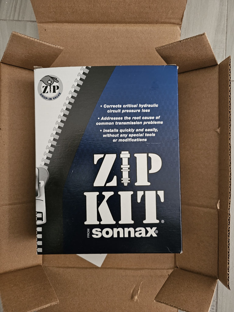

    Finally after 4 months of waiting.

    Nice! Are those just upgraded accumulators and not over sized? No drilling out the ports? Cool to see if you notice firmer lockups over the stock ones.
