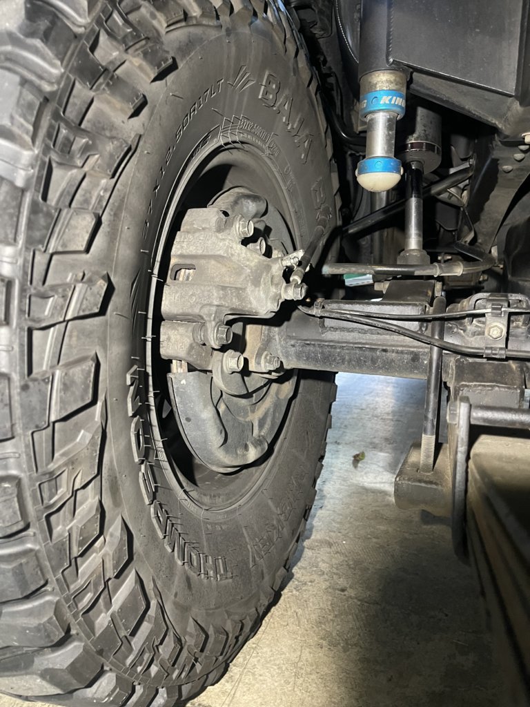

    Here’s the difference in rears lol

    You beat me to it! Ya, it’s no joke. OE brakes are awesome for OE brakes. But they don’t hold a candle to those Alcons.
