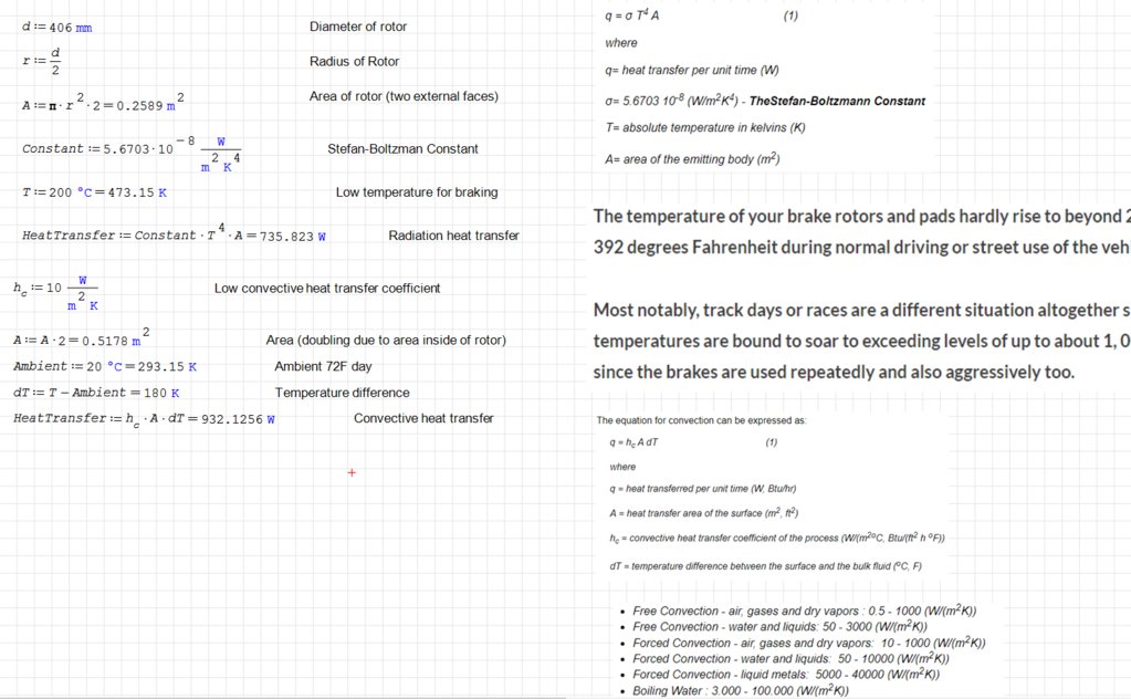

    I'm no thermodynamicist but I thought in most applications radiation played a very small role in heat transfer. And to back that up, if what he is saying is true then no one would give a shit about internal cooling vanes OR would brake cooling ducts on performance cars exist.
    Now whether it makes a difference to you, that's a different story. But my gut tells me that's all bullshit.

    I don’t have time to study brake thermodynamics, so I asked AI for you all as a public service.
    Primary heat dissipation mechanism for rotors is convection, secondary is radiation, followed by conduction. It gave a nerdier answer but I’ll spare the unnecessary details.

    I never took heat transfer, but the equations seem straight forward. Some quick and simple math points to convection doing more with mild braking, and that's using the absolute lowest value from the convection value table this website had, and it's a linear change with the convection constant, if you used the tables value of 1000W/m^2*K instead of 10, then convection absolutely stomps radiation even at extremely high temperatures.

    So can someone break this down for my knuckle dragging ass?
    Directional rotors can not be run on the incorrect side or heat shedding won't occur.
    Or the calculations say it's not gonna make much difference?
    For sake of argument, let's assume over sized tires will be the only different variable from factory.
    No NASCAR situations.

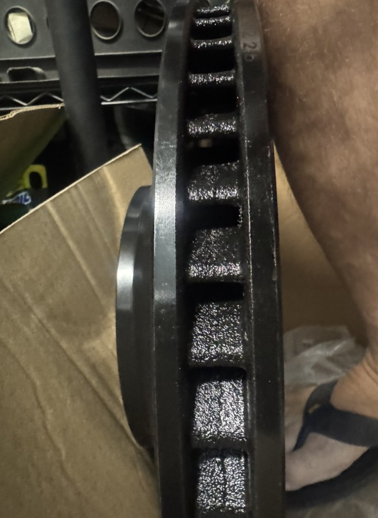

    I'm no scientist & I didn't sleep at whatever hotel that claims to offer a great nights sleep but I figure ginormous rotors and bigger, more piston calipers are better than smaller ones.
    Also, the vanes are directional.

    Well, the vanes are positioned to force the hot air out, towards the wheel. If it's backwards, then the hot is forced to the center of the hub. For everyday driving, not a big deal as far as straight or directional. Now, towing an RV through the mountains, I would venture say it makes a difference. And if you hot rodding it on the highway then I would say, it also helps. Obviously, like he said they are big ass rotors but anything is possible and heating them up isn't impossible. It would also take a lot more abuse than an OEM rotor, but I am just to OCD and would want the direction to be correct, vane wise.
