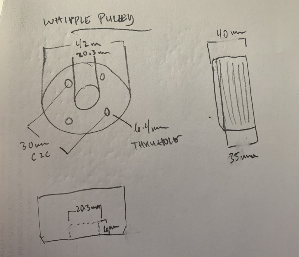

    @snivilous
    Found my calipers. Dimensions in mm even if I scrawled m or mm or wmwmwmmw…

    What material do you want? Carbon reinforced PEEK?
    Or is this just for future reference :D

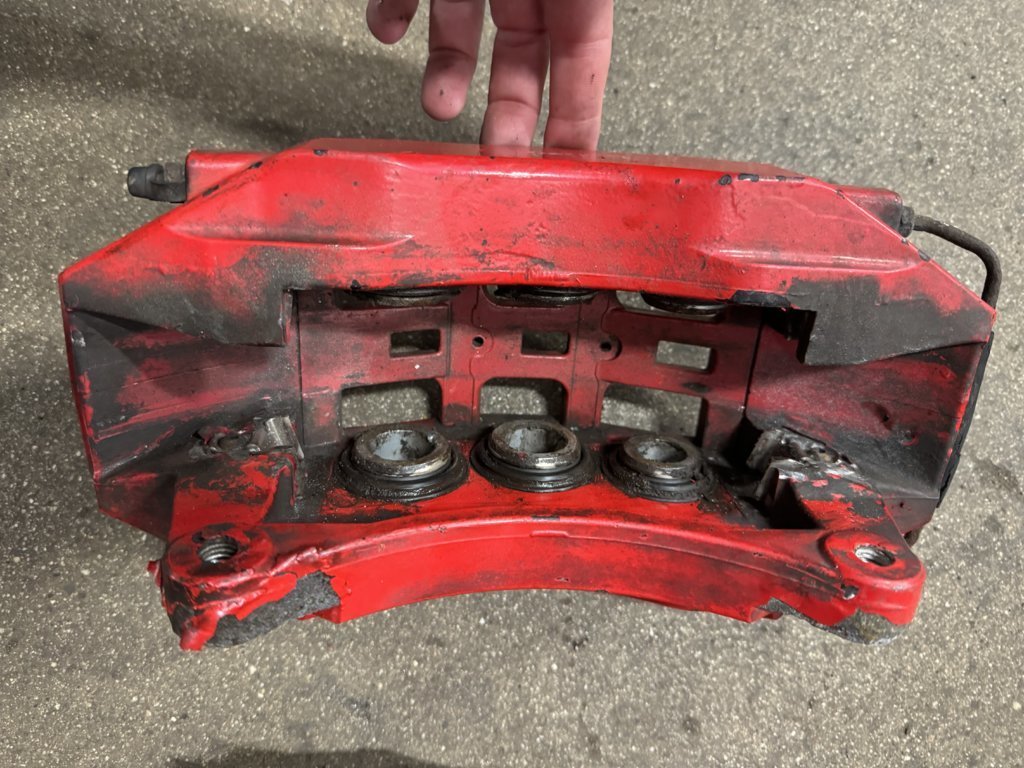

    Responses are coming in on the calipers, bad news so far I have 3 no and one asking for a part number. Good news is I found a company that will rebuild & PC them for me.

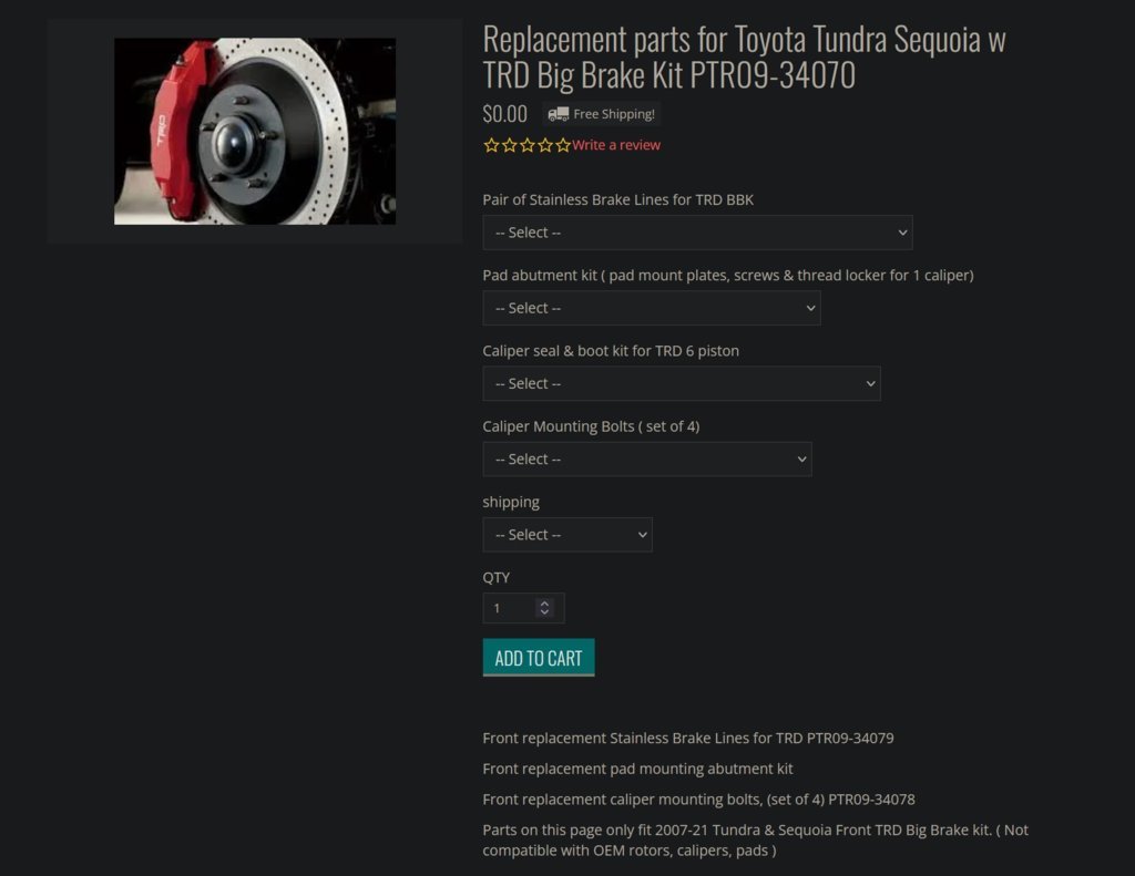

    Have you reached out to SOS Performance? I'm pretty sure the brackets they use on their BBK with the ST-60 calipers will work. I know they carry pads and rotors specifically for the TRD BBK
    https://sosperformance.com/t/2007-2018-TUNDRA

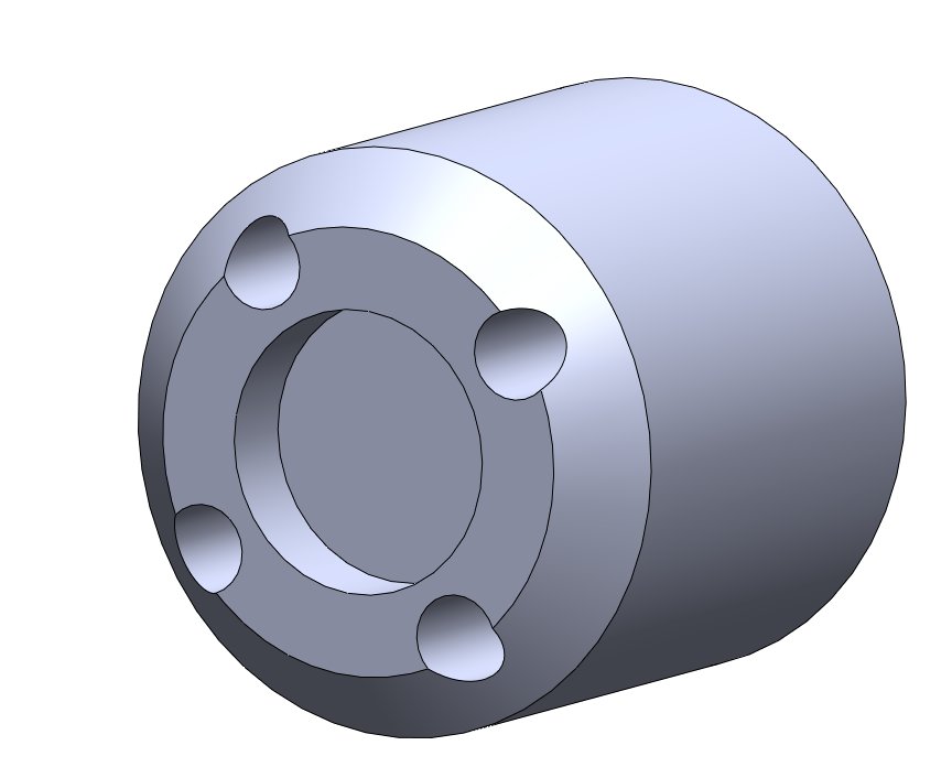

    And since I'm here, here is the model:
    You sure those holes are 6.4mm and there's that chamfer? Cause 45deg cuts into the holes hardcore.

    Thanks, they have all the replacement/rebuild parts but seems not the bracket.
    Also, they have not responded to my message :(

    Wait, are these the TRD Calipers? Don’t they have the bracket cast in as part of the assembly?

    The info I have seen (thought I didn't need brackets) is there are brackets. This is the caliper I'm getting:

    From searching online the actual part number, TRD High Performance Brake Kit PTR09-34070, that no bracket is needed. The mounting point is lower, so the caliper bolts back to the stock location. Here's a video.

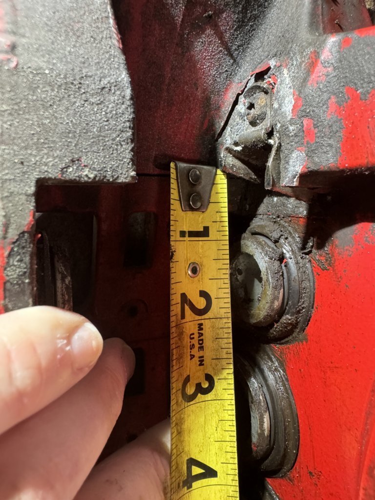

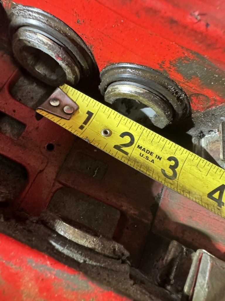

    I keep seeing different info, also, there are several different "TRD" brakes so it's more confusion. To determine which these are I got the piston sizes, seems one is smaller. More confusion. :p

    The regular Stoptech kits have separate radial mount brackets, the Toyota TRD kit has the bracket integrated with the caliper, so you should be good.
    I think my 380 kit has 38/40/42 pistons. The dust seals might have the piston size printed on there.

    While we are asking questions, what are we looking at here? Doesn’t look like a whipple pulley. Is it something else?

    Coupler I believe

    I gotcha, coming up with a new one piece design as opposed to the sleeve style?

    No, it just took all of 45 seconds to draw that and @blenton had posted the dimensions so now I don't have to find them if someone wants me to make a coupler :rofl:
